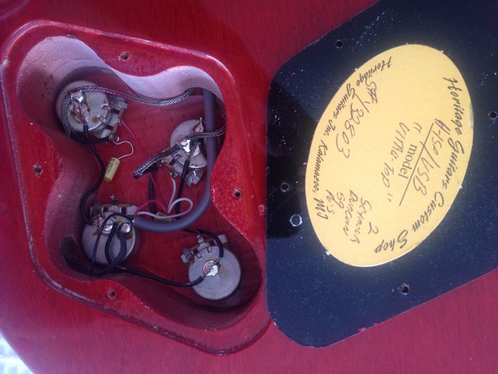

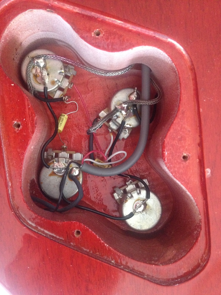

LRS Posted September 18, 2014 Author Posted September 18, 2014 Ok here are some pictures of the internals, looks like it's a 0.0022 uF capacitor in there. Sent from my iPhone using Tapatalk
AP515 Posted September 18, 2014 Posted September 18, 2014 Are you sure you don't have an extra 0 in there? Usually it is a 0.022uF cap. If it truely is 0.0022uF that could be the issue.
LRS Posted September 18, 2014 Author Posted September 18, 2014 0.022 uF it is! Sent from my iPhone using Tapatalk
