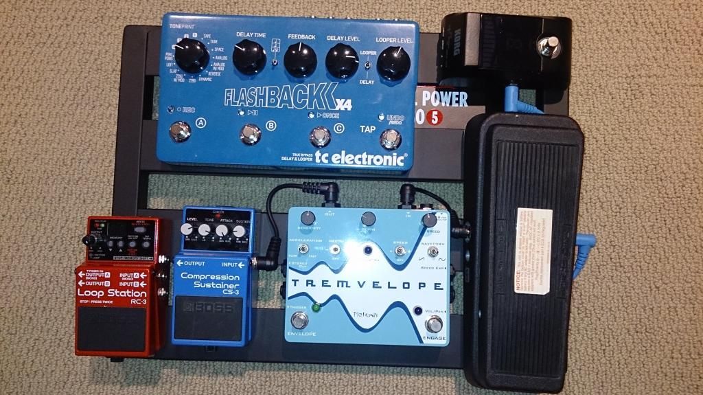

gpuma Posted October 7, 2014 Posted October 7, 2014 New Pedal Board Day! Not cabled yet. Is it better: Guitar ---> Tuner ---> Wah ---> Trem ---> Compressor ---> Delay (I might send this directly in the fx loop) ---> Looper or Guitar ---> Tuner ---> Wah ---> Compressor ---> Trem ---> Delay (I might send this directly in the fx loop) ---> Looper
mars_hall Posted October 7, 2014 Posted October 7, 2014 The second is better. Maybe the Compressor before the Wah or you will amplify noise of the wah
Gianluca Posted October 7, 2014 Posted October 7, 2014 I'd say 2nd is better but Trem in the loop too before the Delay in my config I have Trem->Delay in FX loop
gpuma Posted October 7, 2014 Author Posted October 7, 2014 Yes I am leaning toward the second as well. That way I can have the trem in stereo too, if I want.
DetroitBlues Posted October 7, 2014 Posted October 7, 2014 I agree the 2nd option is best. Oh, and do you use the looper live? I've thought about using one for when I solo, so I have a rhythm track.
gpuma Posted October 7, 2014 Author Posted October 7, 2014 I agree the 2nd option is best. Oh, and do you use the looper live? I've thought about using one for when I solo, so I have a rhythm track. At the moment I am not going to use the looper live, but I think I want to try it.

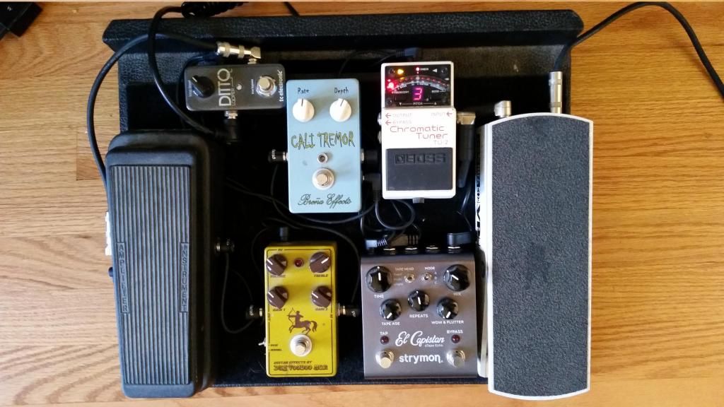

kidsmoke Posted October 9, 2014 Posted October 9, 2014 my current path (no pun intended) VP (use tuner out, keeping it out of the signal path)>Capistan>trem>Klone>Wah>Loop> amp driven by a one spot (that'd be 6 pedals)
gpuma Posted October 10, 2014 Author Posted October 10, 2014 Kip, you've got a strange set up here. how did you come up with this sequence? Normally you would have guitar-wha-fuzz-modulation...
kidsmoke Posted October 10, 2014 Posted October 10, 2014 Kip, you've got a strange set up here. how did you come up with this sequence? Normally you would have guitar-wha-fuzz-modulation... why? http://nelscline.com/tech-talk
gpuma Posted October 10, 2014 Author Posted October 10, 2014 I am not sure at all that the numbers follow the sequence. In fact I am pretty sure they don't. If you look closely except for the dejavibe early in the chain he has a config similar to what I would expect. Have you ever tried running you board in reverse (except for the loop of course)?
kidsmoke Posted October 10, 2014 Posted October 10, 2014 Really don't want the noise of the wah kicked up through all the other pedals
bobmeyrick Posted October 10, 2014 Posted October 10, 2014 Kip, you've got a strange set up here. how did you come up with this sequence? Normally you would have guitar-wha-fuzz-modulation... Agreed. why? http://nelscline.com/tech-talk Most people would (I suspect) prefer the sound of echoed distortion or echoed tremolo to distorted echo or distorted tremolo. Think of it this way - if you were playing with an overdriven amp in a large echoey room, the sound you get would be echoed distortion, so perhaps that's what sounds more "natural"... I know that I prefer the sound of distorted wah to wah'd distortion. But if you prefer your set up, that's fine too.
rockabilly69 Posted October 14, 2014 Posted October 14, 2014 Two sounds more sensible! Let the compressor feed the trem a more balanced input.
