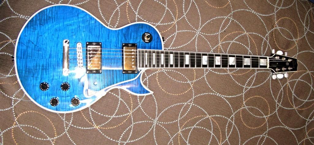

slider313 Posted October 16, 2014 Posted October 16, 2014 Congrats on your new H147. It looks so much better with the chrome/silver hardware. I did the same thing to my blue 147. The gold really clashed with the blue finish!

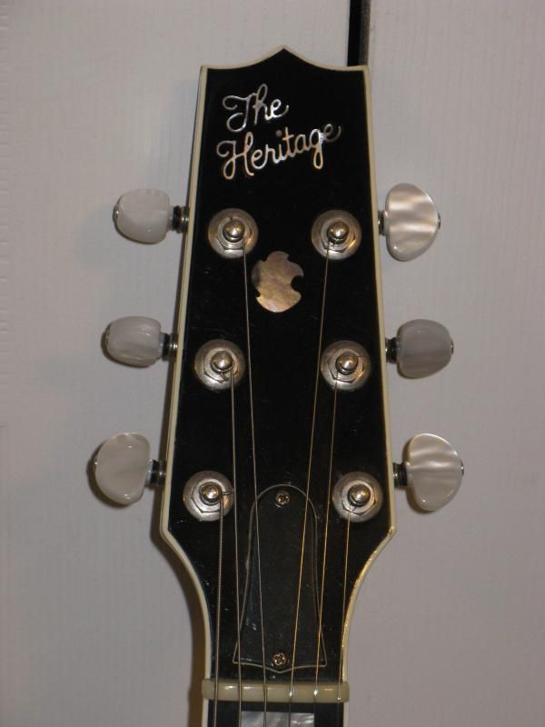

slider313 Posted October 16, 2014 Posted October 16, 2014 I recently found a set of faux pearl buttons that fit the Grover tuning machines. I made the swap a couple of weeks ago.
slider313 Posted October 16, 2014 Posted October 16, 2014 Nice, goes well with bound headstock pearl logo, "crest" and pearl block inlay...............

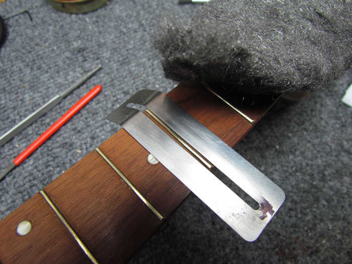

slider313 Posted October 17, 2014 Posted October 17, 2014 Cool. A little "tip"; It looks like your frets have some oxidation (maybe it's the photo) and could use a polish. Get some 0000 steel wool and a fret guide. The difference in playability after they're polished is amazing.
rockabilly69 Posted October 17, 2014 Posted October 17, 2014 Cool. A little "tip"; It looks like your frets have some oxidation (maybe it's the photo) and could use a polish. Get some 0000 steel wool and a fret guide. The difference in playability after they're polished is amazing. My favorite tool in the box as I hate dragging frets! I then use rubbing compound on the frets after the steel wool. SMOOTH!!!
