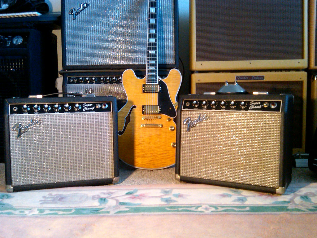

Gitfiddler Posted October 21, 2014 Posted October 21, 2014 I really enjoy small, (old or new) tube amps. Nothing sounds quite like a raging little over-achieving tube amp. All of the harmonics, distortion, natural compression and just plain sweet tones that come from one of these little beasties is great for at-home fun. However, I've noticed that no two amps sound the same or even have the same volume level. More specifically, I've compared two reissue Gibson Les Paul GA5 amps with each other; two Fender Rivera-era Champ II's and two Super Champs of the same vintage. While each of them sounded great, no two have the same volume. Swapping output tubes (Original GE's, n.o.s. Electro Harmonix or new JJ's) back and forth made little or no difference in volume. Preamp tubes made more of a difference in tone and break-up, but did not affect volume. Swapping speakers did make a difference in volume, but not so much in some of them. The GA5's have identical Weber speakers that sound different from one another. And the Champs original speakers all sounded different. Dropping in a Ragin Cajun (thanks, Yoslate) woke up one of my Super Champs, but it was already the louder of the two. Even after replacing the other SC's original speaker with an Emi Legend (75 watts!), the volume was still less than its brother's. With louder, more powerful amps, the sonic differences are more difficult to tell (at least to these old ears), but small amps tend to be more telling of what's really going on inside of their chassis...good or bad. What do you guys recommend to increase volume of a tube amp?

Gitfiddler Posted October 22, 2014 Author Posted October 22, 2014 I already installed a Ragin Cajun in one of the Super Champs and it sounds GREAT. For variety, I installed an Eminence Legend in the second Super Champ. Volume did increase in both amps, but the second amp still has considerably less volume than the other. Also, I've connected them to extension speakers, making them loud enough to gig a medium sized room with! Amazing little amps. My question for you 'amp whisperers' ...Is there another internal component that can increase amp volume? Also, is less volume an indication that the amp needs a cap job, tube re biasing or something else?
slider313 Posted October 22, 2014 Posted October 22, 2014 My question for you 'amp whisperers' ...Is there another internal component that can increase amp volume? Also, is less volume an indication that the amp needs a cap job, tube re biasing or something else? Yes, a new set of transformers or sometimes just a slightly larger output transformer. Less volume could be a number of things. Most components in older amps were + or - either 10% or 20%. After years of use there's also component drift. That's one reason one amp of the same model sounds different or better than another. Another thing that would cause less volume from two amps of the same model; plate voltage. That plus or minus 10% to 20% also applies to transformers. Some time ago I had picked up a '64 Deluxe Reverb in excellent condition. My intention was to tune it up and sell my '65, which is in very good condition. My '65 had more volume, punch and sparkle. I crossed each over the others speaker with no change. Then I took some voltage readings; the '64 had 410v on the plates @ 20ma and the '65 had 435v on the plates @ the same 20ma. More voltage equals more punch and clean headroom. That's the main difference between the Vibrolux and Pro Reverb amps; other than the speaker size. The Vibrolux run those 6L6's at 410v where the Pro run them in the 440v range. They have the same output transformer but a different power transformer.

Gitfiddler Posted October 22, 2014 Author Posted October 22, 2014 Jeff~ Thank you for your usual expert comments!! I knew there had to be something going on within the innards of these old amps. I never realized that there could be a possible 10% to 20% variance on internal component (transformers, etc.) efficiencies. Plus, as you stated, the age of these things is a performance factor...kinda like us!
