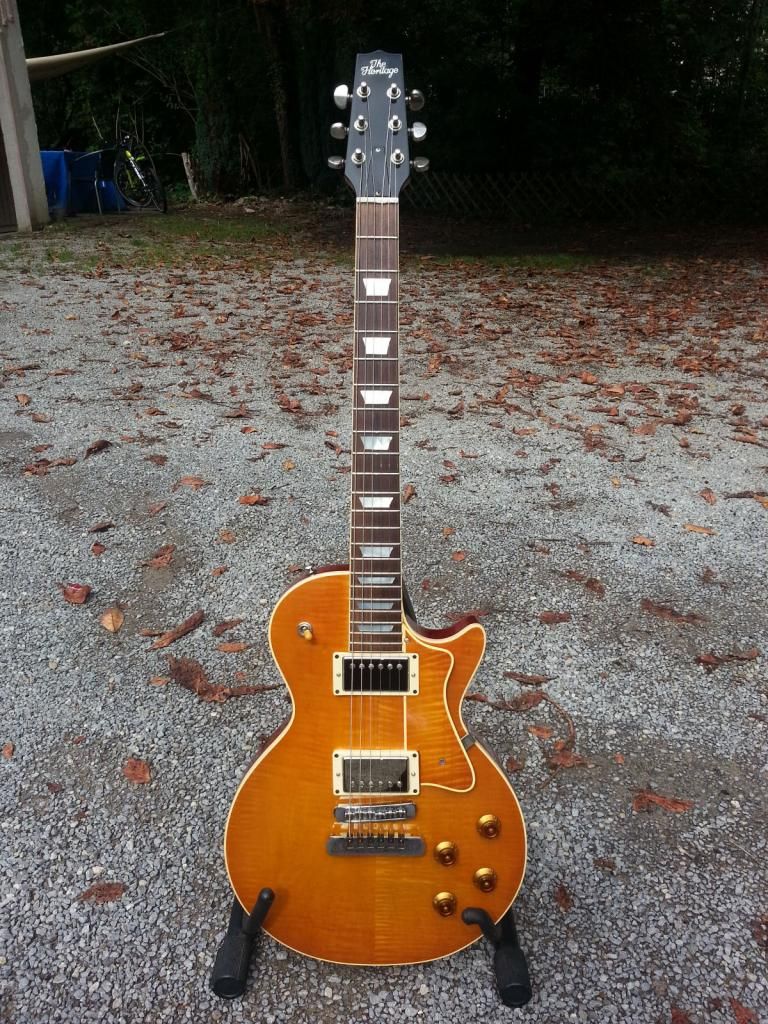

Hello, dear fellow Heritage fans! Just wanted to introduce myself properly with pics and all (sorry for the long post that follows).
I'm Dmitry, I live in Germany and have primarily played small luthier made Teles (which some would call boutique) for the last coupla years. I have always been drawn to the looks and the tone of the LP, but never really could bond with the finish, feel and the scale when actually playing them. I gave it some tries - Gibson, Tokai, FGN and so on. I had a higher end Tokai for about a year, and while it sounded great, I didn't feel at home with it. In the end I settled for just beeing a Tele guy...
Well, until two weeks ago, when I saw a beautiful used H150 on german EBay. The price was right, and I have read some good things about it lately, so I thought "let's give the mahog single cut another try, shall we"? Last week it arrived, and it may well be the long sought solution to the LP GAS. It's a great sounding, top-built LP-style with a comfy rather round neck that just felt right out of the box. And TONS of mojo...
Now, before going into details, I'll let the pics do some talking:
Facts that I have from the description and a brief conversation with Ren (who was absolutely great and fast in his response to my inquiry, thx a lot!!!)
Serial: J22605 (which makes it a fifth guitar made on the 05-19-1993.)
Model: H150
Pickups should be SD according to Ren (it says "Patent Pending" on the back of the PU)
Grover Heads
Schaller Bridge (whcih I find surprisingly like very much, even though it's not the classic LP style)

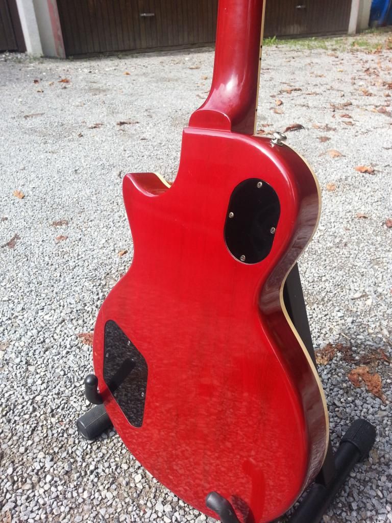

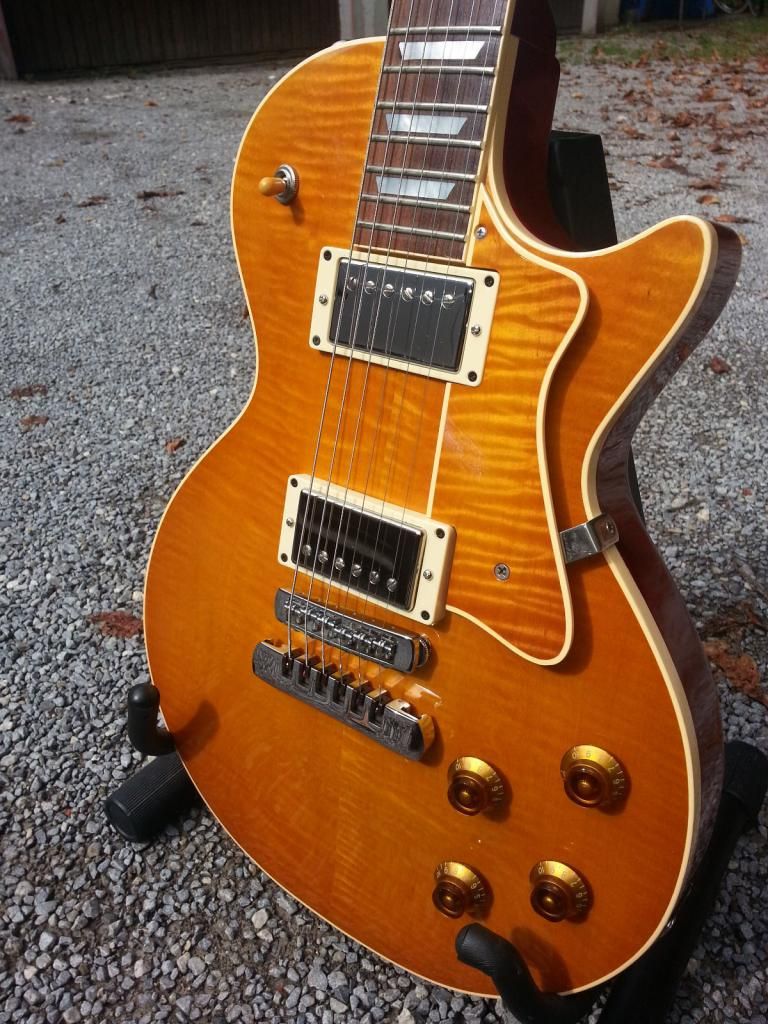

Pickups are not Seymour Duncans, only Gibson has that sticker on them like that. Have you removed the control cover to see a sticker on the backside? Usually the color is listed there. My guess is VSB (Vintage Sun-Burst). You'll also be able to identify the Pots being 500k (usually).
Heritage doesn't do vaneers... Proof for you is to look inside the rim of the pickup cavity and you should be able to see the flame of the top all the way through the maple.
Largest difference between 1993 and today would be Tone Pros hardware instead of Schaller and the pickups are no longer Schaller. The pickup rings back then usually have two height adjustment holes on either side of the pickup. Your H150 most likely came with Schaller pickups 1993, again typical of the time, not Seymour Duncan 59's commonly installed today. Since the rings are newer, I suspect you've had some electronics modifications.
For me, the majority of the early Heritages until recent years are much thinner necks. C shape or D shape varies since they are done by hand.
Hope this helps

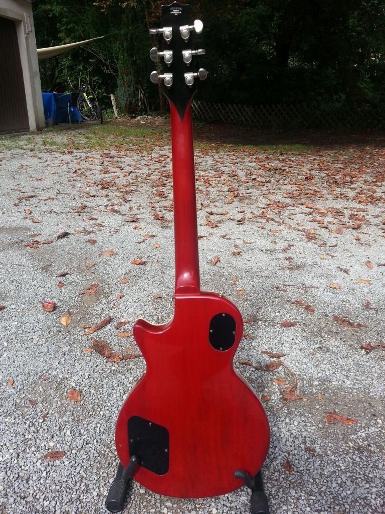

Guten abend. Thats about it for my Germen language skills. Take off the control cavity cover and there should be a tag with the specifications of that guitar. The top is solid maple. I see that guitar has the very desirable stinger on the back of the headstock. The model name on the tag in the control cavity will probably be 150CM meaning 150 Curly Maple. Mor e knowledgeable people than me will soon add better information. Fab 150CM.

The problem is, there is no sticker on the backside of either back cavity cover. So, no official colour and no model name the easy way :).
There also seems to have been an electronics change of some kind, since in the mid position (both hums on) killing either humbucker means killing both - which doesn't seem a standard wiring to me.
True, the "patent pending" sticker should have told me it's a Gibson PU right away... It does sound the part, so now I should find out, which one that is.

but I would say Duncan 59's for the pickups, that was standard on the H150CM and the single screw on each side is the clue there. Schallers usually had the double screws each side.

I've unscrewed the pickups yesterday. The PUs say "Patent applied for" on the back, that's it, no more markings. So, that probably really makes them Gibson PUs, right?

That's normal..happens on all my Heritages or Gibsons for that matter. Very nice find, I like the wood guard, most have plastic. The Schaller bridge is a solid piece of hardware. Some swap them out and some like them. The roller wheels can turn when you change strings etc. Once you get your desired spacing (spinning the wheels changes the string position) , if you want to, you can put some clear nail polish on the threads to keep them stationary.

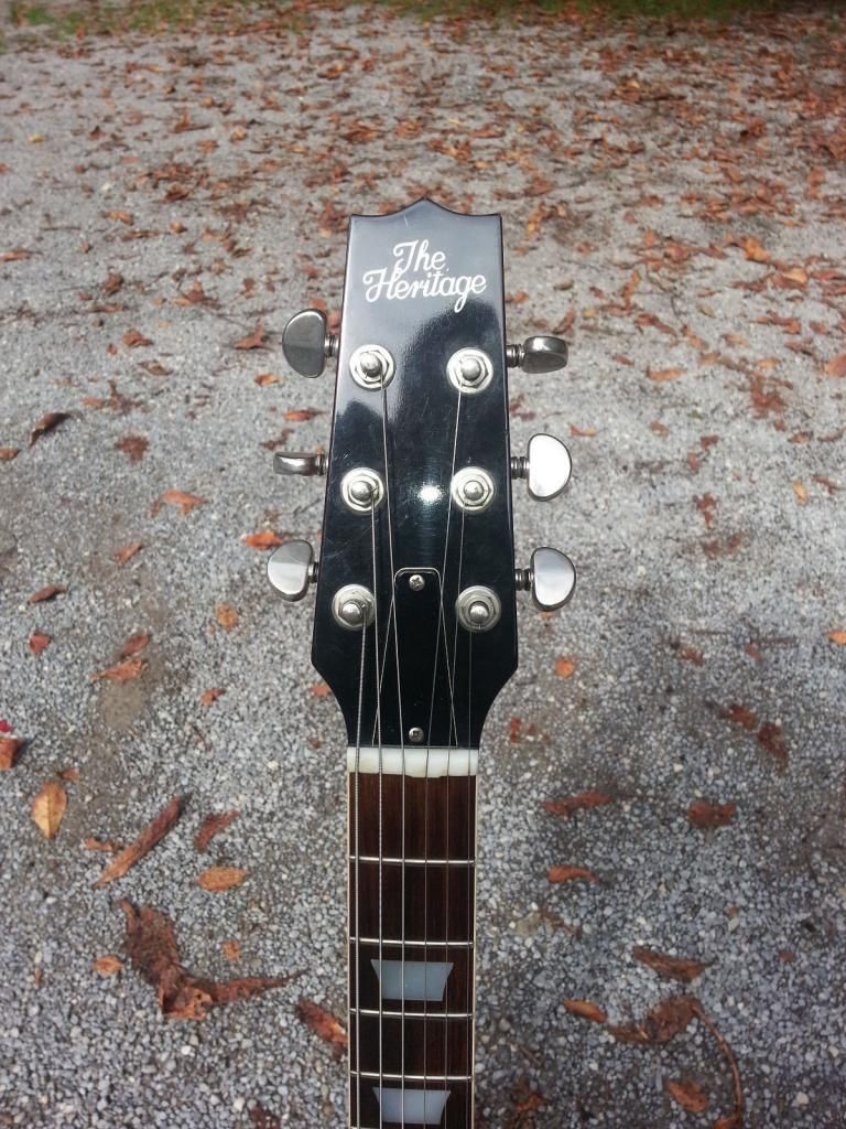

Welcome, Dmitry! Your pickups are likely to be Gibson Burstbuckers. The stinger (or widow's peak) is a cosmetic touch which used to be found on higher end Gibsons, usually archtops, like the Super 400, ES-5, and the Tal Farlow. Heritage seems to have done it as a special touch on some of their higher end archtops, special order guitars, and special runs, such as Twentieth Anniversary 150's. Yours also seems to have a compensated nut, if I'm seeing the picture clearly. Very nice guitar!
Yes, a compensated nut it is.
