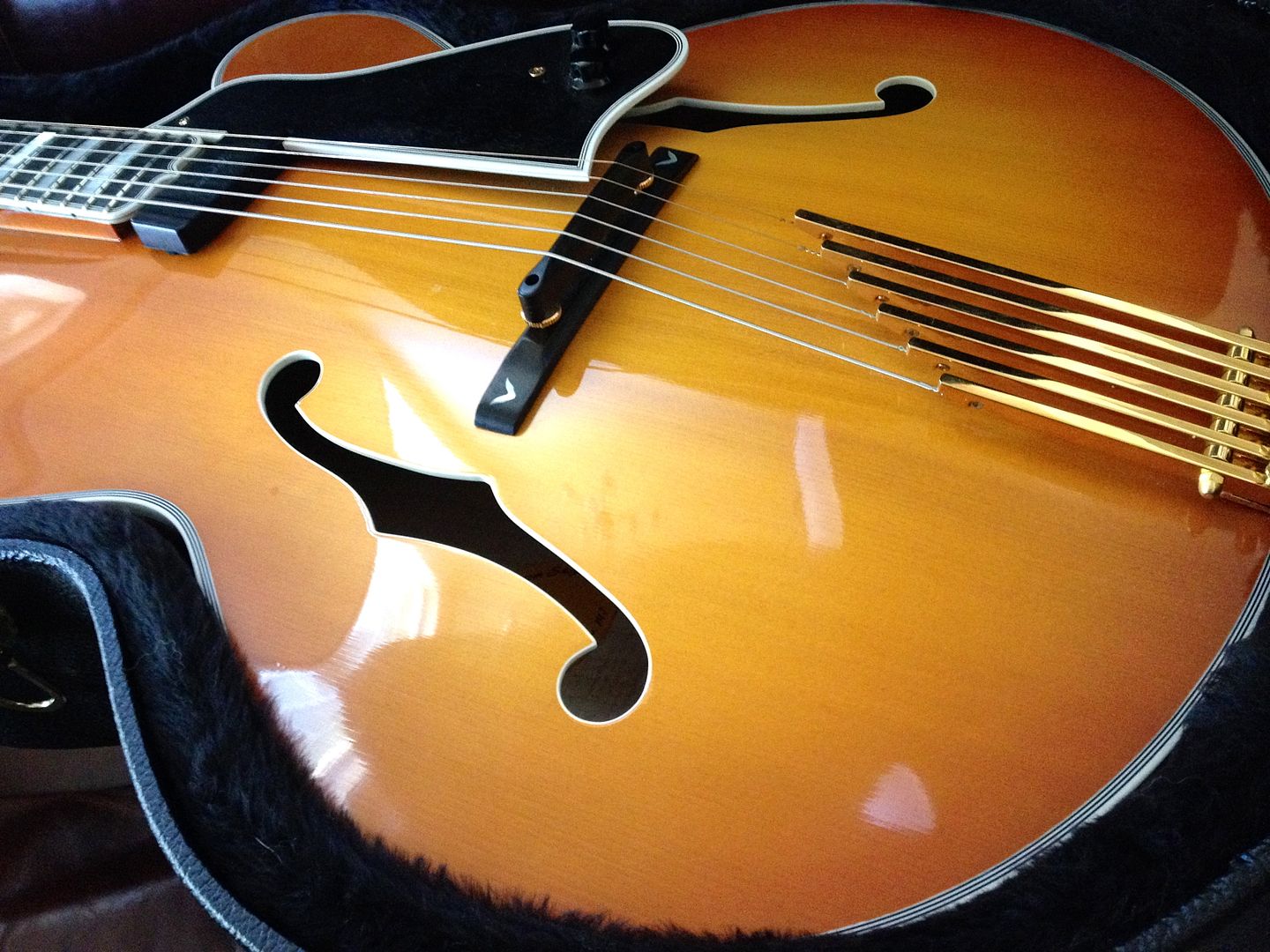

ironmike Posted November 23, 2014 Posted November 23, 2014 any of you use the six finger tailpiece with individual pressure adjustments? make a difference?
MartyGrass Posted November 23, 2014 Posted November 23, 2014 The six finger TP does make a difference but maybe not enough to matter. It depends. 1. It changes the break angle, reducing it the tighter you clamp down the TP fingers. The reduces string slippage over the saddle. If you bend your strings, you will have less of an effective string length to bend them. The strings will seem stiffer. 2. This tightness will also make it slightly harder to fret the strings. It will require a little more pressure to depress the string to the fret. These two effects are not noticeable to most players. #1 is more easily recognizable to blues players. 3. The downward string pressure on the bridge increases the transmission of string vibration to the top. That is more easily noticeable, especially when playing acoustically. Most archtop tailpieces are not adjustable and they are lighter in weight. They meet the needs of all but a few. I wouldn't sweat it.
Gitfiddler Posted November 23, 2014 Posted November 23, 2014 The six finger TP does make a difference but maybe not enough to matter. It depends. 1. It changes the break angle, reducing it the tighter you clamp down the TP fingers. The reduces string slippage over the saddle. If you bend your strings, you will have less of an effective string length to bend them. The strings will seem stiffer. 2. This tightness will also make it slightly harder to fret the strings. It will require a little more pressure to depress the string to the fret. These two effects are not noticeable to most players. #1 is more easily recognizable to blues players. 3. The downward string pressure on the bridge increases the transmission of string vibration to the top. That is more easily noticeable, especially when playing acoustically. Most archtop tailpieces are not adjustable and they are lighter in weight. They meet the needs of all but a few. I wouldn't sweat it. Marty hit the nail on the head with his description. I'd like to respectfully add one more... #4. It looks very sexy on an archtop!!
2bornot2bop Posted November 23, 2014 Posted November 23, 2014 The first finger TP archtop I owned I found it a new novelty. That caused my curiosity to fiddle with adjustments for several weeks. The 2nd finger TP archtop I owned, I left it alone. I pref'd leaving it alone. I do like the look of it.
jimsoloway Posted November 23, 2014 Posted November 23, 2014 Marty hit the nail on the head with his description. I'd like to respectfully add one more... #4. It looks very sexy on an archtop!! But does add weight and expense.
davesultra Posted November 23, 2014 Posted November 23, 2014 I had a Gibson Howard Roberts Fusion with the fingers tail on it. It didn't impress me besides the fact that it looked cool.
ironmike Posted November 23, 2014 Author Posted November 23, 2014 ever notice how some are staggered in the opposite direction? longer treble strings to shorter bass strings and some longer bass strings to shorter treble strings.i always thought that the string length between bridges and tail pieces should be 1/6 of the overall string length, surprised nobody picked up on that in their design.
MartyGrass Posted November 23, 2014 Posted November 23, 2014 The string length from bridge to TP generates a lot of discussion, most of it just hot air IMO. This discussion is highly matured in violin construction. There is a concern that these string fragments can resonate and change the sound of the guitar. It's a stronger argument if the instrument is not amplified. But high pitched harmonics on these are of very low amplitude and energy. Some like the heavier strings to be longer because it decreases the work to fret them. Some like the lighter strings to be longer for bends. Here's an old Frequensator TP that's reverse built.
