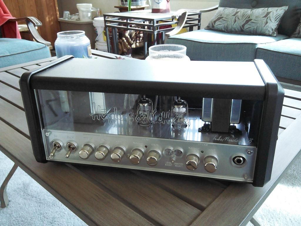

Millennium Maestro Posted November 27, 2014 Posted November 27, 2014 I think you may be approaching this from the wrong angle, Sound proofing is an expensive route with limited results. A good "dual purpose" amp would be a H&K Tubemeister 18 Lunch box sized(will get you pic), not only can you step it down from 18 to 5 to 1 watt but it has a built in load so it can be played silent where you can use a direct out and monitor with headphones!!! This approach would allow you to run into a cheap 4 channel mixer, use a drum machine, mp3 player etc. and working in relative acoustic silence. When you can make noise, fire it up and rock your world! Head, mixer and headphones are your only expenses! You can get an external cabinet for the amplified situations!

JMick Posted November 27, 2014 Author Posted November 27, 2014 On 11/27/2014 at 6:34 PM, Millennium Maestro said: I think you may be approaching this from the wrong angle, Sound proofing is an expensive route with limited results. A good "dual purpose" amp would be a H&K Tubemeister 18 Lunch box sized(will get you pic), not only can you step it down from 18 to 5 to 1 watt but it has a built in load so it can be played silent where you can use a direct out and monitor with headphones!!! This approach would allow you to run into a cheap 4 channel mixer, use a drum machine, mp3 player etc. and working in relative acoustic silence. When you can make noise, fire it up and rock your world! Head, mixer and headphones are your only expenses! You can get an external cabinet for the amplified situations! Thanks, I'll look into that Tubemeister...
