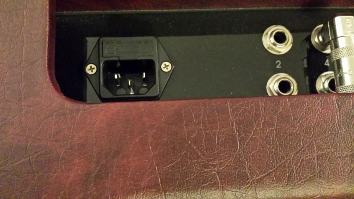

Gitfiddler Posted December 6, 2014 Posted December 6, 2014 Clicked on the standby switch on the Heritage Patriot this evening and left the room to let her warm up a bit. I came back and the power light was not lit. Hmmm. Switched the power on...but nothing. Swapped out the power cord. Nothing. It could be a blown rectifier or power tube, but need to replace the fuse first. Went to check the 3 amp fuse encased adjacent to the power cord...Can't access it. Arrghh! How do you get to the fuse on these amps??

brentrocks Posted December 6, 2014 Posted December 6, 2014 there is a clip inside the power cord receptacle. I remember doing this on my Colonial you may have to take off the back cover, but shouldn't have to pull the chassis
Steiner Posted December 6, 2014 Posted December 6, 2014 Good thing you didn't let the smoke out. The fuse is directly above the power cord plug. You have a really good shot of it in your first photograph. Heritage amps are built like tanks. I'd lay money on it being either fuse or rectumfrier.

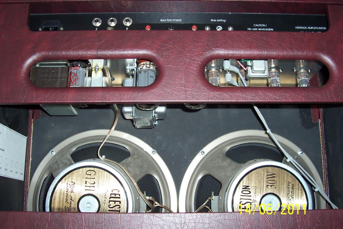

MartyGrass Posted December 6, 2014 Posted December 6, 2014 You must have a different version of The Patriot. Here's some shots of my amp's private parts.
Gitfiddler Posted December 6, 2014 Author Posted December 6, 2014 there is a clip inside the power cord receptacle. I remember doing this on my Colonial you may have to take off the back cover, but shouldn't have to pull the chassis I don't want to risk breaking the tiny plastic fuse access door on the power cord receptacle. How did you get to the fuse? Did you unscrew the entire power cord housing? Dumb question, but don't want to snap off the plastic piece. Heritage Patriot Fuse.jpeg

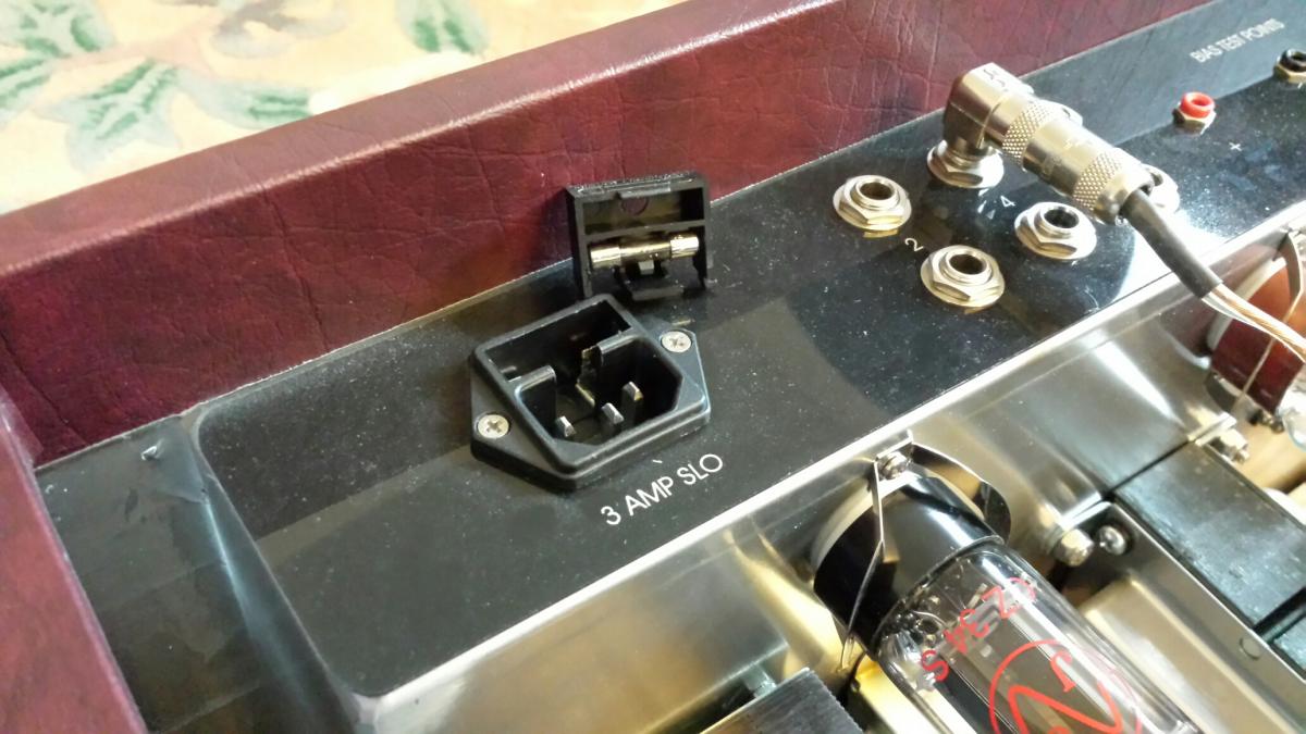

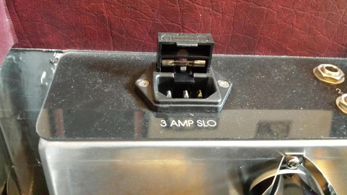

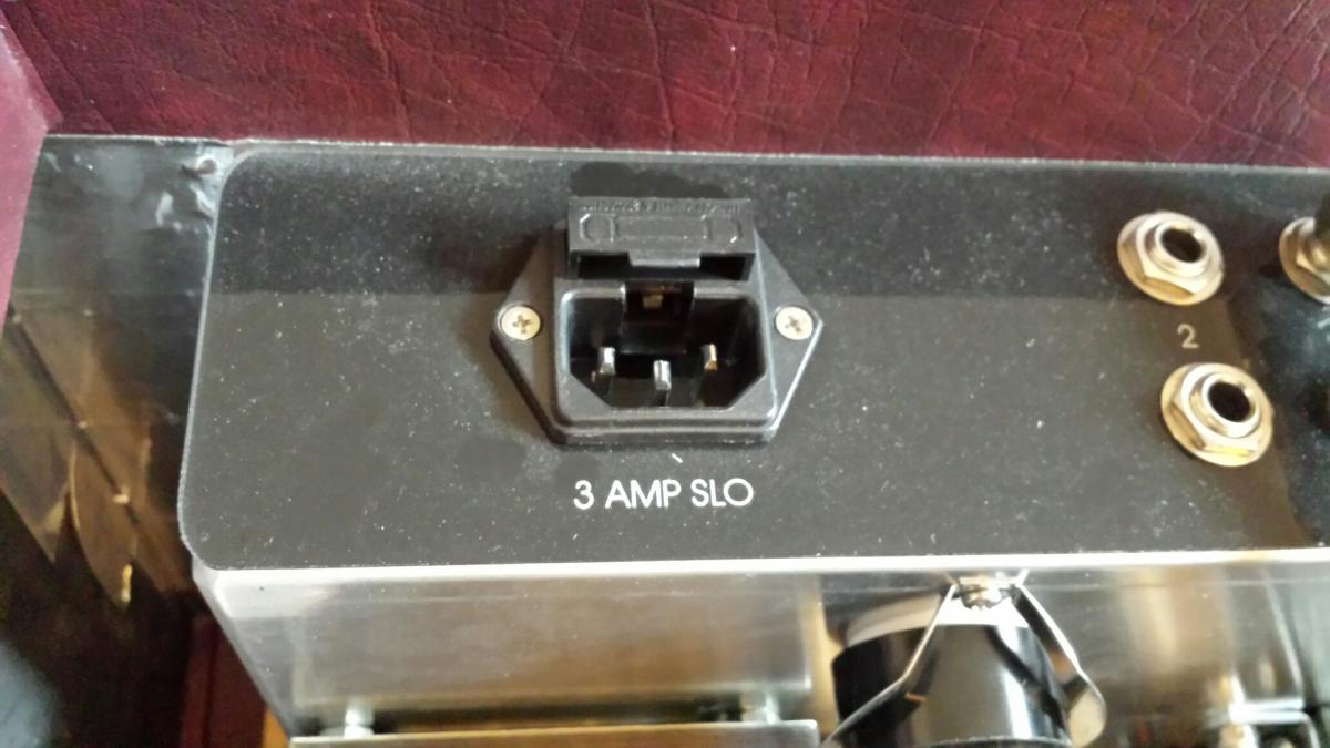

Gitfiddler Posted December 7, 2014 Author Posted December 7, 2014 "IT'S ALIVE!!" This turned out to be relatively easy, pain free, and ONLY a blown fuse issue! It took 4 steps. I removed the back of the amp, then CAREFULLY slipped a tiny screwdriver under the lip of the fuse cover. After a trip to the local Radio Shack for 2 packages of 3 amp SloBlo fuses, the deed was done!! It sounds GREAT again!! Step #1: Step #2 Step #3 Step #4
