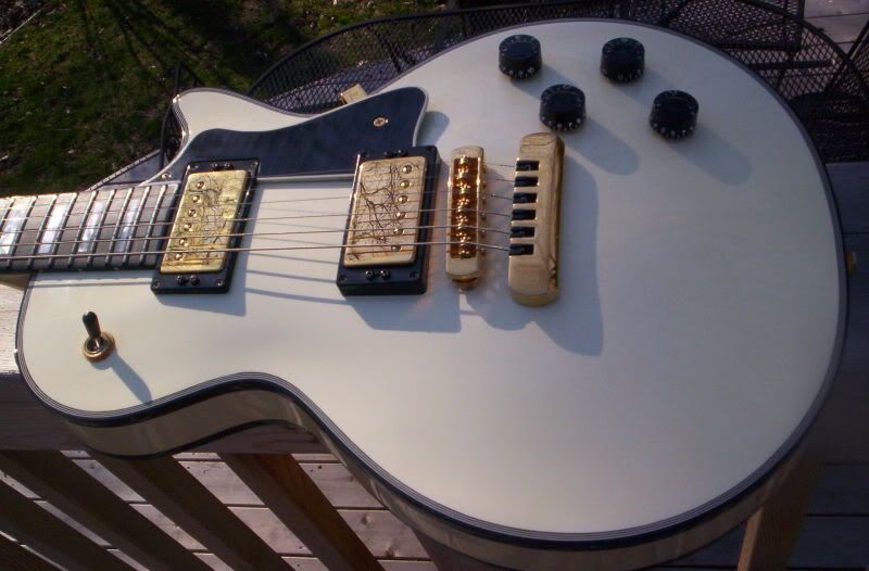

darkphader Posted January 12, 2015 Posted January 12, 2015 Hello, New to club and new to Heritage. Recently picked up a used 1997 H-150 equipped with the Schaller roller bridge system and wish to replace it with the Faber Tone-Lock Master Kit. The Faber Master Kit comes in both imperial and metric variations. Most of the information I find seems to indicate that the metric kit is the proper choice, however, someone at Heritage (during a phone call this morning) said the imperial (or standard) version was the proper one, although granted he didn't really sound convinced. In case this helps, measuring the tailpiece studs with a micrometer gives me a thread width of 0.308"/7.83mm and a root width of 0.290"/7.35mm. So which is it? Metric? Or imperial (standard, inch SAE, etc.)? Also one of the tailpiece bushings seems to be set too high in the body (see photo) and I suspect that the Faber tailpiece spacers will not seat properly. Can I just knock the bushing in further with no repercussions? Thanks all, Chris

darkphader Posted January 13, 2015 Author Posted January 13, 2015 From what I gather from Faber is that only difference between the two Tone-Lock Master Kits - metric and imperial is the tailpiece studs, every other component is identical. It appears I could order the metric kit and get new metric tailpiece bushings as well. They are just a hair larger than the imperial ones and should just knock right in, maybe even be a better fit as the one on the bass side may get a bit loose if I attempt to raise it. @kidsmoke, here's the rest of the guitar (it's a bit rough but looks good from a distance):

darkphader Posted January 24, 2015 Author Posted January 24, 2015 Nice. I guess that was the standard - with the black binding.
darkphader Posted January 26, 2015 Author Posted January 26, 2015 why change the rollers? Just going for a more standard look. It's less of a functional reason than it is a cosmetic one.
ironmike Posted January 26, 2015 Posted January 26, 2015 oh, i have the german roller set up and it's bitching!, i play 12 guage and bend the shit out of my strings, no problems at all..but, looks is looks!
darkphader Posted February 14, 2015 Author Posted February 14, 2015 Conversion complete (Faber Tone-Lock and BSWKIT installed):
