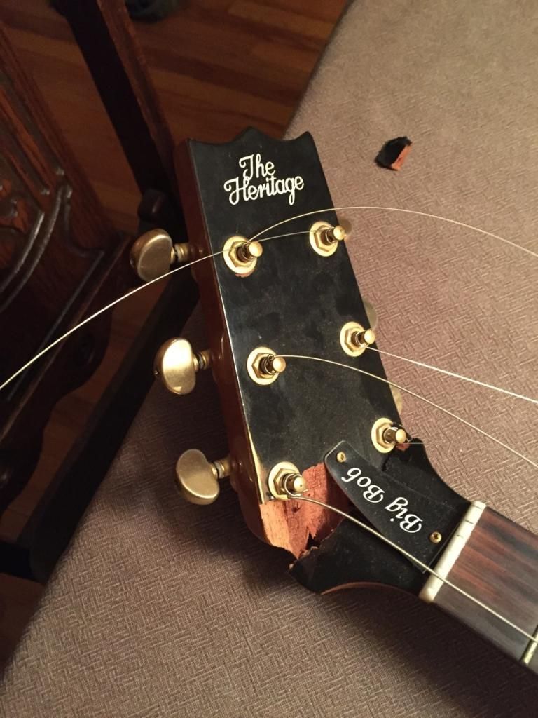

big bob Posted January 14, 2015 Posted January 14, 2015 My good old 575, bought new in 1998 at elderly in Lansing. She got bumped off her stand and landed flat on her face. Hmmmmm. Can't upload pics this morning.
bsck1 Posted January 14, 2015 Posted January 14, 2015 Oh my, that hurts my heart even up here in the freezing cold Midwest winter. I hope it's something that is repairable.
Millennium Maestro Posted January 14, 2015 Posted January 14, 2015 Since BigBob opened the post, here is the aftermath! This ought to get the trhead moving....OUCH, Sorry bout the bad news Lance!
DOGBOY Posted January 14, 2015 Posted January 14, 2015 Oh my, looks like your Southeast Muster/Guitar Show this weekend is good timing. That is a damn shame, because I'm a curious idiot bumped off it's stand by???

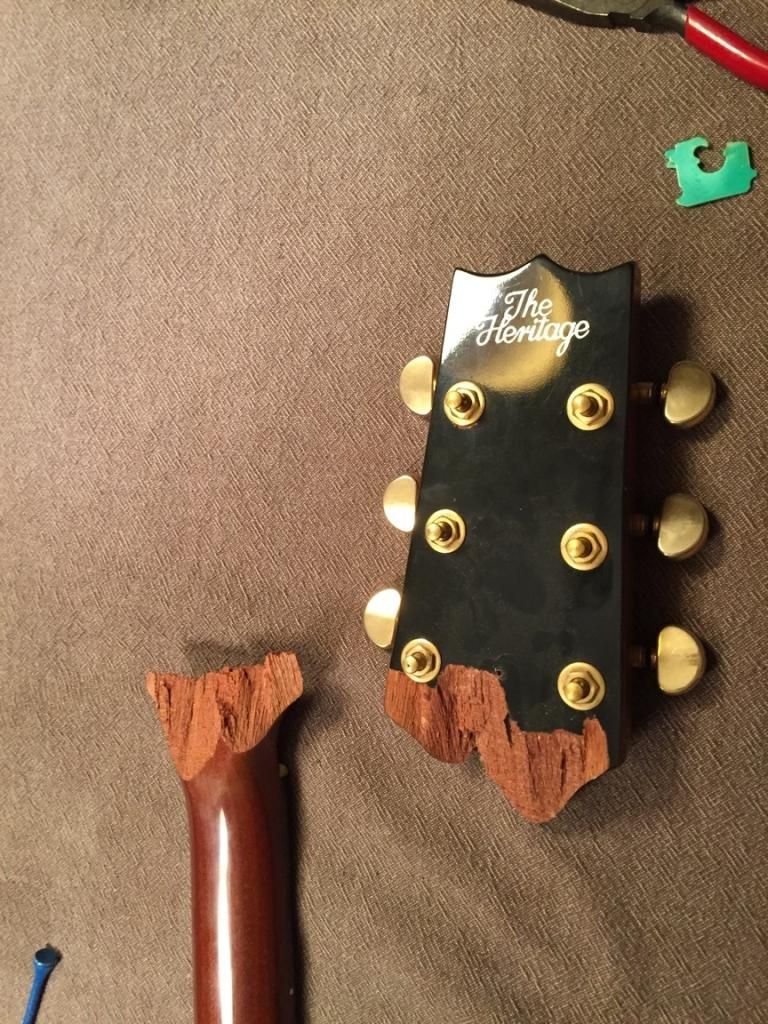

yoslate Posted January 15, 2015 Posted January 15, 2015 Paging Doctor Yoslate to emergency room 3. Sorry to hear it happened. You get that sinking feeling that it's gone, but it can be fixed. The music will flow again! Already weighed in on facebook, Rich. Clean break. Lots of surface area for glue. Not a lot of gnarly wood fiber, Truss rod's not involved. Lots of surface to jig and clamp, without a lot of oppositional slipping and sliding. From here, looks a good candidate for a repair.

bolero Posted January 15, 2015 Posted January 15, 2015 well that sucks! but i agree, IMO as breaks go, that is one of the best...to fix! lots of surface area for the glue to bond to that is also why I never use those 3 legged "accident-waiting-to-happen" guitar stands!! good luck with the fix
big bob Posted January 15, 2015 Author Posted January 15, 2015 My lovely wife was the one who started the tragic chain of events. IT was an accident, so I can't even be angry. I have talked with several luthiers including Pete. Looks like a repair would be tricky as part of the wood shattered into lots of little pieces. The quotes to put a new neck on are close to the price of a repair. I have put a request in with Ren at Heritage to see if they will sell me a neck. Now I wait !

yoslate Posted January 15, 2015 Posted January 15, 2015 ... the wood shattered into lots of little pieces. Oh.... In that case.... Sorry! Hope Ren can help you out, Lance.

big bob Posted January 15, 2015 Author Posted January 15, 2015 Oh.... In that case.... Sorry! Hope Ren can help you out, Lance.It can be fixed, and that is still an option. It Would probably require support stints This is what I know, not official estimates, but a close aproximation. Repair = 250-300 Reneck = 250 + cost of neck Sell as is = 800 And I whole heartedly agree with Barry, the new neck will need some bling!
