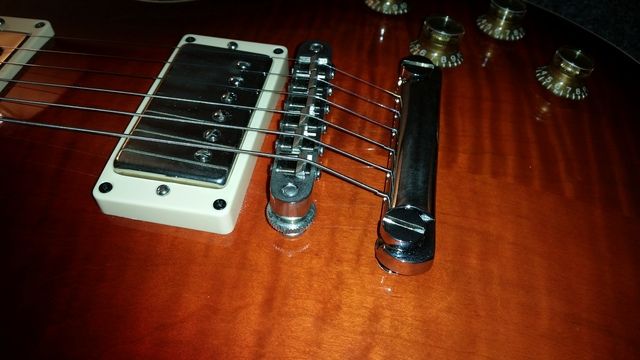

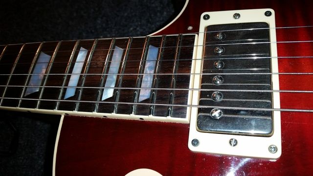

Shoman Posted March 21, 2015 Author Posted March 21, 2015 Everyone gave me so much help and so many suggestions that I wanted to give you an update. I was lucky to find a local who is a luthier. He mostly does work for the shops in this area and does not have a shop other than his home. He loves Heritage guitars. What a great situation. He's spent a bucket load of time with me explaining all the things you all were telling me and he's done a setup/restore that is outright amazing. I took some quick shots of the bridge and tail piece and of the frets that he cleaned polished and brought to a mirror finish. The Fretboard is amazing looking now but haven't taken pics of it yet. I don't think these shots will show how good the frets look or how much better the P/U covers and bridge/tailpiece look but at least you should be able to see some of the difference. I'll have to work on some better pics, but so far it's amazing. I gotta tell you that I can't believe how lucky I am to have found this guy. He's just a great guy. He's spent better than 7 hours just talking with me in the last week and a half. I have no idea how many hours he's spent on the two guitars that I've taken him. According to him he does it because he loves it. He's been a musician for at least 45 years among other things. He's obviously done very well and has been retired since his 50's. He's still playing professionally. Has been on a few hit records in the past and was basically a studio musician, He is amazing with frets and necks, completely cleans and treats the fretboard, does intonation, resets bridge, tailpiece, polishes everything, metal, neck headstock, guitar front, back sides. He's amazing and If I were to tell you the price you wouldn't believe me. He's got a great bass collection. That's what he plays. He's made from start to finish some absolutely greorgous guitars. Next time there, I'll get some pics. He talks about how much he loves wood and working with wood and it's obvious from what he does with it. What an interesting guy. So long story short I feel like I found the treasures of Mel Fisher. I am very much the happy guy/
golferwave Posted March 21, 2015 Posted March 21, 2015 Sounds like all has went well and glad you found a person you can depend upon to help you set up and get the very best out of your axes. Now you'll have to join the GAS club and start looking for your next Heritage!
