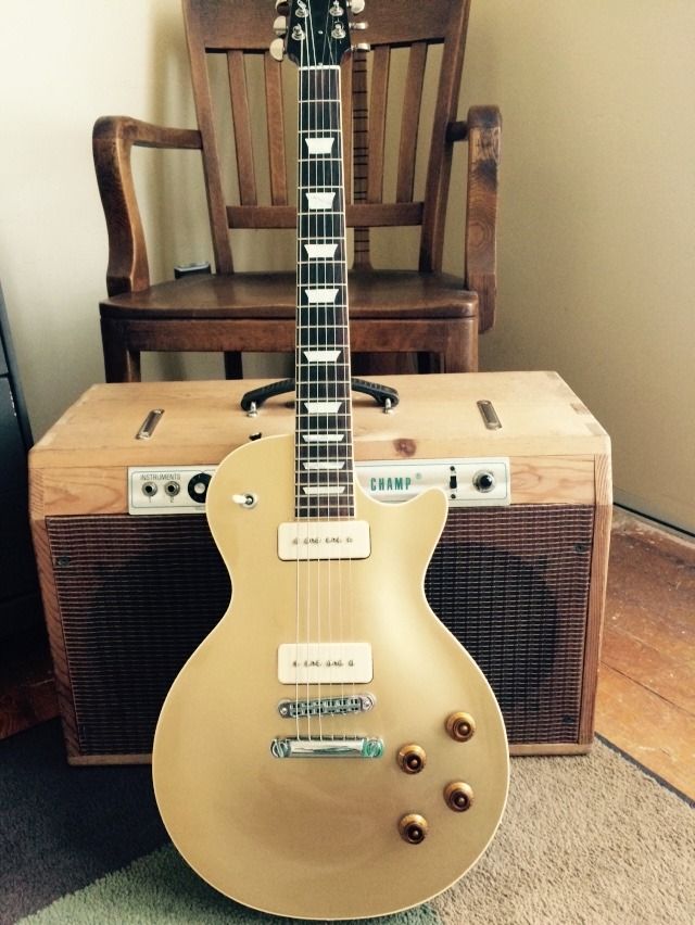

RhoadsScholar Posted June 13, 2015 Posted June 13, 2015 On 6/12/2015 at 5:23 PM, zguitar71 said: My small club combo. No pedals just the cranked up blues sounds. Always thought the p-90s in a 150 through a cranked up champ was a match made in heaven. Good stuff
Gitfiddler Posted June 13, 2015 Posted June 13, 2015 On 6/13/2015 at 6:17 AM, zguitar71 said: Thanks. It has two 10" Eminence legends in it. The cab is all pine (formerly paneling I my old house) including the baffle board. It is also extra deep, 11.5", for a little better low end. The amp screams now and is loud enough to be used unmic'd in small clubs with a drummer that is aware of his volume. Badass little Champ combo you've got there! Are the speakers wired at 4 ohm?
zguitar71 Posted June 15, 2015 Posted June 15, 2015 On 6/13/2015 at 11:45 PM, Gitfiddler said: Badass little Champ combo you've got there! Are the speakers wired at 4 ohm? Yes, they are 8 ohm speakers wired for four. They really brought the db up from the original set up. Now it is loud. I have thought about making a speaker cab with very effecient speakers for bigger clubs. The legends are 97db, a set of speaker in the 102db range would be great.
