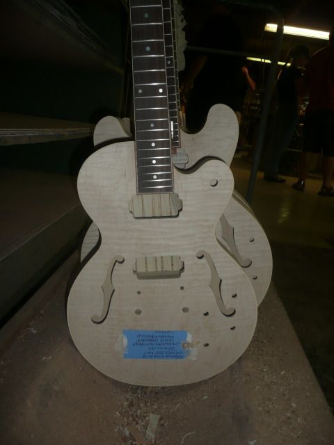

kidsmoke Posted June 30, 2015 Posted June 30, 2015 just for informative purposes: add a top, a back and a neck to this and you have a millie add a laminated top and back, and a neck to these and you have 535/555 this photo gives you a nice size comparison on the two different models. happy hunting
tulk1 Posted July 1, 2015 Posted July 1, 2015 just for informative purposes: add a top, a back and a neck to this and you have a millie add a laminated top and back, and a neck to these and you have 535/555 this photo gives you a nice size comparison on the two different models. happy hunting That should be a sticky.
