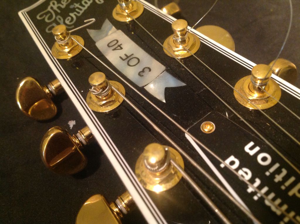

buzzy Posted September 8, 2015 Posted September 8, 2015 I'm a two or three wrap kind of guy. I also lock the loose end under the first wrap. I do get some stretch and it could be related to the number of wraps. I've seen folks that only wrap once and I have guitars with locking tuners that require 1/2 wrap. All good - give it a try. I can't help with the chrome/nickel issue. I've ground out some nasty pitting on a nickel tailpiece with OK results; but, that's on a guitar with huge sentimental value that I'll never sell. Oh, excuse the dirty headstock. I play guitar as well as collect them.
Vanschoyck Posted September 8, 2015 Posted September 8, 2015 I try to get 3 wraps and I don't do any fancy looping, just one wrap over the top and the other two below. I have a hell of a time with nylon strings! Great looking 575.
