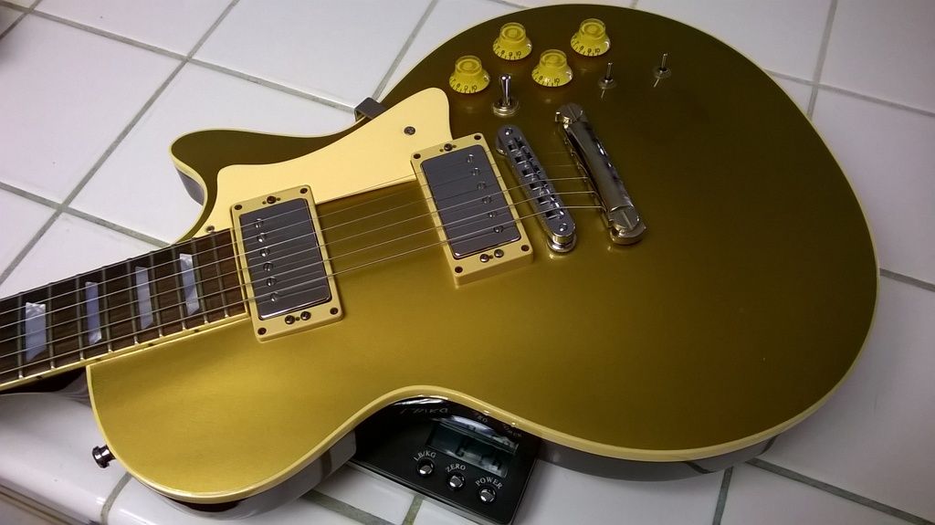

Millennium Maestro Posted January 25, 2016 Posted January 25, 2016 The edge of a LP hits me in the ribs, so I'd at least have to hit it with a cornering tool or cabinet scraper I think. You definitely want a H-140, I am not even going to bait you with a NEW slim 157 I have with Mini Hum Rio Grandes. This attached photo is a Slim Goldtop 150 with VIP wiring, Weight of 8lb 2 Oz
