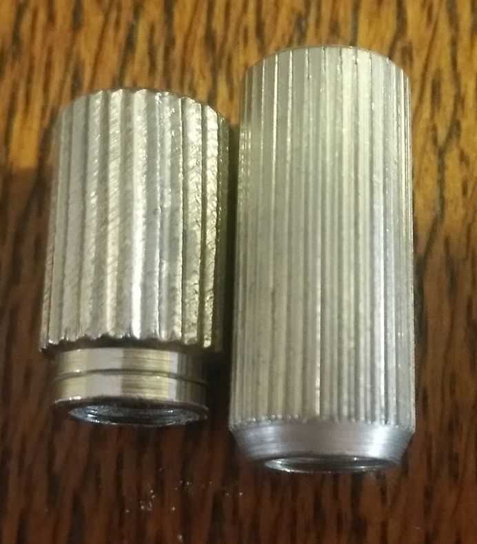

Millennium Maestro Posted April 20, 2016 Posted April 20, 2016 Luis, just don't get the large post bridge... As Josh stated there is 2 different threads for the Tailpiece studs, I say yank the originals and put in the new inserts whichever thread you get the best deal on. The insert on L is factory and I replace most of my retros with the insert on the right.

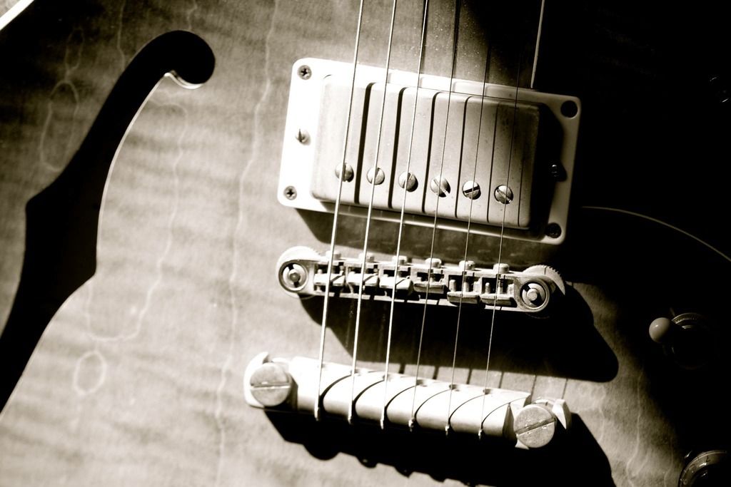

kidsmoke Posted April 26, 2016 Posted April 26, 2016 Sorry for dropping the ball on this thread redshark let me just say I'm not affiliated in any way. I just drank the kool-aid. all of it. The key to the faber system, aside from historical correctness, is the tone-lock approach. It does secure the tail and the bridge to the guitar, giving the optimal possible integrity between the physical instrument and the vibrating string. This gives your pickups the best chance to capture the sum of the instrument sonically. If you simply swap a single component, and not address or improve the issue of transferring vibration...what have you done to change what your ears hear? To illustrate...here's what I started with the bushings are recessed too far into the top, allowing a dramatic amount of flex of the entire tailpiece apparatus. The Gotoh Nashville bridge from zinc weighs a ton, and provides a couple ounces more material the stop tail "slips" over the posts and only contacts them on perhaps 25% of the surface. Read up on the tone-lock approach here http://www.faberusa.com/product-category/faber-tone-lock/ Effectively they give you lighter weight and mass and as "mated" a hardware/wood interaction as is possible. Meaning that strings and wood get the best possible marriage. You don't have 4 ounces of zinc, barely touching posts, sucking up vibration as it travels through the components. here's my "after" shot The tailpiece is rock solid to the top. It is clamped such that 100% of the surfaces of the tailpiece are contacting the posts into the top. the lightweight Aluminum ABR bridge is also clamped down, utilizing the special "spanner" type nuts, again providing constant contact to the threaded posts, which are one piece with the bushing in the top. the fact that none of this can fall off during a string change is an incidental benefit. IMHO, buying a Faber Tone - Lock Master Kit gives you the highest degree of integrity that you're doing everything possible to maximize whatever tone may exist in the basic construction of your instrument. I KNOW I improved my guitar in this way. I had heard an improvement simply by dropping the old tail and top wrapping, I then changed everything...pickups, harness, and hardware. The guitar was transformed. What percentage of the change was the bridge and tail? The minority in all likelihood. But I do know it is not a weak link. On the contrary. It's the most infallible component in the chain at this point. hey, you asked...
