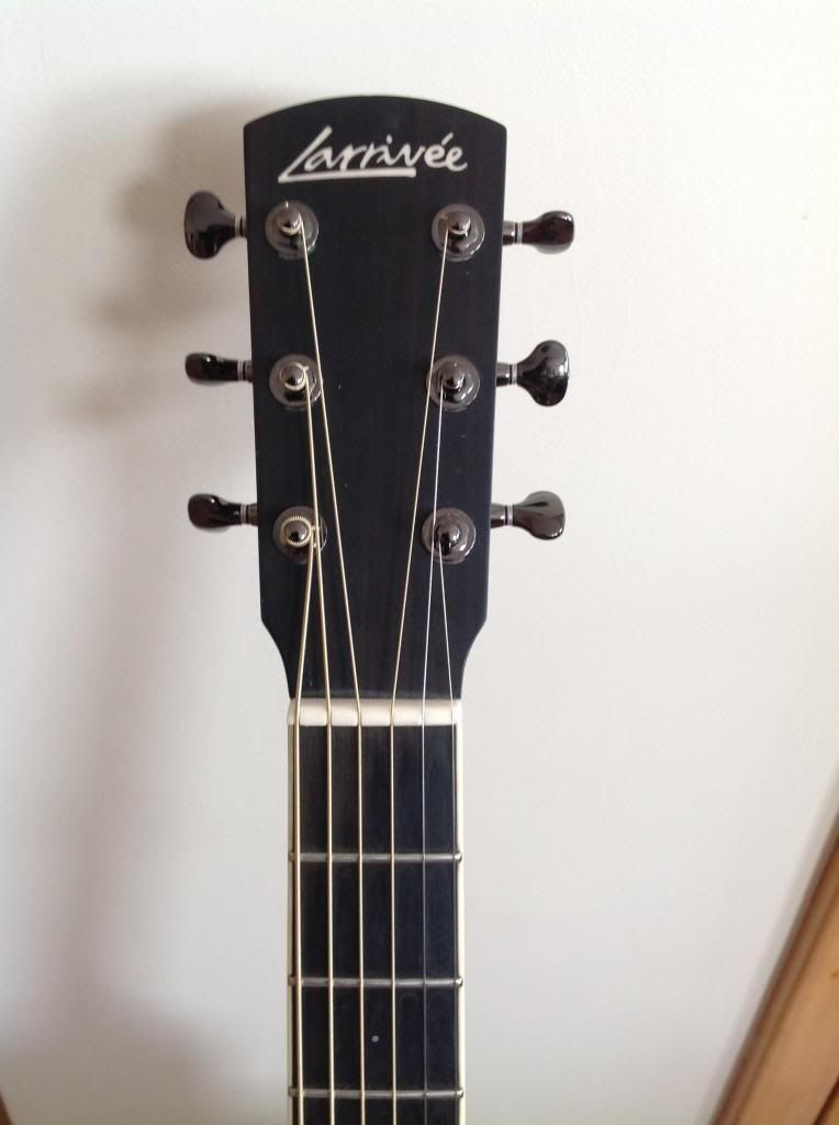

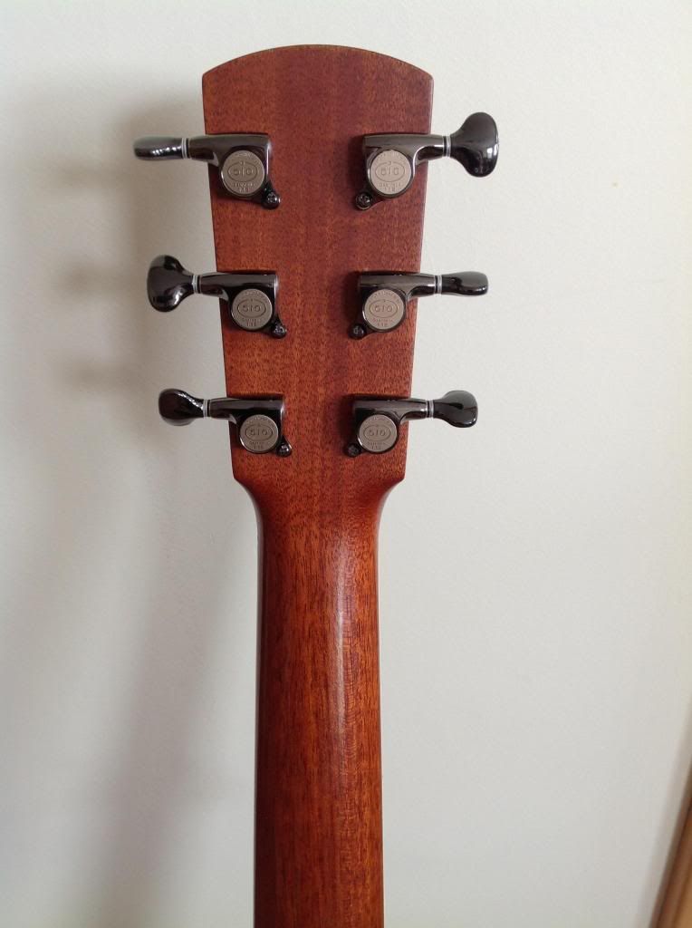

kidsmoke Posted January 13, 2017 Posted January 13, 2017 I went from stock Grovers to the TonePros/Kluson replacement. I've used these and the Grovers (put them on a 150), and personally prefer the TP/K's What Millenium said, with these or the Grover's, the bottom screw will line up perfectly, allowing you to use the new hole as a perfect template for the top screws. In my case I intentionally went with "aged" hardware on the entire guitar, so you can see they aren't shiny. I love the Kluson's on Kalamazoo wood. the Gotoh 510's are a fantastic tuner. Easily the most comfortable knob I've ever used. VERY high quality. I dropped them onto one of my acoustics. Tremendous functional and cosmetic upgrade. these are the 510 mini's. Due to the hole location, these will NOT drop into your 535 without creating a new hole and leaving one exposed.

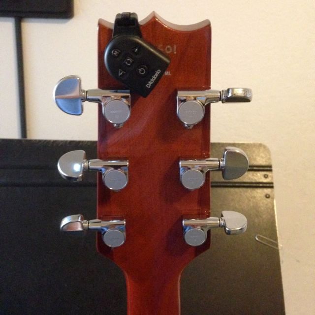

Gitfiddler Posted January 14, 2017 Posted January 14, 2017 These.... (mic drop).... Mic drop indeed! I'd love to install a set of Grover Deluxe tuners like that on my 150. I can't stand the Grover Imperials that Ed Roman ordered for his 'Class of 59' editions way back when! They work fine, but to me, look bizarre and out of place on this git.

Millennium Maestro Posted January 16, 2017 Posted January 16, 2017 Mic drop indeed! I'd love to install a set of Grover Deluxe tuners like that on my 150. I can't stand the Grover Imperials that Ed Roman ordered for his 'Class of 59' editions way back when! They work fine, but to me, look bizarre and out of place on this git. I think you should get rid of that defective guitar to an outstanding Guy in Vegas! Those are not the common tuners for a Co59, did you try to pull one off to see if they were after the fact add ons? I Believe those are Grover Imperials
Millennium Maestro Posted January 16, 2017 Posted January 16, 2017 These.... (mic drop).... Another happy customer!
Gitfiddler Posted January 17, 2017 Posted January 17, 2017 I think you should get rid of that defective guitar to an outstanding Guy in Vegas! Those are not the common tuners for a Co59, did you try to pull one off to see if they were after the fact add ons? I Believe those are Grover Imperials Grover Imperials came on many Co59 gits. (See below). If I can replace just the tuner ends with Grover Deluxe, that would be great.
Millennium Maestro Posted January 17, 2017 Posted January 17, 2017 CO59s mostly used Rotomatic 109C tunershttps://www.grotro.com/Grover/ROTOMATICS/784b94de-24a5-4b57-a9cf-3558bdc69466/Super-Rotomatics-109-Series
Gitfiddler Posted January 17, 2017 Posted January 17, 2017 CO59s mostly used Rotomatic 109C tuners https://www.grotro.com/Grover/ROTOMATICS/784b94de-24a5-4b57-a9cf-3558bdc69466/Super-Rotomatics-109-Series Got it. They're still ugly. Can the ends be swapped out?
TalismanRich Posted January 18, 2017 Posted January 18, 2017 Got it. They're still ugly. Can the ends be swapped out? I'm pretty sure you can just unscrew the buttons and replace them. My preference would probably be the Grover 102s with tulip buttons.
Millennium Maestro Posted January 18, 2017 Posted January 18, 2017 I'm pretty sure you can just unscrew the buttons and replace them. My preference would probably be the Grover 102s with tulip buttons. You have your answer, buttons with correct length screws... Or you could sell the defective guitar to me! LOL
Gitfiddler Posted January 18, 2017 Posted January 18, 2017 You have your answer, buttons with correct length screws... Or you could sell the defective guitar to me! LOL If I replace the tuner buttons, this will be the perfect 150...and no longer 'defective'! And Guy, you already gots dibbs, brother. Hopefully all of this side-bar chatter has helped the OP with his 535 tuner question.
