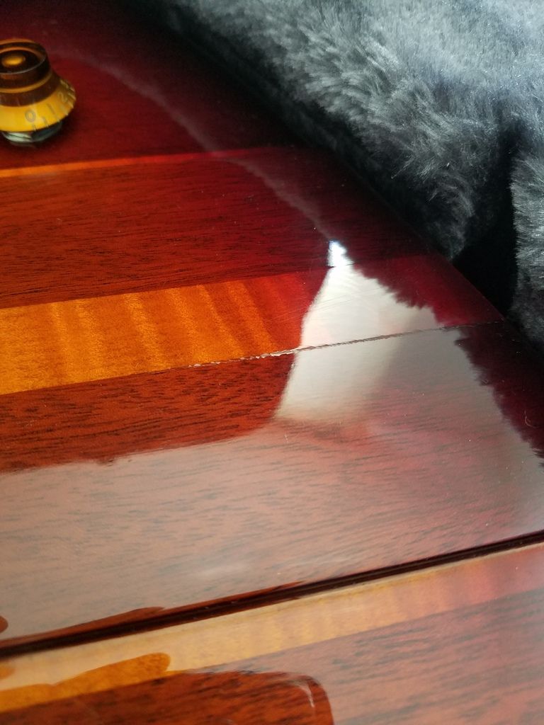

gpuma Posted April 21, 2017 Posted April 21, 2017 Yesterday I pulled my H357 out and I noticed something really small but nonetheless troubling, given the emotional value attached to this guitar. I noticed that the finish at the junction of the central maple insert (on the guitar top, just behind the bridge) is not smooth anymore. In other words, the line that defines the border between maple and mahogany can be felt with the tip of your finger, as the finish over it seems to have raised slightly. What is it, and how can I fix it? Did anyone experience a similar problem? My worry is that the finish might peel off. I'll try to capture it on a picture.
Gitfiddler Posted April 21, 2017 Posted April 21, 2017 As George Castanza said on Seinfeld...Shrinkage! Possibly the wood is settling in as it dries. Take a couple of close up photos for us to see exactly what's up. Hope it is something simple.
gpuma Posted April 21, 2017 Author Posted April 21, 2017 the picture actually looks worse than it really is. I am wondering if a hot surface might help blending the finish again

yoslate Posted April 21, 2017 Posted April 21, 2017 Wood is an organic "living" substance. Anybody who's done much work on instruments has a sense of the idea that wood never dies. It breathes, moves, and responds to heat and cold, dryness and moisture in ways not dissimilar to how we do. The lacquer is a pretty fickle chemical, and its application and curing are a fickle process, as well. Though I'm sure the appearance of this finish flaw on an otherwise pristine instrument is disturbing, there's nothing unusual going on here. Undesirable, sure. Unnatural, no. What I'd do, Gio, is rub my finger along my nose or across my forehead, and get some of my skin's oil on the fingertip. Rub that well into the crack (you can then polish the surface). That oil will keep moisture from getting into the crack (which is likely just the nitro) and, perhaps under the finish, doing more damage. Then you can watch it for a while, maybe get a better idea of what's going on. Likely just the clearcoat, which is a relatively easy fix, if you know what you're doing. If you can't live with what's there, as Tim said, take it to a pro who knows finishing (not all guitar techs do), and let him evaluate it. Good luck!

bolero Posted April 22, 2017 Posted April 22, 2017 +1 to Yoslate's comments I am pretty sure that is just due to the different pieces of wood expanding/shrinking, over time on my 357 I can also feel the seams where the different strips of wood meet; it was smooth when new the good thing about nitro is it will melt into an existing finish very well. So if that bothers you it shouldn't be hard to touch up, for a pro
brentrocks Posted April 22, 2017 Posted April 22, 2017 My 357 is a hog/maple/hog center block and i can see/feel the transitions slightly.....now granted, mine is 30 yrs old. the finish hasn't cracked...yet. I wonder if it has to do with the age and curing time of the wood? Newer wood/faster curing times? Modern lacquer?

gpuma Posted April 22, 2017 Author Posted April 22, 2017 Pete Farmer just wrote me. It is not something that would be covered under warranty, understandably; i was not really expecting it. It seems that the general agreement is that it is a minor thing however i know exactly zero luthiers over here. Need to investigate the landscape

gpuma Posted April 24, 2017 Author Posted April 24, 2017 Pete Farmer was able to put me in touch with a local tech. I'll bring the guitar there soon.
