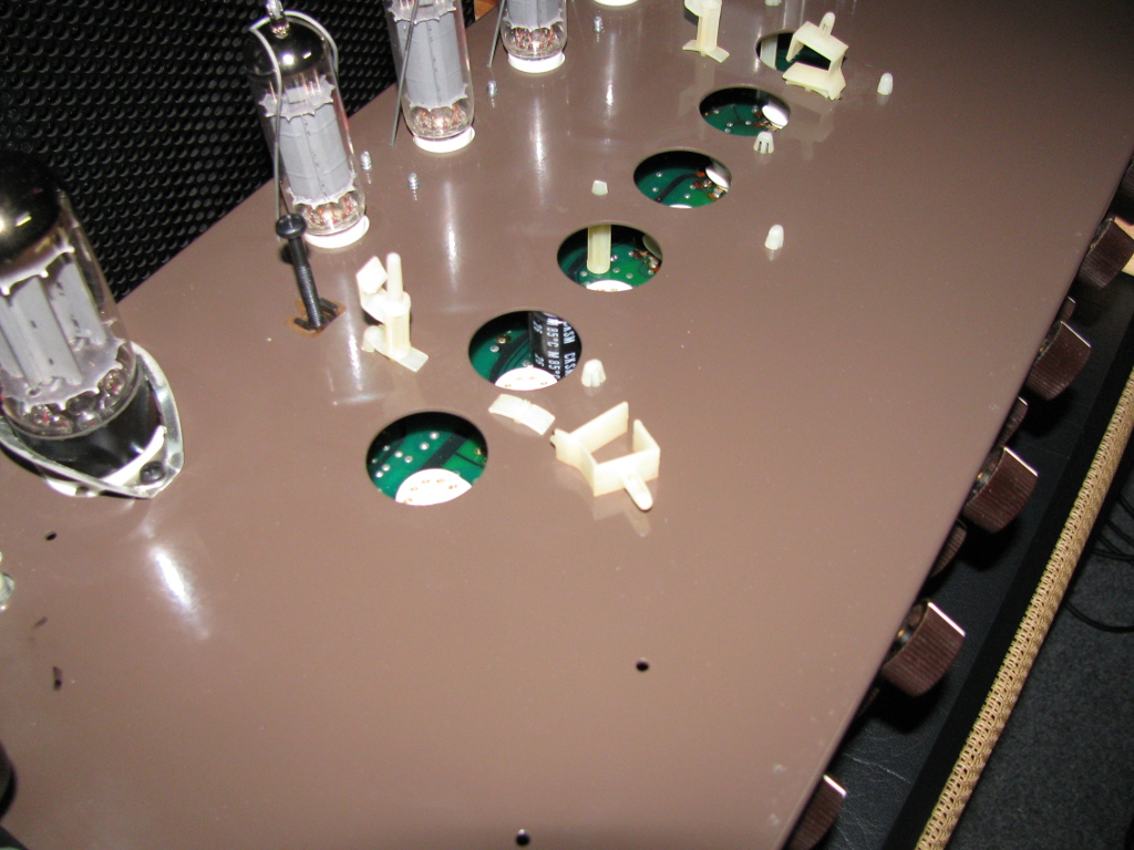

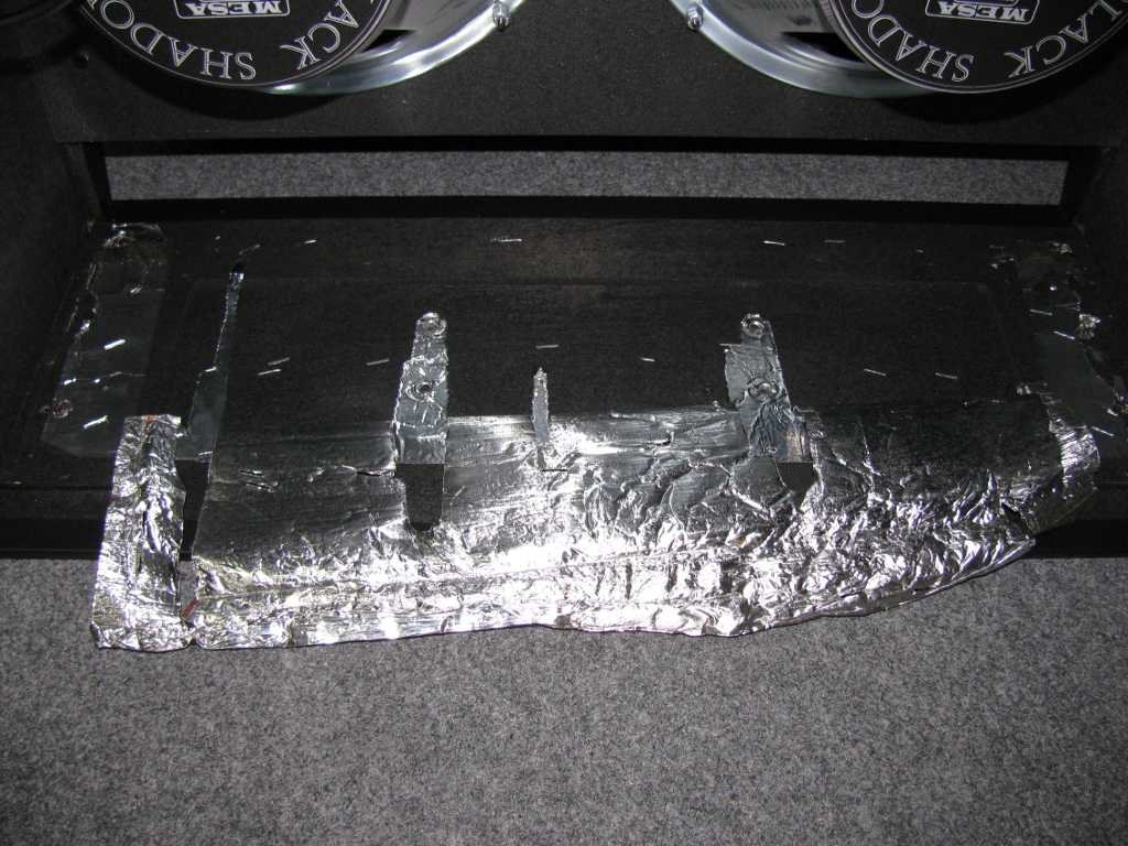

tbonesullivan Posted June 21, 2017 Posted June 21, 2017 So, I picked this up a month or so ago, and it needed a little help to get it back into fighting shape. It looks like the grille on this may have been swapped with another maverick, the logo has definitely been changed, and more importantly, the EMF shielding on the inside of the top of the amplifier was completely wrecked. Also the grille was not actually attached to the amp, so it would fall out when the chassis was removed. The original grille was screwed in from the front of the cabinet, but this one was definitely originally attached from the rear. So, I drilled some holes, and now it's firmly attached. The amp came with a whole set of JJ preamp and power tubes, and so far I have kept those in. I do have some new and old production tubes I may swap in, to see if I can get a bit more smoothness out of it, though as is it's pretty dang smooth. The speakers in this are the Mesa Boogie Black Shadow C90, which is different than a lot of the 2x12s, which had vintage 30 speakers in them. I'm looking forward to find all the tones in this box. The "clean" channel has both a "bright" and "fat" mode which really does change up how the amp responds. It's also got switchable diode or tube rectifiers. Oh yeah, and it looks pretty cool: I swapped out the stock red power jewel for a "purple" one, and I like how it looks. I may need to get some #47 automotive bulbs, as I think the bulb is near the end of its life, being pretty yellow in color and not bright. Anyway, here are some of the issues that needed to be fixed: The original RF shield ripped almost all the way off. It also was bunched up and not able to be stapled back down: And here it is after installing new shielding I got from Mesa Boogie, along with a new foam strip: I also had an issue with one of the plastic clips that holes on the preamp tube shield. Unfortunately these are not able to be sourced, but thankfully there was a nice large surface area for Plastic Bonding Acrylic Epoxy. Someone also had put casters on the bottom, not even bothering to take off the price labels on the top of the casters. They probably also didn't pre-drill the holes. However I got some new feet from Mesa Boogie, and now it's back to normal. The guts, like all Mesa Boogie amps, look glorious:

Gitfiddler Posted June 29, 2017 Posted June 29, 2017 Part of what led to getting this amp was that I missed out on a gently used Lone Star Special at Guitar Center a few months back. I SHOULD have jumped on it, but I didn't, and then it was gone. This amp had been listed locally on the Hamer Fan Club, so I figured the price was great, and picked it up. Previous owner barely used it, had picked it up a year or so before. It's been through a lot of owners, probably due to the weight. It is hefty, but not Marshall TSL122 hefty. That thing weighs 75 lbs. The maverick is probably 50-60 tops. I could always go for some neodymium speakers to see if I can get it lighter, but I like the sound of the stock speakers so much. You got a great amp there, TB. The innards look clean enough to eat off of. I'm sure it will transform into an even greater amp once you get the tubes in it that you like. As for the weight, 60lbs is light for a 2x12 Mesa. My 1x12 MK IV weighs between 80-90lbs...but came with casters. I wish it came with a Sherpa!
tbonesullivan Posted June 29, 2017 Author Posted June 29, 2017 My DC-5 is pretty hefty, but it also is only 50 watts. The Maverick is only 30, so that definitely cuts down on transformer size, which reduces the weight. 100 watt Mesa Boogie amplifiers are back breaking, even the heads. However they build a quality product. They really do know how to wire the insides of an amp in an effective and clean way. Also, wired pots: WIN.
