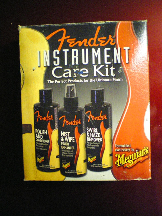

High Flying Bird Posted December 9, 2017 Posted December 9, 2017 I got an H-475 used with a thick film of bar funk on it. I bought a Fender/McGuire's guitar care kit. It had a swirl and haze polish that worked magic. I also used it on Joe's Martin. It took some elbow grease but the shine underneath was worth every minute of the work. New life! Joe never knew the finish was that gorgeous until he saw it after it was cleaned.
LuigiMcJazz Posted December 9, 2017 Author Posted December 9, 2017 Thanks very much. That looks like a good kit. For now, I got the GE looking respectable again with a damp cloth.

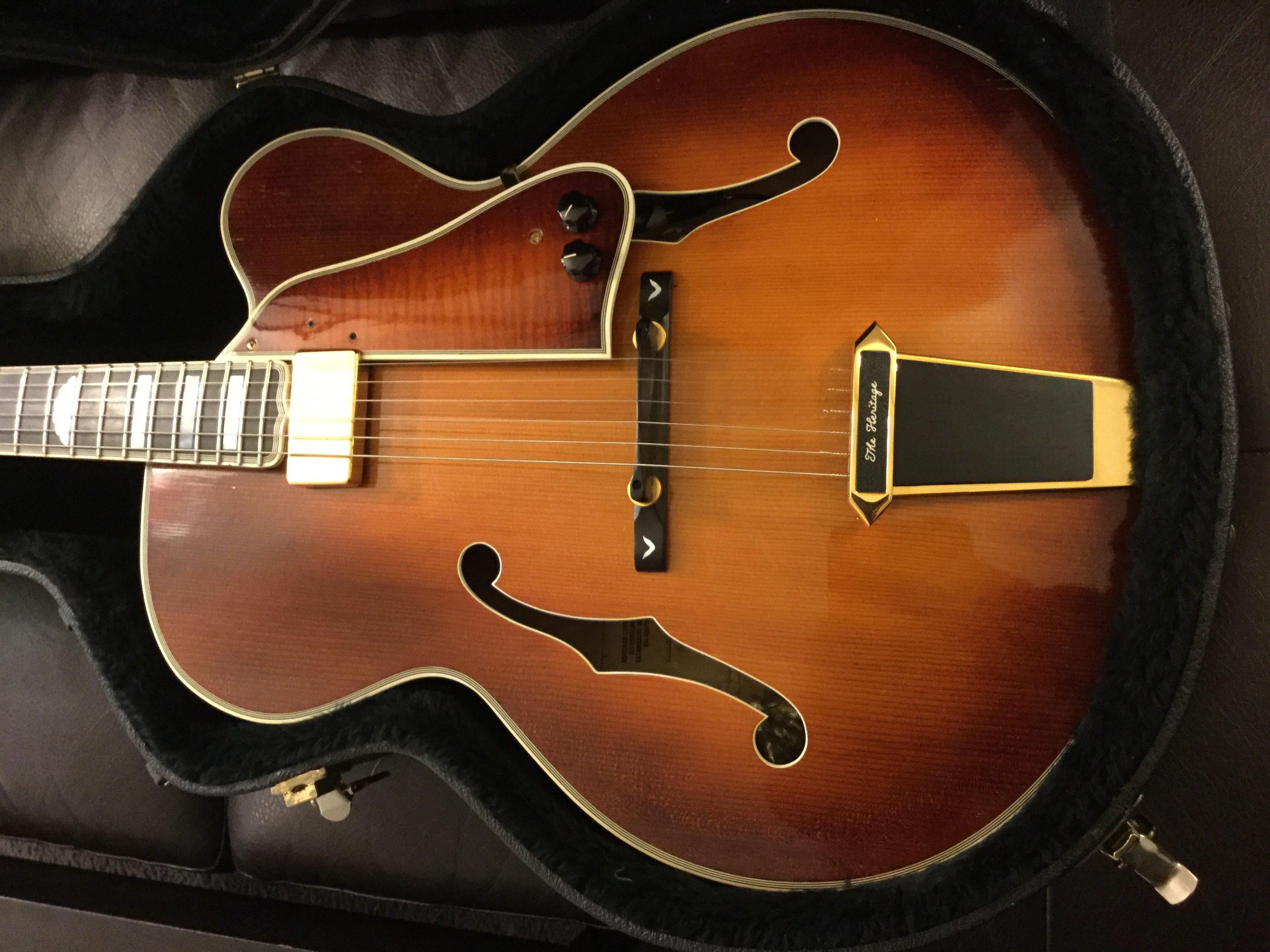

LuigiMcJazz Posted December 11, 2017 Author Posted December 11, 2017 Thanks everyone. I did contact Heritage about this and they recommended Aristo Shield Polish in their reply. Does anyone know how that compares to the others mentioned, or the Martin polish? Picture attached:

DC Ron Posted December 12, 2017 Posted December 12, 2017 23 hours ago, peteraltongreen said: Here's what I use.Always use a spirit polish.I find that a wax polish drags my palm on the back of the neck.Never use anything containing 'silicone'...that attacks the finish. For metalwork,I use a tube of metal paste,as used on cars (NOT on Gold plate ).Don't over rub..you'll take of existing polish & plate. For Rosewood fingerboard, kitchen paper,soaked in Lemon oil.Let it work on the dead skin deposits,then,cocktail stick off the grunge ( I sometimes champfer the stick with a Stanley knife) ,and with clean kitchen paper,take of excess oil..Just like new. Before you play..make sure your hands are clean & dry. If anyone knows a source for the Fender Instrument Care Kit by Meguiar's, please let me know. Think it was discontinued several years ago, although some supply may exist. This is a great kit, and my favorite of all these options...
