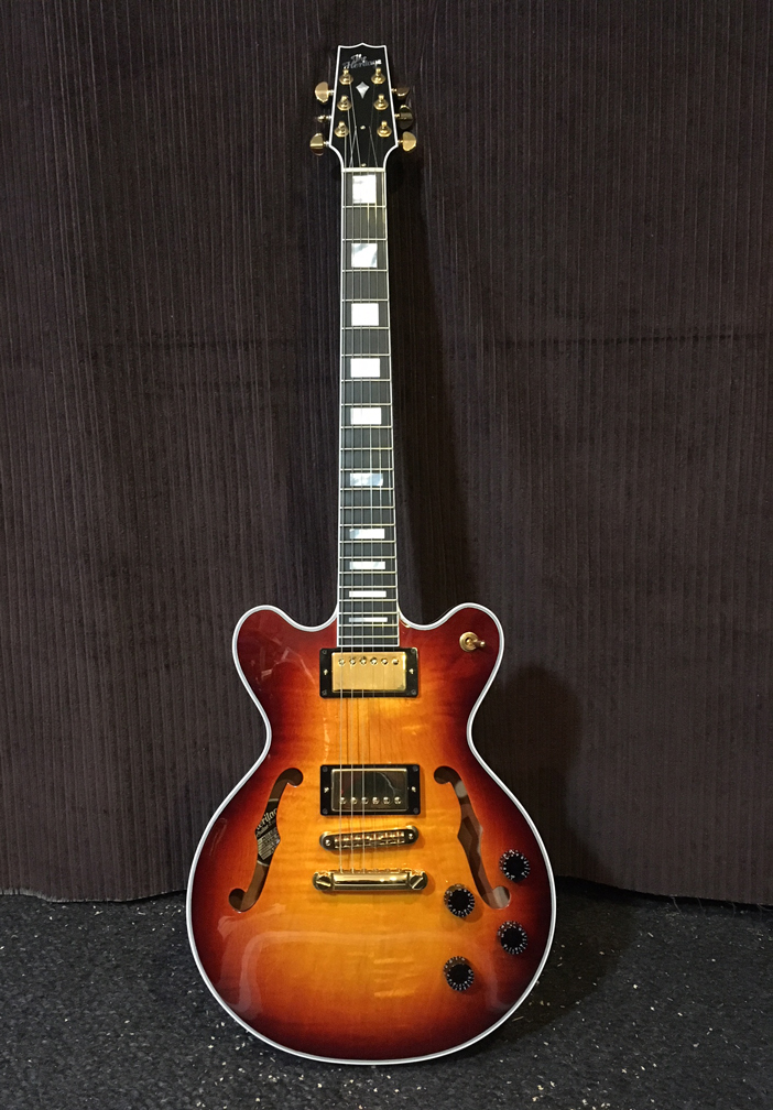

LittleLeroy Posted January 2, 2018 Posted January 2, 2018 I know you said 2" depth, but have you tried one of these?
