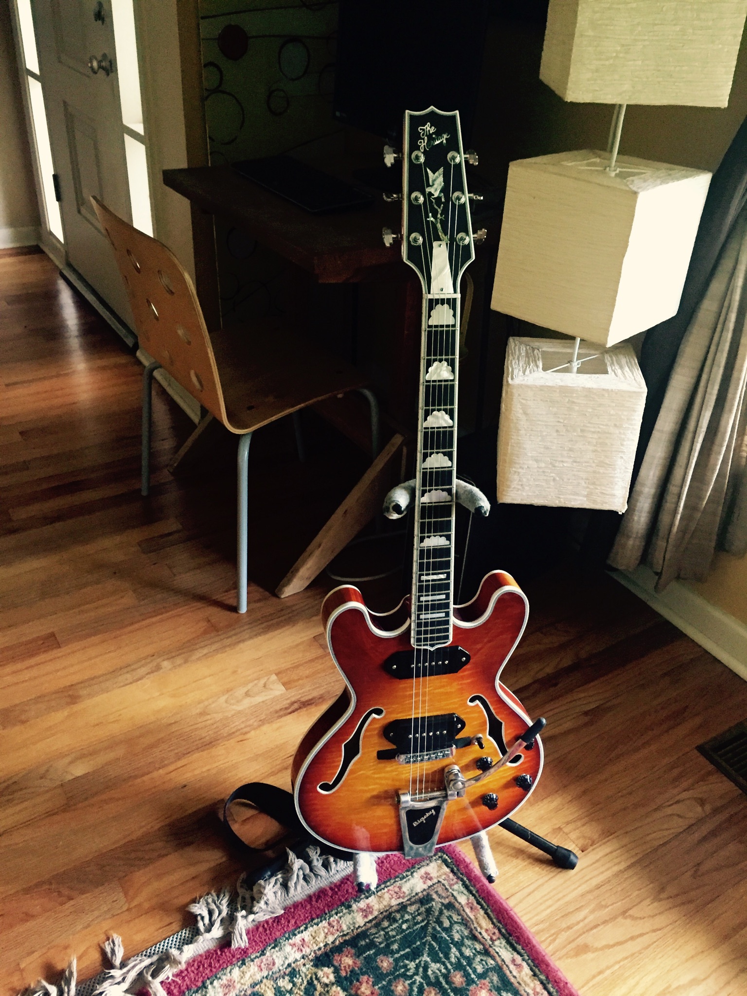

GrimFossa Posted January 9, 2018 Author Posted January 9, 2018 1 hour ago, big bob said: Man that thing is sexy!!! I gotta say I am looking for humbuckers...but that bigsby is mighty appealing. i could potentially swap for humbuckers right? How much are you selling it for? Thanks for the response!
big bob Posted January 9, 2018 Posted January 9, 2018 Not for sale. Ever! Kate Flamm made this for me! for me!
GrimFossa Posted January 9, 2018 Author Posted January 9, 2018 1 hour ago, big bob said: Not for sale. Ever! Kate Flamm made this for me! for me! Ah okay! just posted to get me droolin i guess lol!
