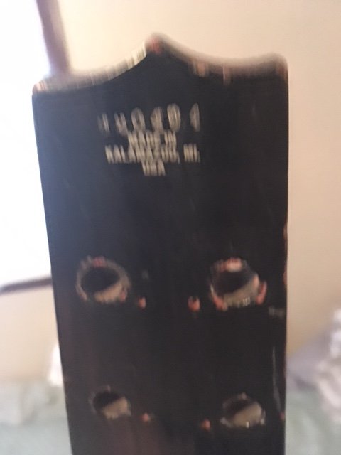

GmA Posted January 21, 2018 Posted January 21, 2018 Hey! I just bought an H140 in need of some love. It was cheap and I am up for the project. Which tuners should I buy? The serial number stars twith D, so I believe it’s a 1987. I want them to be direct replacements without any drilling needed. I have some pictures of the guitar and I am open to suggestions. I already have an SD ‘59 for the bridge and it has the original schaller neck pup. I’m gonna buy a wiring harness off reverb, a new bridge, and then go to town. Thanks in advance for any help. **I am having trouble uploading photos. I’ll post them in the morning.!

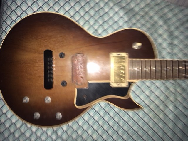

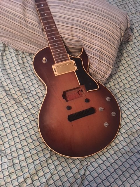

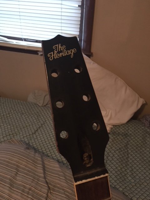

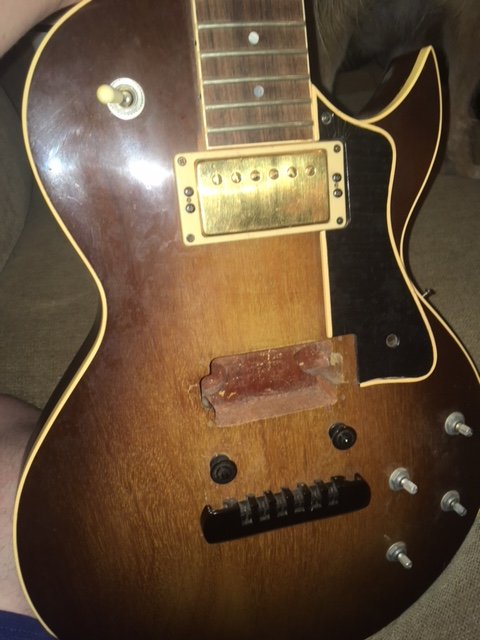

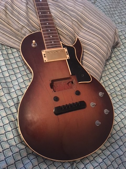

GmA Posted January 22, 2018 Author Posted January 22, 2018 Sorry it took so long to upload the photos, I've been busy the past few days. I bought this as a project guitar and I am super excited about it. It obviously need some work, but the bones are VERY solid. According to the person I purchased this from, it was their Grandpa's and he worked for Gibson/Heritage for quite some time (probably BS, but fun story). I figure $200ish worth of quality replacement parts, time, and patience oughta have her up and squealing in no time. Grover posts definitely fit the holes, but the screw hole is diagonal. Any idea of which model Grovers would accommodate my needs?

Millennium Maestro Posted January 22, 2018 Posted January 22, 2018 On 1/22/2018 at 6:33 PM, GmA said: Grover posts definitely fit the holes, but the screw hole is diagonal. Any idea of which model Grovers would accommodate my needs? Expand Every time I see this hole pattern I think Schaller. they have a M6_180... here is the link. There is a spec. document there you can use to measure correct fit.https://www.schaller-electronic.com/hp555171/M6-180-posts-for-solid-headstock-23-7-mm-37.htm?ITServ=ctfcs7kabebf1pg591btcl7i22

GmA Posted January 23, 2018 Author Posted January 23, 2018 On 1/22/2018 at 8:22 PM, Millennium Maestro said: Every time I see this hole pattern I think Schaller. they have a M6_180... here is the link. There is a spec. document there you can use to measure correct fit. https://www.schaller-electronic.com/hp555171/M6-180-posts-for-solid-headstock-23-7-mm-37.htm?ITServ=ctfcs7kabebf1pg591btcl7i22 Expand Thanks a bunch, I’ll check them out, I put a “Grover” in one of the holes and it fit well but screw holes didn’t line up. On 1/22/2018 at 10:06 PM, iGouger said: amazing how gorgeous that one is, even in it's current shape. keep the pics coming as you bring it back to life... would love to see the progress. Expand I’ll keep posting pics along the way. Any tips, tricks, or suggestions are welcome.
DetroitBlues Posted January 23, 2018 Posted January 23, 2018 It’s actually a rare guitar (note...that does not mean valuable). The holes indicate there was different tuners other than Grovers. Do you mind exposed holes? The pickguard doesn’t belong to tha guitar, that’s a newer H-157 Pickguard. With The Florentine cutaway, the guard doesn’t line up correctly. its a beautiful guitar, some spit and polish and the upgrades your doing, it will be a great guitar!

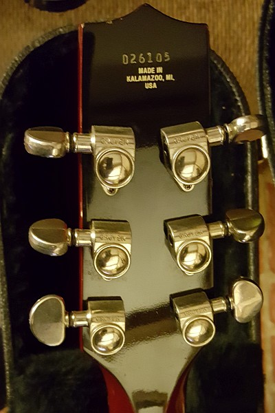

TalismanRich Posted January 24, 2018 Posted January 24, 2018 DB is right, its unusual. Its got binding along the neck which, not standard on the basic H140. Definteily the pickguard is not stock. The tuners could be Grover 205. Its very close to the Schaller. Interestingly, my 87 H140 has Grover 102 style with the hole straight down.
