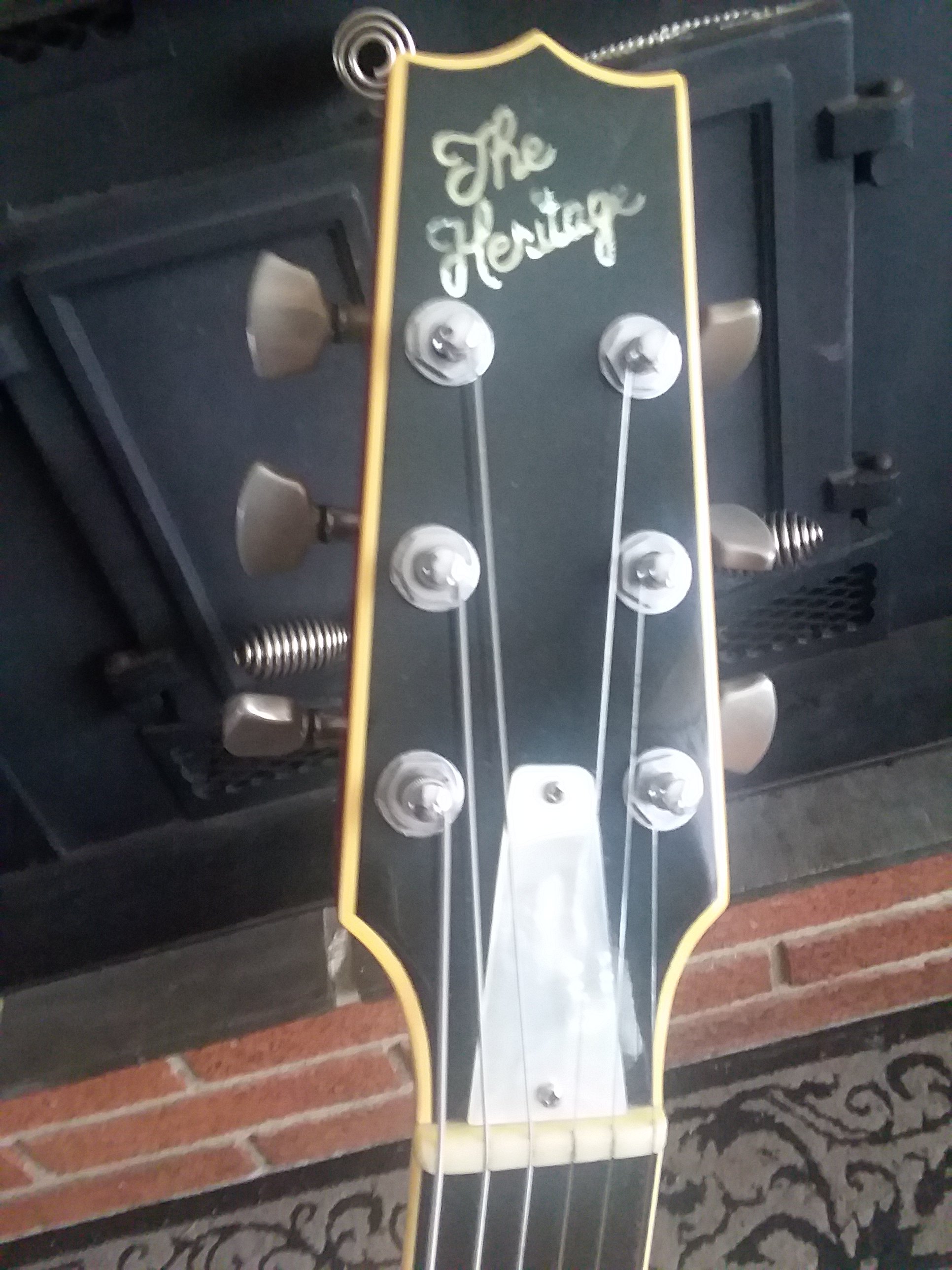

Hfan Posted January 25, 2018 Posted January 25, 2018 Last summer I started a thread about the Sperzels on my H535. I thought they were slipping, and I got great advice here with install tips and replacement recommendations. I actually bought a set of Kluson Tulip Tips that I believe Kuz recommended. They have been sitting since, I'm busy lately. Here is the link, the thread appears closed: http://www.heritageownersclub.com/forums/topic/32255-anyone-replace-the-sperzels-on-their-heritage/ I finally had a chance a week ago to grab some tools and start the process. I pulled off the first Sperzel and found that the Klusons fit perfectly so I would just have to make a hole for the one screw each. The Sperzels use a separate pin that goes into the headstock and into a recess on the tuner, no screws. Then I noticed how much nicer the Sperzels looked on this 535 which has an ivory binding on the headstock and pearl inlay. The ivory pearl colored Sperzels were a perfect match in color and size. The tulips to me stuck out too far and looked odd and were a poor color match. The Heritage boys and Jay knew what they were doing. The 535 is a "35 Special" that Wolfe sourced around a decade ago it is a 2006. Then the Homer Simpson moment, DUHHH the knob screws and the nuts on the Sperzels were mostly all loose, hence the slop. Tightened them up and project over. I'm glad I did not make any new holes. And I felt dumb but relieved and it freed up an hour of my time to actually play a little. I felt bad that I had dissed the Sperzels by claiming they slipped. My mistake. Sperzels are fine and they are pretty. So I now have a set of Klusons I wasn't sure what to do with. They may go on a future Epi jazzbox I am considering. My apologys to the Sperzel folks.

LittleLeroy Posted January 26, 2018 Posted January 26, 2018 13 hours ago, Hfan said: Not for nuthin', but that's a beauty! Like an ocean of waves....

Hfan Posted January 27, 2018 Author Posted January 27, 2018 23 hours ago, LittleLeroy said: Not for nuthin', but that's a beauty! Like an ocean of waves.... Thanks LittleLeroy. I saw it on ebay then drove to CT to meet the seller and snagged it.
