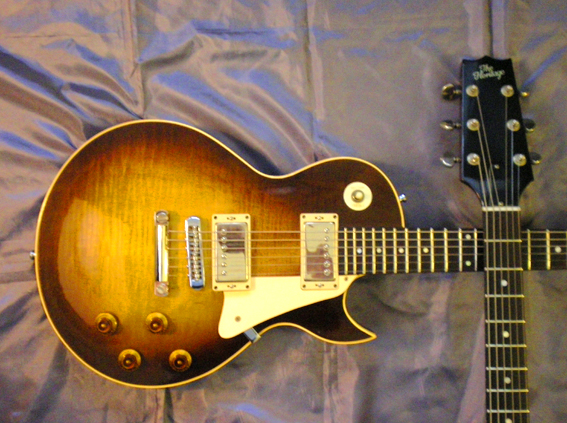

Tincu Posted February 2, 2018 Posted February 2, 2018 What pick-ups are most compatible for a h150 heritage? The original seymour duncan 59 or others?
peteraltongreen Posted February 2, 2018 Posted February 2, 2018 I put Seymour '59's on my 140,and the difference was amazing...and swapped some of the hardware too .. and replaced & re wired the pots. Now, it's a killer !
CJTopes Posted February 2, 2018 Posted February 2, 2018 Thats a pretty subjective question. It really depends on what you're looking for tone wise. IMO A pair of 59's will sound good in there as an all around pick up. Seth's and Pearly Gates are popular also. Some guys like a combo of two. Maybe a 59 and a JB. I'm sure someone here will have a better answer.
bobmeyrick Posted February 2, 2018 Posted February 2, 2018 As CJTopes said, the 59s are good all rounders. When you acquire more than one H150 you can have a choice... My favourite 150 started with 59s, but I swapped them for a pair of Bare Knuckle Stormy Mondays (Alnico 2 magnets, based on the early PAF) which gave what I can only describe as a "looser" feel and a slightly sweeter sound. When I acquired another 150 from a friend as part of a deal involving an amp swap I decided to keep the 59s. It's nice to have the options. If you haven't seen these guys already, check out the Doug and Pat Show. In their pickup comparisons they use a 150 as their test bed guitar, and they have a 1958 and a 1960 Les Paul as benchmarks. They're also very amusing . In fact in Shootout#2 they tested a pair of Stormy Mondays ... There are lots of good pickups out there, and half the fun is finding the ones that you really like.
Heritage1970 Posted February 2, 2018 Posted February 2, 2018 Love Duncan '59s. They're in all my Heritage' but yeah it's really a matter of preference
Tincu Posted February 3, 2018 Author Posted February 3, 2018 I recently bought a Heritage h150 with pick-ups Prc Mccarty in bridge and Gibson classic 57 in the neck. This combination does not suit me. I wonder how it sounds like an SD 59? I want a warm, clear, creamy tone more open.What should I choose? A friend suggested me the combination 57 classic in the neck and 57 classic + in the bridge.Or Dimarzio 36 paf. What to choose between the classic 57, 57+ or the Dimarzio paf ? I'm thinking that Heritage thought the best combination would be with the 59 SD's pick-ups. I mean the guitar sounds the best with these pick-ups .... I'm waiting for the opinions ...
