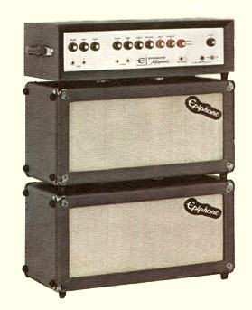

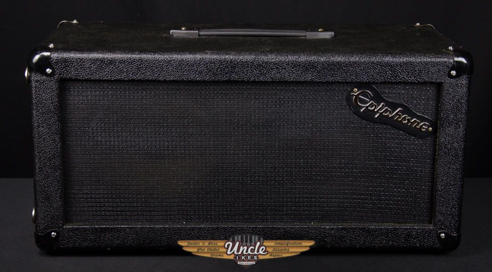

Gitfiddler Posted March 7, 2018 Posted March 7, 2018 14 hours ago, rwinking said: So I went ahead and ordered a 2X10 cab. I have a big 1X12 cab which sounds huge that I love and as I am doing some R&R larger venue type gigs I wanted too add a little high end punch. So what I will have now will be a full stackette w/a 50w head and two cabs. I went ahead and ordered a couple of Weber California 10s with paper domes to offset the sometimes piercing D120 I have in the other cab. It should be an interesting combination. Thanks you two for your input! Good move. 2x10 cab for guitar amps can sound fantastic, especially with quality speakers as you've chosen. I dig Weber Cali's. To scratch my 2x10 itch a while back I picked up this old Epi cab loaded with 2 CTS AlNico 10's from the late 60's. Sounds amazing connected to my Vibro Champ!
rwinking Posted March 7, 2018 Author Posted March 7, 2018 When did Epiphone make those cabs? That is so cool! I don't remember ever seeing one
Gitfiddler Posted March 7, 2018 Posted March 7, 2018 Epi made them back in 1966 or so. I believe they were Kalamazoo born n raised...part of the Epi EA 600 Maxima amp rig. Here's another that was sold on Reverb with a great description: https://reverb.com/item/6443051-1966-epiphone-2x10-vintage-guitar-amp-extension-speaker-cab-by-gibson-kalamazoo
rwinking Posted March 7, 2018 Author Posted March 7, 2018 Now I am officially jealous. Those are too cool. I had no idea about the Gibson Plus 50, which apparently is what these were. It looked like a sound system for a band....you plug the bass player and guitar players into it. Great score!
