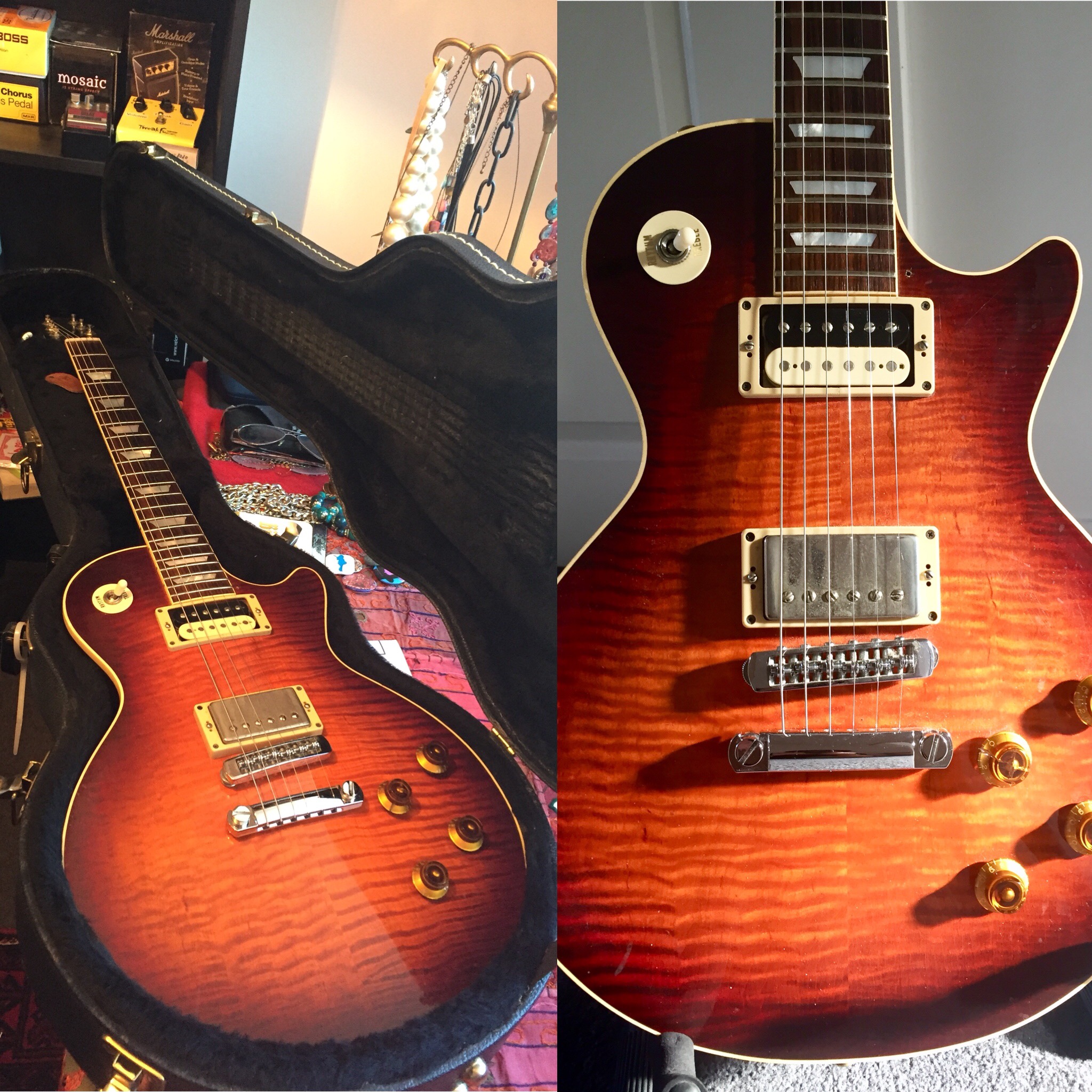

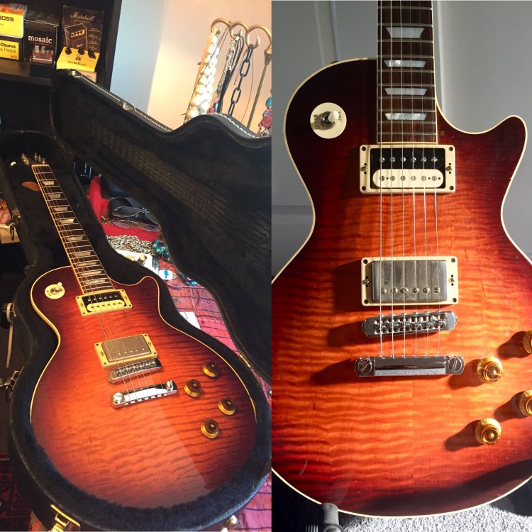

les paulverizer Posted March 14, 2018 Author Posted March 14, 2018 And this is the guitar, still with the original bridge pickup ring that I replaced yesterday with a Shadow Pickup Ring Tuner, same as all my other Les Paul's. In view of the helpful comments above, I'll just swap the roller bridge with an ABR or a Tune-o-matic then.

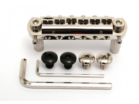

Millennium Maestro Posted March 14, 2018 Posted March 14, 2018 to go to ABR you would need a conversion post. https://www.ebay.com/itm/Conversion-Posts-Install-a-ABR-1-on-Gibson-guitar-with-Nashville-bridge-Nickel/111300017648?epid=1031375287&hash=item19e9ff7df0:g:j2QAAOSw7XBY8W0p

DaveRobrecht Posted March 17, 2018 Posted March 17, 2018 Duesenberg makes a wrap around that has the correct spacing to replace the tune-o-matic bridge. It even comes with rounded cap screws to cover the unused tailpiece holes/threads. You might have to replace the threaded inserts currently in the guitar with the ones that come with the bridge. I haven't found any for sale domestically. I think I got mine from Germany. It was about $100 shipped and came fairly quickly. I put one on a Hamer Special Junior. Duesenberg Bridge
Kuz Posted March 18, 2018 Posted March 18, 2018 If you are going the ABR-1 conversion, I personally would go with either Faber or Calaham conversion hardware.
