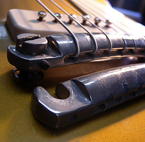

deytookerjaabs Posted October 18, 2018 Posted October 18, 2018 2 hours ago, mark555 said: On a separate point, I would never wrap strings round a stop bar unless the stop bar was designed for that. That's exactly what the stop bar was designed for, before the abr the tailpiece was the bridge.
deytookerjaabs Posted October 19, 2018 Posted October 19, 2018 Regardless of opinion on top wraps the bottom line is that the bridge/tailpiece absolutely was designed to have a good length of travel while remaining a solid couple so as to be used on a variety of guitars with different angles & setups. It was a brilliant move (& IIRC explained as thus by Gibson engineers) to keep it when the tune-o-matic was designed for the user to tune in different amounts of force/vector/break on their guitar. It's a big part of what makes the tune-o-matic such a special design: flexibility. I even recall reading that the first tune-o-matic test run was top-wrapped from the factory! One thing is clear: It was NEVER designed with the intention to be permanently decked. That is a matter of a fickle consumer base who now sees visual variation as a sign of lack of quality or worse...claiming tone robbery!! For decades one can see guitars from California to Asia Pacific built by the thousands to exacting standards thanks to our programmable machine friends. The angles that are programmed are to suggested tolerances, they are merely a matter of opinion. I'd say, as someone who has played way too many good old american guitars: absolutist tone rules like ideal saddle height on a flattop or ideal bridge height on an arch top or ideal height of a wrap tail don't play out as having inherent superiority in real life from my experience. Worse, when you listen to luthiers/techs I've heard it all from "truss rods kill resonance" to arguing over kerfing woods. They're an insane lot who usually just justifies their method with carefully crafted rhetoric...humans y'know. In summation: if you desire a hand chiseled neck fitment and a carve hand pressed on giant rough sanding belt then you're going to be stuck with a good deal of variation. If you want those things to exact tolerances: buy a PRS or Collings etc. But, don't say the wrong top carve or wrong neck angle is a "quality" thing, that's bull****, nothing posted here was out of reasonable mechanical tolerance.

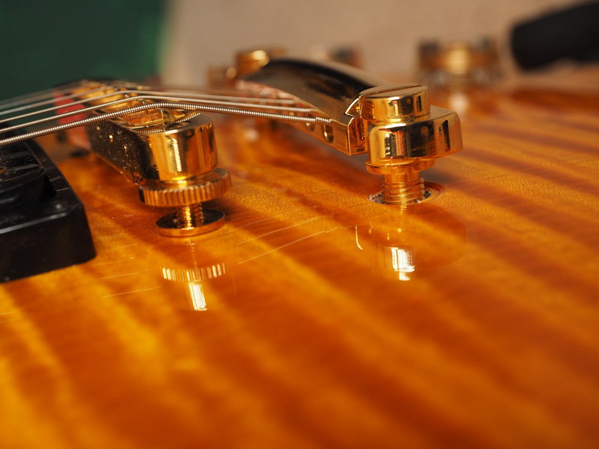

bobmeyrick Posted October 26, 2018 Posted October 26, 2018 This may be of interest. From my friend's recently acquired Les Paul Supreme (see "NGD, but not for me..." in the Family Tree section).

Kuz Posted October 27, 2018 Posted October 27, 2018 On 10/26/2018 at 11:49 AM, bobmeyrick said: This may be of interest. From my friend's recently acquired Les Paul Supreme (see "NGD, but not for me..." in the Family Tree section). And I wouldn't buy that guitar either.... Strings hitting the back of the bridge even with the tail piece that high, no thanks. All my stoptails (6 guitars; 2 Heritages, 1 Gibson, 2 Collings, 1 McInturff) have Faber locking ABR-1 TOM & Stoptails. All guitars have the stoptail almost all the way down to the top and the strings don't the back of the TOM bridge. That's just my opinion, and I like my guitars set up that way. I have he flexibility to raise the stoptail or top wrap if I want to. But I am not FORCED to top wrap because of a bad neck angle.
