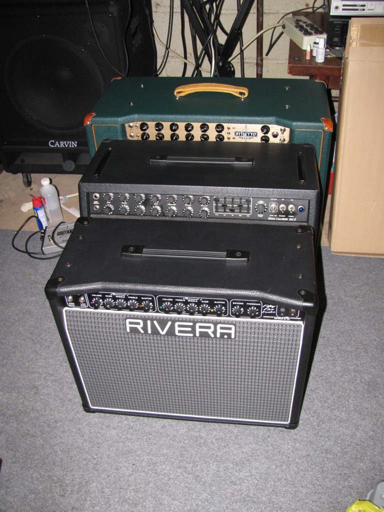

tbonesullivan Posted November 22, 2018 Posted November 22, 2018 I'm honestly not sure how I got the idea, but I ended up looking at the Mesa Boogie Stiletto line of amps. Part of it was that while the Rivera R55 I have is an incredible amplifier, with tons of versatility, there was something I was still looking for. Something closer to the Marshall I have but in a more "user friendly" package. I make no bones about being a Mesa Boogie fan, particularly of their less well known amps, as well as ones that others are not a fan of. I think I was reading some forum posts, and someone mentioned that the Stiletto series was another series that Mesa Boogie had put out that was "british" flavored. I remember seeing them years back, and honestly not really understanding what they were. It was also before I picked up the DC-5, so I really didn't have MB on my radar at all. Anyway, I read reviews, and I listened to a whole bunch of demos on youtube, something everyone should do before buying any amp. Something that I stupidly never did before getting a Marshall TSL combo, because that had been my dream amp when I was younger. What a bad dream it's been, and now maybe over? I looked online, and found a really nice looking one not that far away on reverb, which showed up yesterday. The reviews and experience of others has been pretty divisive, with some loving the Stiletto series, and some hating it. Thankfully, I really like the sound, as well as the features. The clean channel has three modes, which are Fat Clean, Tight Clean, and Crunch. The Fat Clean is pretty much Tweed, and the Tight is more blackface. The crunch is well.. crunchy. It does a really good job of getting the AC/DC type of sound, from borderline breakup to nice crunch. The EQ is very responsive, so you can dial in a lot of sounds. The lead channel has a clone of the crunch channel on the clean side, and then Tight Gain, and Fluid Drive. The Tight Gain might be similar to the lead channel on a DC-5. The Fluid Drive is pretty much like using a boost into a fully driven amp. It's very smooth with a ton of crunch and compression. The amp also has Solid State/Tube rectifier switches for each channel, as well as the Bold/Spongy variac that it seen in various forms on a lot of the Mesa Amps. Regarding the amp being harsh/bright/etc: it definitely is a cutting amp. The low end is somewhat limited, especially compared to the Rectifier series from Mesa. But it's tight. If anything is overpowering, it might be the mids, and not the highs, IMHO. But, The EQ can take care of those issues. I didn't find anything especially harsh unless I really cranked up the treble and the presence and cut the mids. Mesa does say in the manual that the higher the Treble is, the more it will dominate the mix, which is pretty much how all of their amps are. I finally got to take a picture: It's a lovely green color, and VERY clean, with minimal scuffing, no damage to the grille, and just a bit of dust on the knobs. The previous owner said it was simply too heavy. Shipped, with the Casters, Switch, and packing, it was 78lbs or so. So, it's probably around 65lbs. Definitely Not a light amp. The cabinet itself is actually a closed back, so the speaker is totally isolated inside. It's a 1x12, though the 2x12 is the same size, so it's got a nice big air space for the one speaker. Still, it's pretty BIG: That's the Stiletto, a Mesa DC-5, and a Rivera R55-12 lined up side to side. Here's the front angle: The view from the back: And the tubes and cooling fan used to help circulate air, which it definitely needs.
