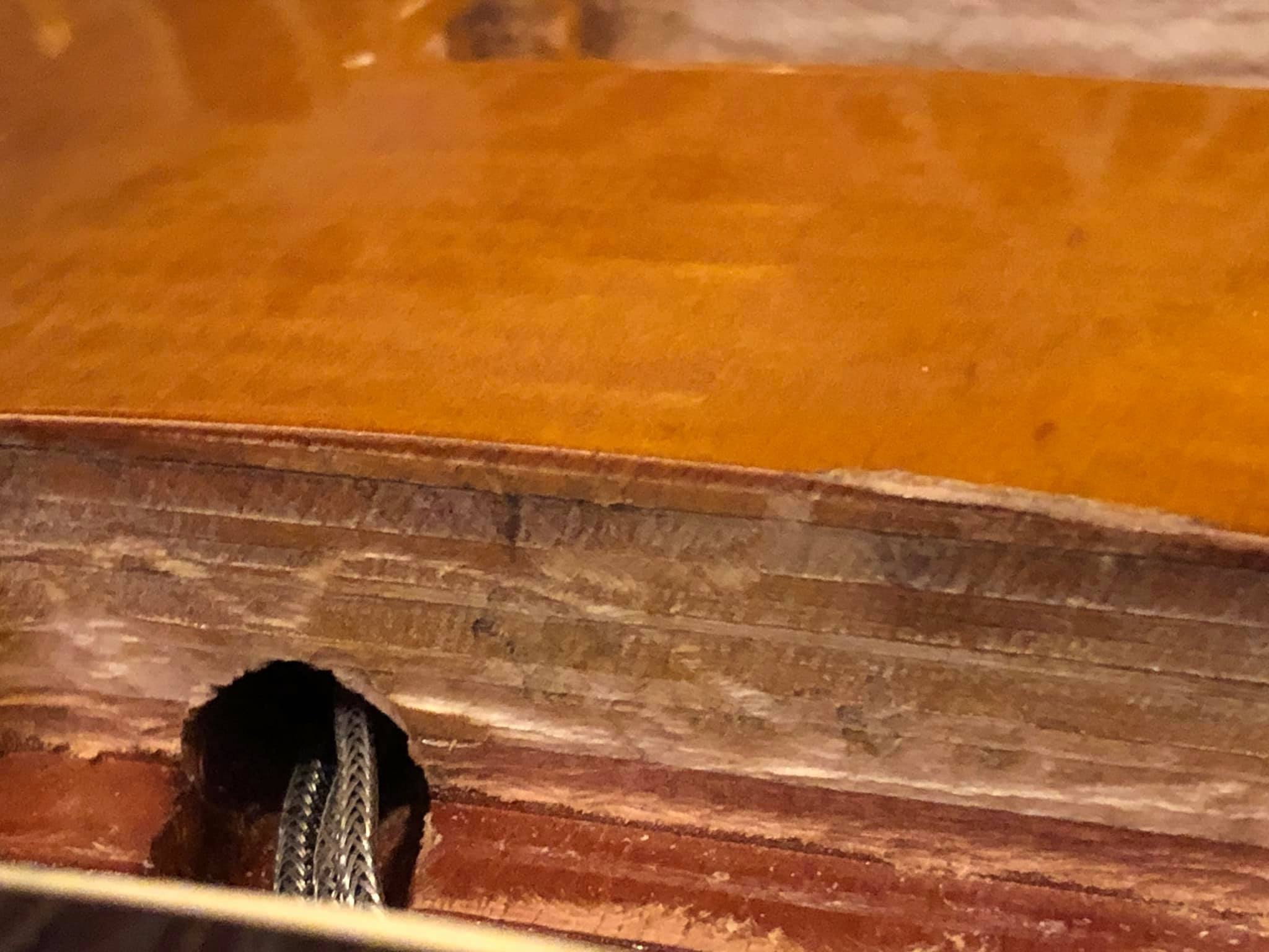

DetroitBlues Posted January 9, 2019 Posted January 9, 2019 Ridiculous debate on Facebook. Is this a fake H150 or simply router marks? I say router marks.
tbonesullivan Posted January 9, 2019 Posted January 9, 2019 It is router marks. It looks like it got cleaned up AFTER paint for some reason. I think I just got blocked/removed from the group because I don't agree with admin "Sam Hedrick" , who has declared in his infinite wisdom that it's definitely a laminate. They have even had logical answers from people who work at Heritage, but he KNOWS. There's also some guy in Poland who KNOWS it's a laminate. That would have to be VOIDLESS laminate, which is not cheap. There's no production time savings from using a laminated maple top.
DetroitBlues Posted January 9, 2019 Author Posted January 9, 2019 I know, I’m probably going to get blocked because I’m losing my cool with Sam myself.
AP515 Posted January 9, 2019 Posted January 9, 2019 Already been answered, but I agree, those are just router marks...
Steiner Posted January 10, 2019 Posted January 10, 2019 Count down the first 4 layers from the top. The top layer is maple. If the next 3 were laminate, at least 1 would be endgrain. Endgrain routers differently from sidegrain. There would be an obvious difference in tooling marks. This looks like there was a template put on the face of the guitar and a flush-trim bit was lowered ~1/4" with successive cuts. Not ply
DetroitBlues Posted January 10, 2019 Author Posted January 10, 2019 Seems I haven’t been banned from the Facebook page, “Heritage Guitar Owners”, the thread was deleted. Guess Sam didn’t like being wrong. Thank you Mr. Steiner for a most excellent explanation!
tbonesullivan Posted January 10, 2019 Posted January 10, 2019 Yeah, I wasn't even getting into the whole "sloppy workmanship" thing. Some were convinced it was a laminate, and the threadstarter was pissed that there was no "official response" to his Facebook thread? He should have talked to his dealer first, and brought it in, before starting a Facebook thread. Then the Admin of the group ran with it, declaring that the whole instrument was laminated, and then veneered. He was also pretty rude to anyone who disagreed with him.

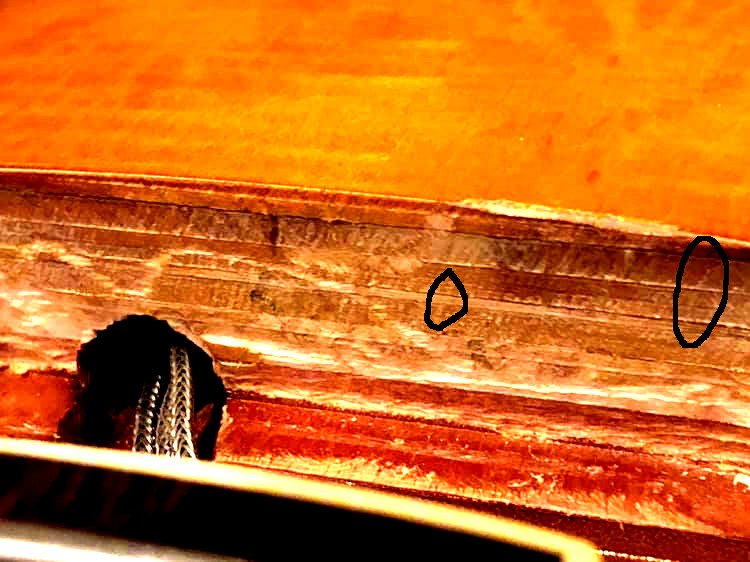

bobmeyrick Posted January 10, 2019 Posted January 10, 2019 I followed that thread with increasing incredulity, noting that at no point was there any mention of how the guitar sounded. I'm guessing a plywood 150 wouldn't sound like a real 150... If you take the photo and increase the contrast, you can more easily see the continuity in the wood between the "layers".
TalismanRich Posted January 10, 2019 Posted January 10, 2019 I had just started reading that thread, and was astonished at the 60+ posts in about 5 hours. Then it disappeared as quickly as it started. There was one picture that I wasn't able to capture which showed the whole routing down to the bottom and you could clearly see 4 or 5 more "laminates" in the mahogany as well. I'm surprised that they didn't claim the whole guitar was a laminate. Clearly it was router marking, but the OP was so convinced that he had been shafted that there was no convincing him (or the moderator) of anything else. Even more amazing to me was the immediate blame placed on the the new "Chinese" owners for cheapening the product. REALLY? The guitar was built two year ago (2016 model), when Plaza was first starting to get involved with the company. Meng wasn't even in the picture then, and he's not Chinese. I guess they don't teach geography anymore. Then the idea that it was the new inexperienced workers that don't know how to build a guitar. That whole episode was in 2018! Its clear that some people will never let facts and knowledge get in the way of a good pissing match. Thankfully the thread was deleted.
tbonesullivan Posted January 10, 2019 Posted January 10, 2019 Actually, the heritage group admin Sam Hedrick did assert that the entire guitar was a laminate, which had been veneered. I also did point out that the striations that went down in the mahogany, but the opposition was already convinced. They also had the heritage shop manager as well as the drill bit supplier commenting that it was due to the type of bit, but no one cared. They already had made up their minds that the entire thing. Then they got accused of being corporate trolls.
DetroitBlues Posted January 10, 2019 Author Posted January 10, 2019 5 hours ago, bobmeyrick said: I followed that thread with increasing incredulity, noting that at no point was there any mention of how the guitar sounded. I'm guessing a plywood 150 wouldn't sound like a real 150... If you take the photo and increase the contrast, you can more easily see the continuity in the wood between the "layers". I stated the same thing... no way that’s laminated because you can match the grains up.
