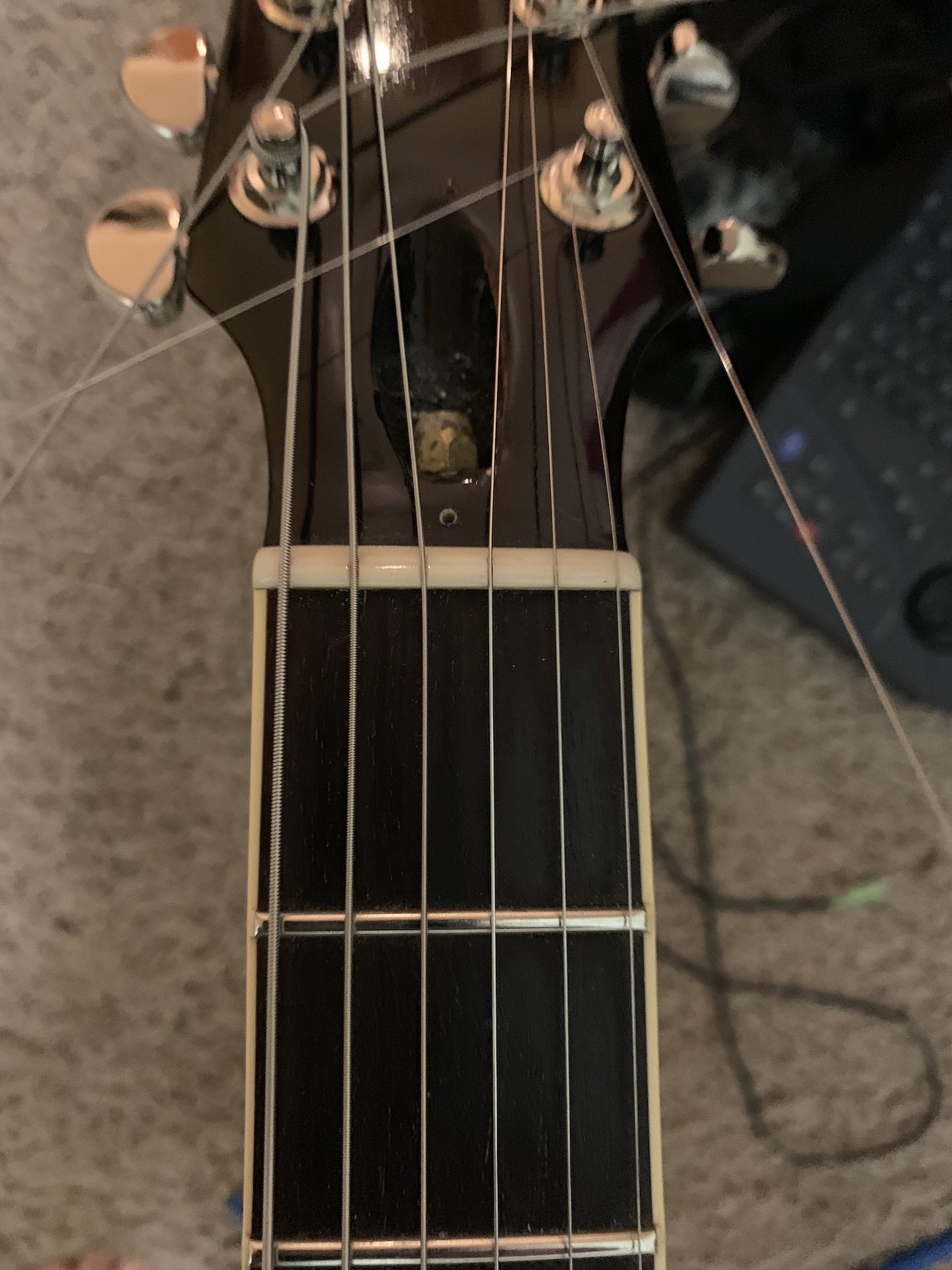

i think the nut spacing looks okay.  see attached pic.
