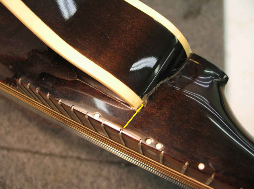

Resophonic Posted August 22, 2019 Author Posted August 22, 2019 Steve Cowles got back to me today, with my feeling around in the neck heel separation using a thin blade and his input, I am convinced that the joint is a tenon. This from Steve: "As to the neck joint, I know that modern Gibson F-5s made here by my dad had tenon necks, and I think so did the Heritage ones. I’m unsure if he was doing that however with his personal builds. I’d have to see a few up close. The easiest way to know on an F style is to see if the portion of the neck that’s over the body is a separate piece of wood or not. Dovetail necks have an extra piece underneath the fingerboard, tenon joints don’t. I drew a line on this one to indicate where that line would be on your mandolin if it were a dovetail" I checked under strong light with magnification, no parting line. The neck and fingerboard extension support are one piece of wood. Removing the finger board in this case would reveal nothing but a continuation of neck wood. The only plausible way I see is to maybe pull this thing apart is to remove the heel cap, drill a hole at a bit of a downward angle, through the heel and into the center of the joint with a heating rod ( https://www.stewmac.com/Luthier_Tools/Tools_by_Job/StewMac_HeatStick_for_Neck_Removal.html ) to soften the glue. This could still be iffy and fraught with problems. My recommendation will be to do some cosmetic work to help hide the neck heel separation and the chipped finish there and then give it a proper set up the way it is. My thanks to those who responded here, for your help and input.

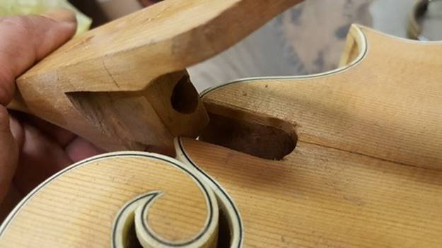

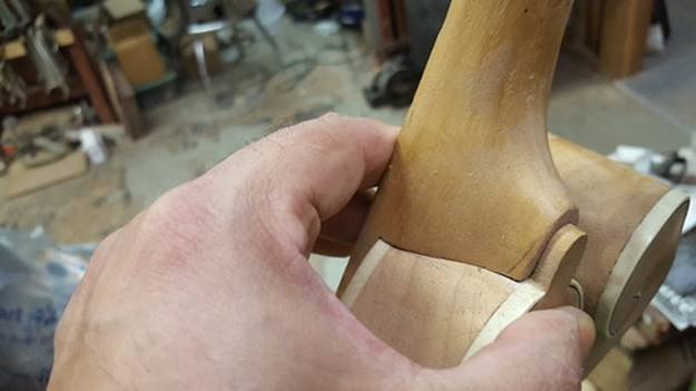

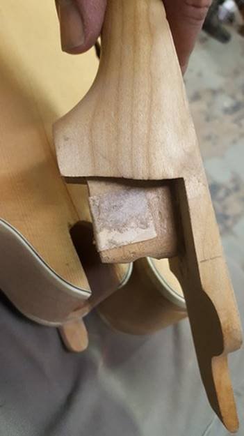

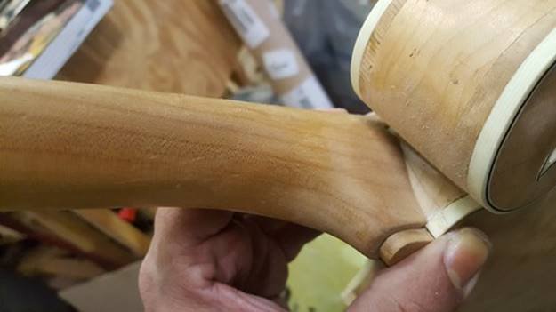

Resophonic Posted August 23, 2019 Author Posted August 23, 2019 Steve Cowles very graciously took the time to send me these images. thought I would also post them here for posterity... An unfinished F model with a tenon joint, either Gibson or Heritage.
