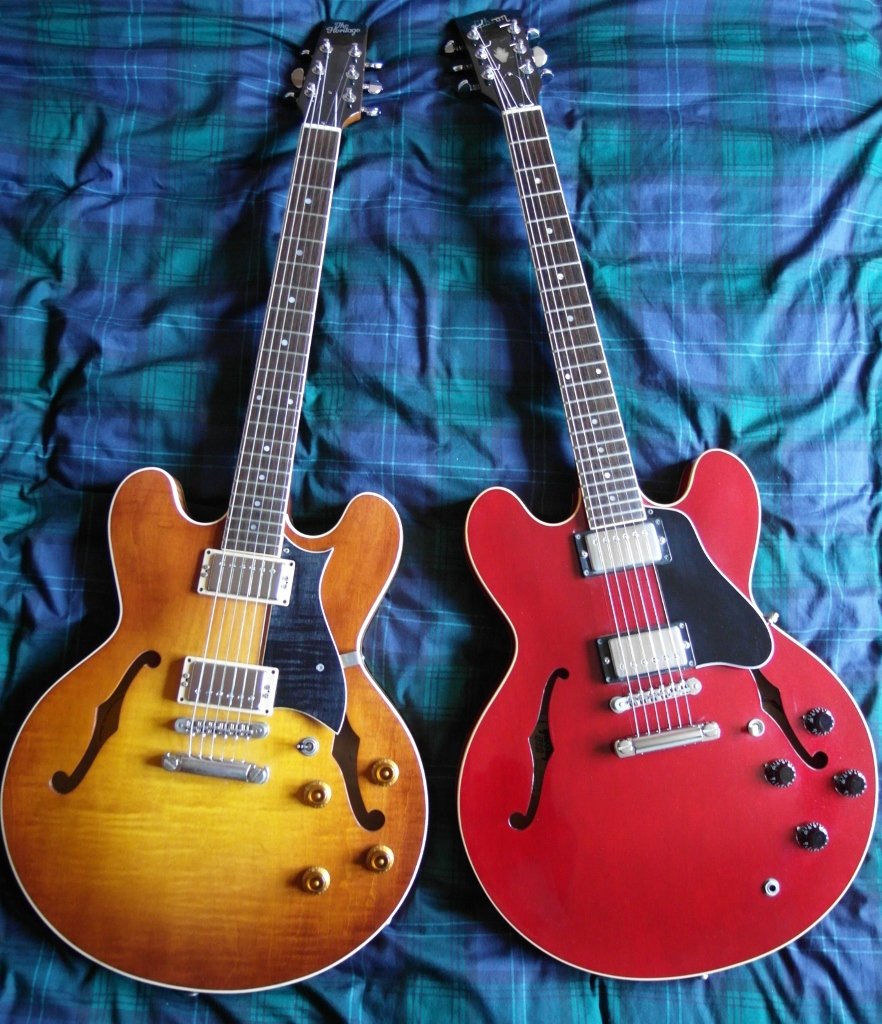

bobmeyrick Posted November 11, 2019 Posted November 11, 2019 I'm not sure the 535 is based on any particular 335, apart from the general principles involved in a semi-hollow guitar. The main difference I noticed is that the neck of the 535 is set back a little further into the body. The depth of the cutaway reached the 21st fret on the 535 and the 22nd fret on the 335. The controls are also positioned slightly differently - the pickup selector switch is a bit further forward, below the bridge, as opposed to below the tailpiece on the 335. The body is also a little bit thinner. Here's a photo to illustrate the subtle differences, my 2007 H535 and 1989 ES335 Dot ...
Gitfiddler Posted November 11, 2019 Posted November 11, 2019 Also, the 535 has 'solid' rims. No 335 has ever had that feature. And one of my favorite differences between the two is that the 535 has the input jack mounted on the rim. I'm not aware of any 335 with a rim mounted jack. My take on it is that the Heritage founders were making subtle changes (improvements?) to what they'd been building for Gibson.

Spectrum13 Posted November 11, 2019 Posted November 11, 2019 The 535 has less real estate from the tailpiece to the rim. Heritage F holes are wider. Due to the neck having more purchase into the body, the bridge is centered to the middle of the F-holes like on most archtops thus the delusion of the control nobs being positioned a little different.
