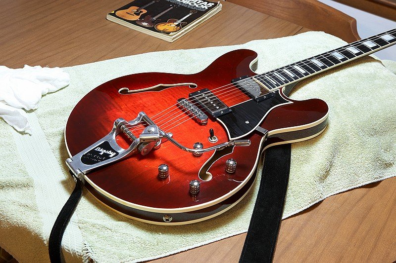

Kuz Posted December 12, 2019 Posted December 12, 2019 It is the first 535 with P90s ever made. Marv's Wine Burst finish (it doesn't have that much red it real life).
rockabilly69 Posted December 13, 2019 Posted December 13, 2019 That's a sweet looking rig Kuz! I especially like the burst and the striped fingerboard!
LeBaron Posted December 13, 2019 Author Posted December 13, 2019 Kuz, Those look like the same Lollars as on my H530. What’s the tone like on the 535? That said, if I were to replace the buckers, it would have to be with bucker size P90s, not dogears.

High Flying Bird Posted December 14, 2019 Posted December 14, 2019 On 12/12/2019 at 4:46 PM, Kuz said: It is the first 535 with P90s ever made. Marv's Wine Burst finish (it doesn't have that much red it real life). Your white balance is off. Lighroom can solve that. Use the white balance tool to select the whitest part of the image. Very nice guitar! ;^)
Kuz Posted December 14, 2019 Posted December 14, 2019 On 12/12/2019 at 11:54 PM, LeBaron said: Kuz, Those look like the same Lollars as on my H530. What’s the tone like on the 535? That said, if I were to replace the buckers, it would have to be with bucker size P90s, not dogears. These are the same Lollar dog ear P90 pups. I am generally not a fan of Lollar P90s (or humbucker pickups really), they are too bright with not enough creamy goodness on the neck nor grind & grunt on the bridge. BUT the Lollar dog ears sound much better. I have really like them in this 535 P90 and a 525 that I used to have. As far as the tone of the 535 P90 guitar it is the best sounding Heritage I own. Big thick, creamy & clear neck, with grunty rock & roll on the bridge that isn't ice picky. Since you have to use humbucker-sized p90ish pickups, I can't promise yours will sound like mine. If I were doing the conversion, I would get Throbak humbucker sized p90s. Bite the bullet on the price and ask for the Heritage Owners Club 20% discount. I love everything that Jon at Throbak does. A cheaper option is Phat-cats which I have heard and they sound good as well.
Kuz Posted December 14, 2019 Posted December 14, 2019 5 hours ago, High Flying Bird said: Your white balance is off. Lighroom can solve that. Use the white balance tool to select the whitest part of the image. Very nice guitar! ;^) Thanks Bird. I know the white balance is off, I am just too lazy to fix it. ha ha
