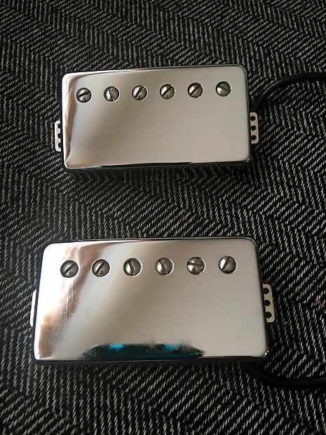

First you have the pickups.  These are magnets surrounded by copper wire and pole pieces.  In Heritage guitars, there are usually 2 larger pickups called Humbuckers.
The one closest to the fretboard is referred at the neck pickup or neck humbucker.

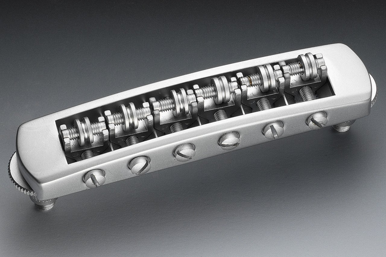

The metal part the strings rest across is the bridge.
The closest pickup to the is called the bridge pickup or bridge humbucker.
On your guitar, you have Humbuckers made by Schaller and a bridge by Schaller.  Often known as a Schaller rolling bridge.
Finally, you have a Schaller Tailpiece on some models the holds the end of the strings on solid or semi-hollow guitars.
https://schaller.info/en/bridges/328/stm?c=52

As DetroitBlues says, the term "humbucker" refers to a type of pickup. A simple electric guitar pickup is a single coil of wire wrapped around a magnet. The vibrating steel strings cause a change in the magnetic field which causes a small electric current to flow in the coil. This tiny current is fed to the amplifier which makes it large enough to drive the loudspeaker.
Single coil pickups can be found on Fender guitars like the Stratocaster and Telecaster. While they work well, there is a problem. Electrical equipment often as stray magnetic fields associated with it, and the coil of wire in the pickup will be affected by these magnetic fields, causing a hum with a frequency of 60Hz (50Hz in the UK). "Hz" is the symbol for "hertz", the unit for vibrations per second. The bottom "E" string on a guitar has a frequency of about 80Hz.
A humbucker pickup has two coils, wired in such a way that the hum picked up by one coil is (mostly) cancelled out by the hum from the other coil. On your guitar the pickups don't have a metal cover, so you can see the two black coils side by side. The position of the pickup affects the tone - the one by the neck will be more mellow with more bass, while the one by the bridge will be brighter with more treble.
As for the "Hannes" bridge, this is a new design from Schaller, different from the ones usually found on Heritage guitars. It isn't a pickup - as DetroitBlues says, it's a support for the strings on the body of the guitar. I think the confusion arose with the term "bridge humbucker", which just means the humbucker next to the bridge. You can see the full range of Schaller bridges here - https://schaller.info/en/bridges/?o=1&p=1
The picture in DetroitBlues' post is the STM bridge fitted to older Heritages (though not yours), while the GTM is the "Nashville" style found on newer guitars (and on yours). Hope that helps.

Bobmeyrick - Bingo! There was definitely confusion going on. "Schaller Humbucker Bridge"... I'm sure thats probably exactly where things went wrong for me. I know the pickups and the bridge, but then I got the humbucker part in the mix and it went south! Quickly. Ha
Thank you for explaining the two coil part of it. This would explain why when I Googled "guitars with 4 pickups" a few days ago (because visually that's what I thought I was seeing, as embarrassing as that is to admit now lol) that it didn't yield the results I expected. You can probably imagine! It was also helpful to know the pic that DetroitBlues showed me has the same double coil as mine, just with a cover. I'm sure it's second nature to all of you here, but it's kind of like opening the hood of 2 totally different cars from 30 years apart and expecting an Amish person, who's never driven a car in their life, to recognize its really all the same stuff. You know what I mean?
