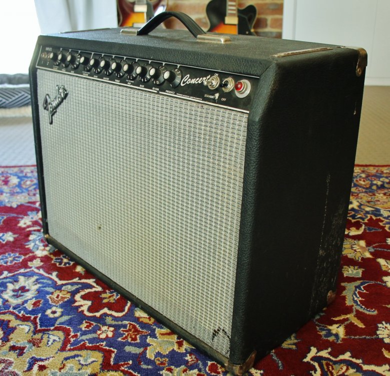

JeffB Posted October 26, 2020 Posted October 26, 2020 I hadnt used the amp for a while, maybe turned it on once every couple of months over 2yrs to see what didnt work on it anymore. Volume cut in and out, got loud, died away. Reverb occasionally worked for about 5seconds. All sorts of glitchy things happening with it as well as scratchy pots. So I took it in expecting a long wait and expense. Couple of hours later all done. DeOxit. Just needed a clean and test. I couldve done that! Why didnt I? I plugged it in and played through it when I got home. Glorious. Deleted all the bookmarks for all the new amps I was looking at. Its really nice to hear its familiar sound again. Question: Ive never cleaned or shined the tolex in 35yrs of owning it, whats the best way to get some shine back into it?
tbonesullivan Posted October 26, 2020 Posted October 26, 2020 Is the tolex still solid and in good condition? If it has started to degrade you can have issues. First I would try cleaning it with a bit of soap and water on a towel. Years of dust/dirt etc may be stuck on the covering. Someone sold me to use Turtle Wax "black ice" on tolex, and it really does the trick, IMHO.
Gitfiddler Posted October 26, 2020 Posted October 26, 2020 Quality liquid black shoe polish can help unless the tolex is ripped or torn. Just mask off the chrome hardware with painter's tape and go for it. That simple process brought this 80's Concert II back to life.
kbp810 Posted October 26, 2020 Posted October 26, 2020 If it's in good shape but just a bit dirty; the soap and water isn't a bad idea to clean dirt, debris, oils, etc... off it. But then I'd recommend following it up with something like 3M leather and vinyl restorer. Or some 303 Aerospace works great on vinyl too, and will restore light fading. I like the black shoe polish idea too, especially if you're got some scuffs or heavy fading.

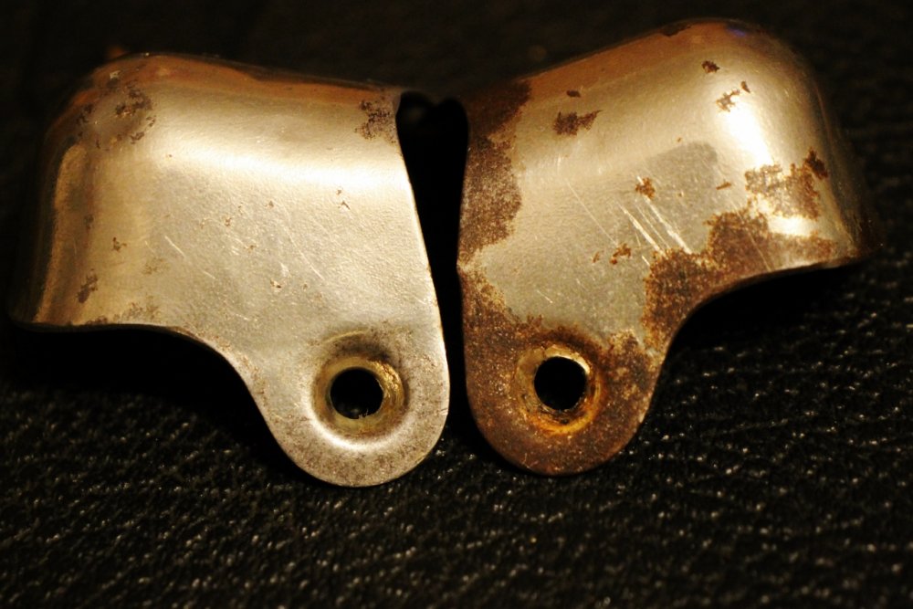

JeffB Posted October 27, 2020 Author Posted October 27, 2020 10 hours ago, Gitfiddler said: Quality liquid black shoe polish can help unless the tolex is ripped or torn. Just mask off the chrome hardware with painter's tape and go for it. That simple process brought this 80's Concert II back to life. Thats the amp. Just not as tidy and nice looking as your one. I think I might replace all the chrome corners and chassis straps, theyre all quite rusty, grill cloth while Im at it. A couple of the knobs are broken so I might replace the whole lot plus the on/off switch.
tbonesullivan Posted October 27, 2020 Posted October 27, 2020 For the hardware, I'd go after them with some Flitz or something similar. They may not be as bad as you think, and you'll never get that patina back.
loudtubeamps Posted October 27, 2020 Posted October 27, 2020 Assuming it's black/brown and not tweed: I've had good results with pro-solve to clean and then armour all to make it shine. Chrome hardware.....0000 steel wool.
JeffB Posted October 27, 2020 Author Posted October 27, 2020 Just discovered what aluminium foil and vinegar can do for chrome! Its not a total refinish but it looks okay. They both looked the same or similar. One has been rubbed with vinegar and ali foil. I'll keep going for awhile and see if it brings it up any better.
tbonesullivan Posted October 27, 2020 Posted October 27, 2020 Just now, JeffB said: Just discovered what aluminium foil and vinegar can do for chrome! Its not a total refinish but it looks okay. They both looked the same or similar. One has been rubbed with vinegar and ali foil. I'll keep going for awhile and see if it brings it up any better. Nice! It really does work well. What you can do is hit them with a bit of the Flitz liquid polish, which has anti-corrosive agents in it. That can help prevent it from happening again. I've gotta take off the hardware and do this exact same thing to the Rivera Pubster I picked up two years ago.

Gitfiddler Posted October 27, 2020 Posted October 27, 2020 16 hours ago, JeffB said: Thats the amp. Just not as tidy and nice looking as your one. I think I might replace all the chrome corners and chassis straps, theyre all quite rusty, grill cloth while Im at it. A couple of the knobs are broken so I might replace the whole lot plus the on/off switch. I really loved that amp. It had the upgraded EV12 speaker and sounded amazing. Unfortunately, after my shoulder surgery it had to go. Too heavy for this aging player.

JeffB Posted October 28, 2020 Author Posted October 28, 2020 List of cleaning products used so far: bicarb/baking soda vinegar aluminium foil. Water. Results. Very good. There are a few little tears. I will touch them up with a soldering iron, or glue and a sharpie.

JeffB Posted October 29, 2020 Author Posted October 29, 2020 Well, I finished cleaning it and put it all back together. LOL! For all that intense focus and activity it still looks like a black and silver box, just a bit cleaner. I dont know what else I was expecting. I just have to replace the two broken dials. Developed a fixation for a 112 big cab Princeton while I was working on this. I dont know if its even a thing. Opening search result tabs now.

tbonesullivan Posted October 29, 2020 Posted October 29, 2020 14 hours ago, JeffB said: Well, I finished cleaning it and put it all back together. LOL! For all that intense focus and activity it still looks like a black and silver box, just a bit cleaner. I dont know what else I was expecting. I just have to replace the two broken dials. Developed a fixation for a 112 big cab Princeton while I was working on this. I dont know if its even a thing. Opening search result tabs now. Yeah, but it definitely Does look a little better. That grille though, eventually it's just gonna fall apart. There is unfortunately no real way to stop those grilles from eventually just disintegrating.
JeffB Posted October 29, 2020 Author Posted October 29, 2020 43 minutes ago, tbonesullivan said: Yeah, but it definitely Does look a little better. That grille though, eventually it's just gonna fall apart. There is unfortunately no real way to stop those grilles from eventually just disintegrating. Yes. It looks much better. I just finished staring at it for a while with a strat. The grill and two broken knobs did detracted from the tone visual experience. Weird, I think Ive become a semi hollow body humbucker guy this time around. Cool.
