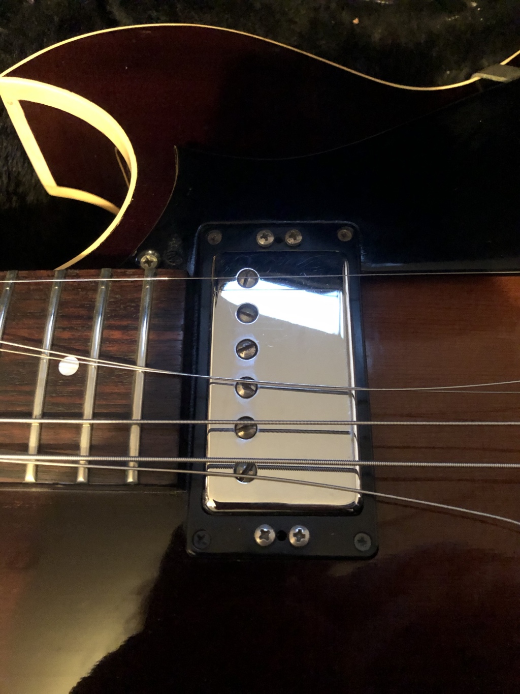

  • Based on serial number it's 2006 – does anyone know what pickup it is likely to have?  I know they changed at some point, but not when.
  • Were/are the single-pickup ones economy versions?  I don't see why they should be but it has an unbound neck which might indicate it is.

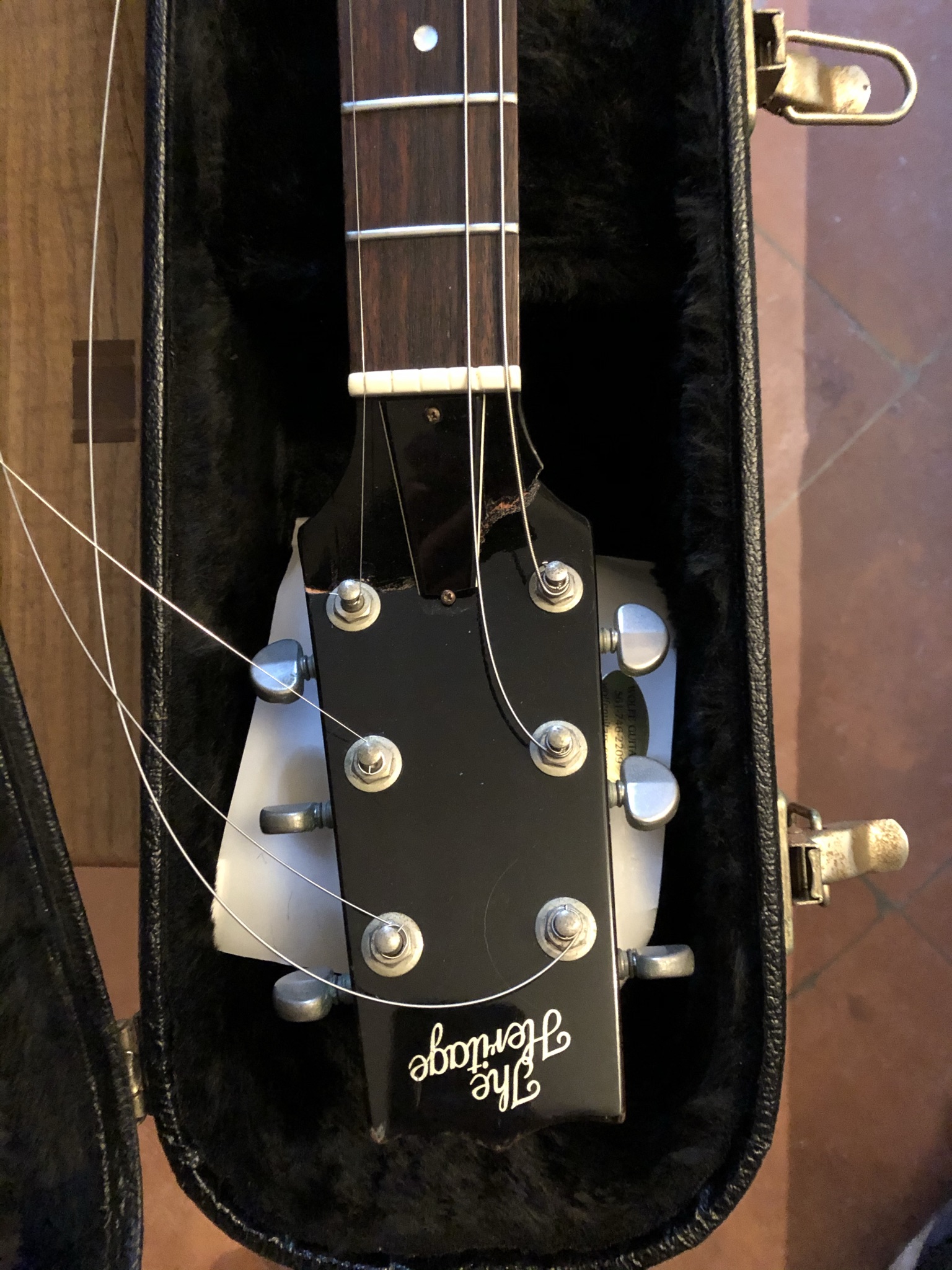

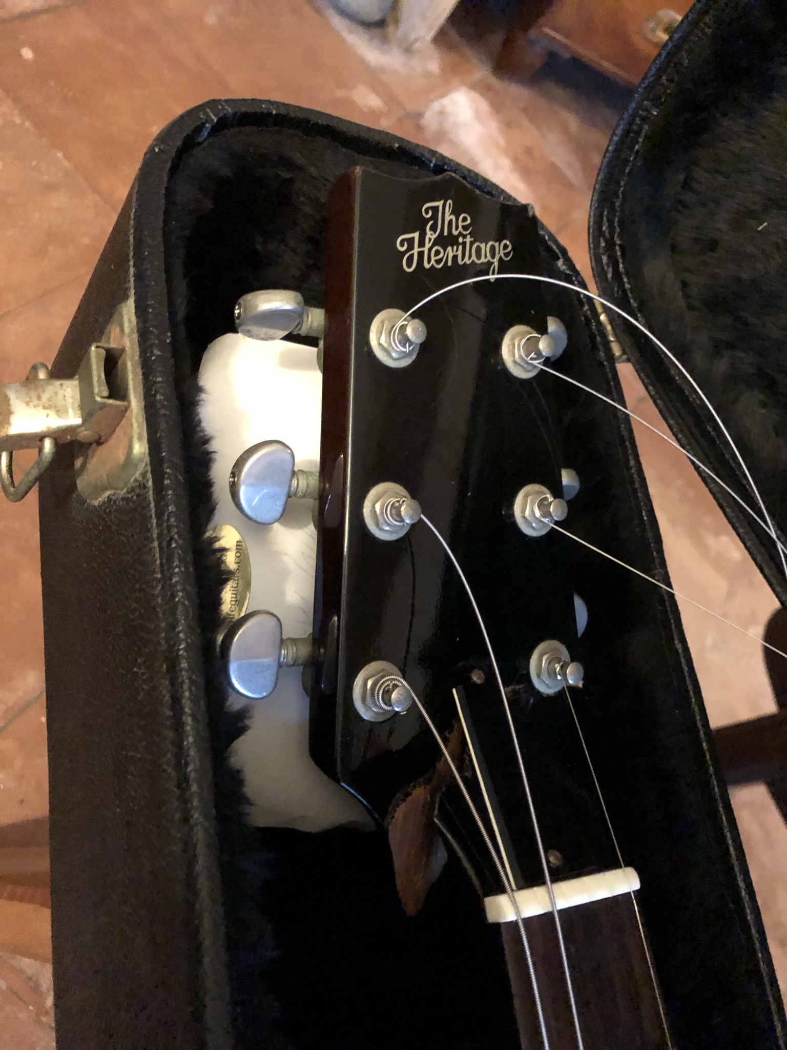

Here are two pictures of the break I took yesterday.  They're limited as I didn't want to take it out of the case or disturb it until/if I've come to an arrangement with the seller.  I stupidly did not take a general picture of it, and it's back in the packing box now to keep it safe.  But it looks generally in good nick ... but who can tell if bracing is loose, say, from outside...

Sounds like a good plan.  Hard to tell from the pics (better to see the actual raw wood at the break), but seems a "good" break for a repair, especially if the wood fibers aren't twisted.  Looks as though the truss rod isn't involved in the break.  Good luck with moving forward.

I'm not sure exactly when Heritage stopped using Schaller pickups, but I believe it was some time in the mid-2000s they switched to Seymour Duncans, so the pickup may originally have been a 59 or Seth Lover.
The unbound neck is standard on a 575 - bound necks would have been a custom option.

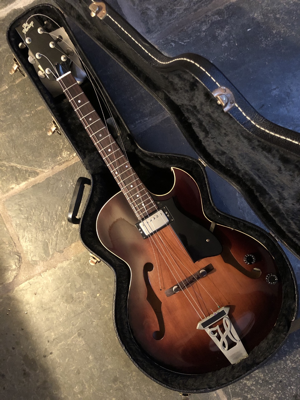

Finally, I took it out of the box again and took a couple of the pictures I should have taken yesterday, still not taking it out of the case so I don't disturb the break more than I have to.  They're below.
wow that is gorgeous!

From the twin adjustment screws on each side of the pickup I would say that it's a Schaller.
Or it could be an HRW - even better!
Could be,my H150 Ultra has HRW's.Of course since this guitar is single pickup there is no selector switch
with the black dot on top to give the game away.

Take a look inside the F-hole and see what the label has written on it.
Single pickup H-575's are a special order.  Also, if the pickup is an HRW it might be indicated on the label.
