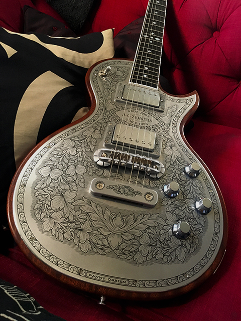

rockabilly69 Posted November 24, 2020 Posted November 24, 2020 6 hours ago, Kuz said: I have been told by several Luthiers that 60 cycle hum can't really be shielded. It is not a ground hum, it is coming from the pickups. They really thought shielding for 60 cycle home was basically useless. Then again, I have bought boutique guitars from luthiers with foil shielding and shielding paint. Again, since the hum is not an issue for me, I don't know if the shielding made any difference. Funny thing Kuz, and some guys aren't going to like what I say, but I've installed shielding kits in some of my guitars where it took some of the magic away from the guitar, as in high end that I previously liked! From here on out, when I do wiring jobs on guitars, I pay very close attention to the solder joints, and keep the leads short on pickups, but other than that no shielding. I have three P90 guitars (1965 ES125, 2010 Historic SG Special, 2019 Historic 1953 reissue Les Paul), and they are fairly quiet, not humbucker quiet, but you know what I mean! The only guitars that I have with shielding in them are my Zemaitis guitars but that is what the metal top on those guitars was designed for.
rwinking Posted November 24, 2020 Author Posted November 24, 2020 21 minutes ago, rockabilly69 said: The only guitars that I have with shielding in them are my Zemaitis guitars but that is what the metal top on those guitars was designed for. I wonder what metal top would look like on my H-137?
rockabilly69 Posted November 24, 2020 Posted November 24, 2020 Just now, rwinking said: I wonder what metal top would look like on my H-137? How handy are you with metal working tools? My girlfriend and I were actually talking about this the other day. She's quite an accomplished artist and I was thinking about having her draw me out me a custom nice looking design for a metal top, which I would cut out, and then etch. Of course I would practice on a bunch of scrap metal before I actually did the real thing. The hardest part I've seen on these tops is the edging work which looks pretty detailed. just imagine trying to do something this detailed...
