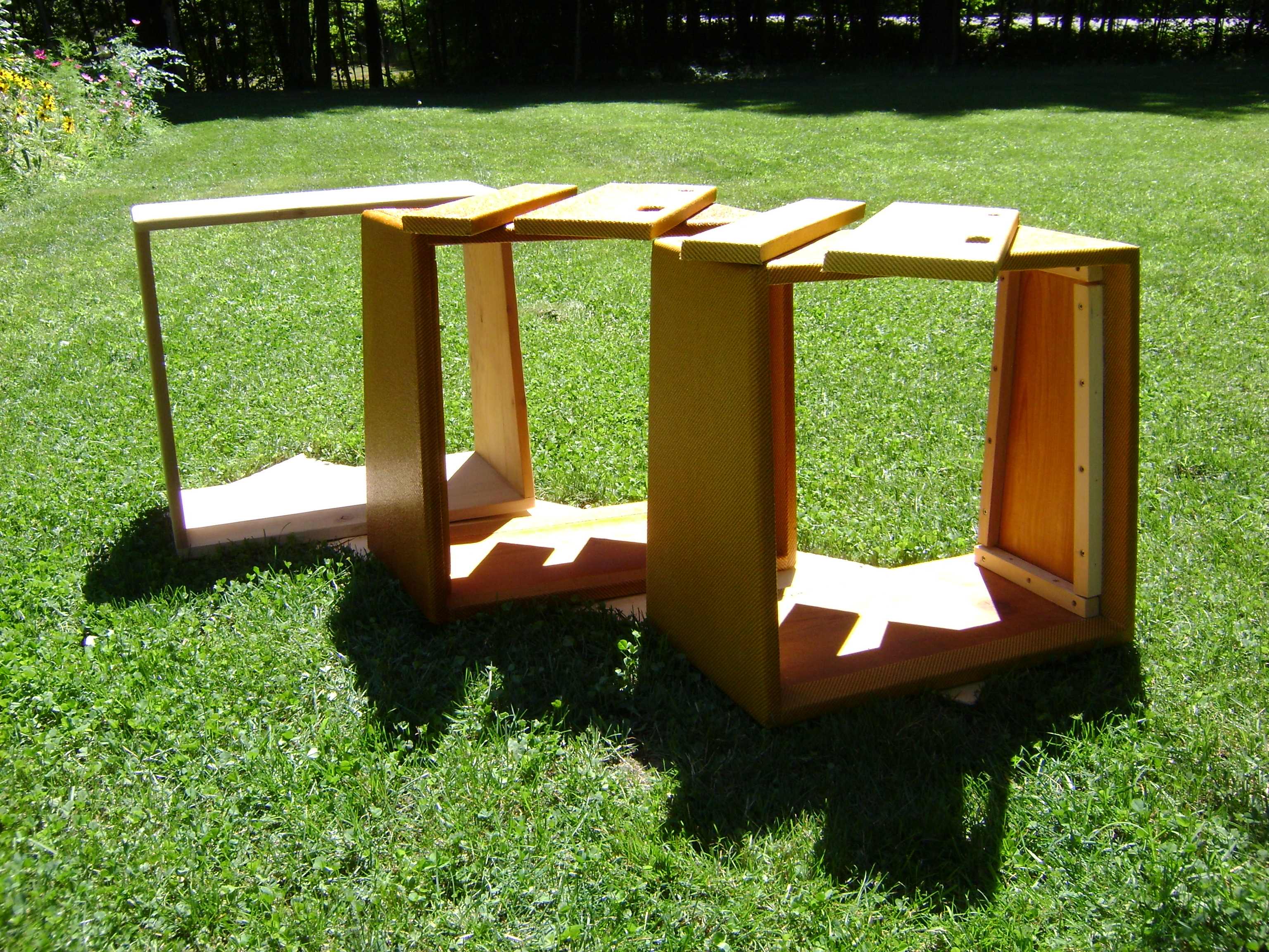

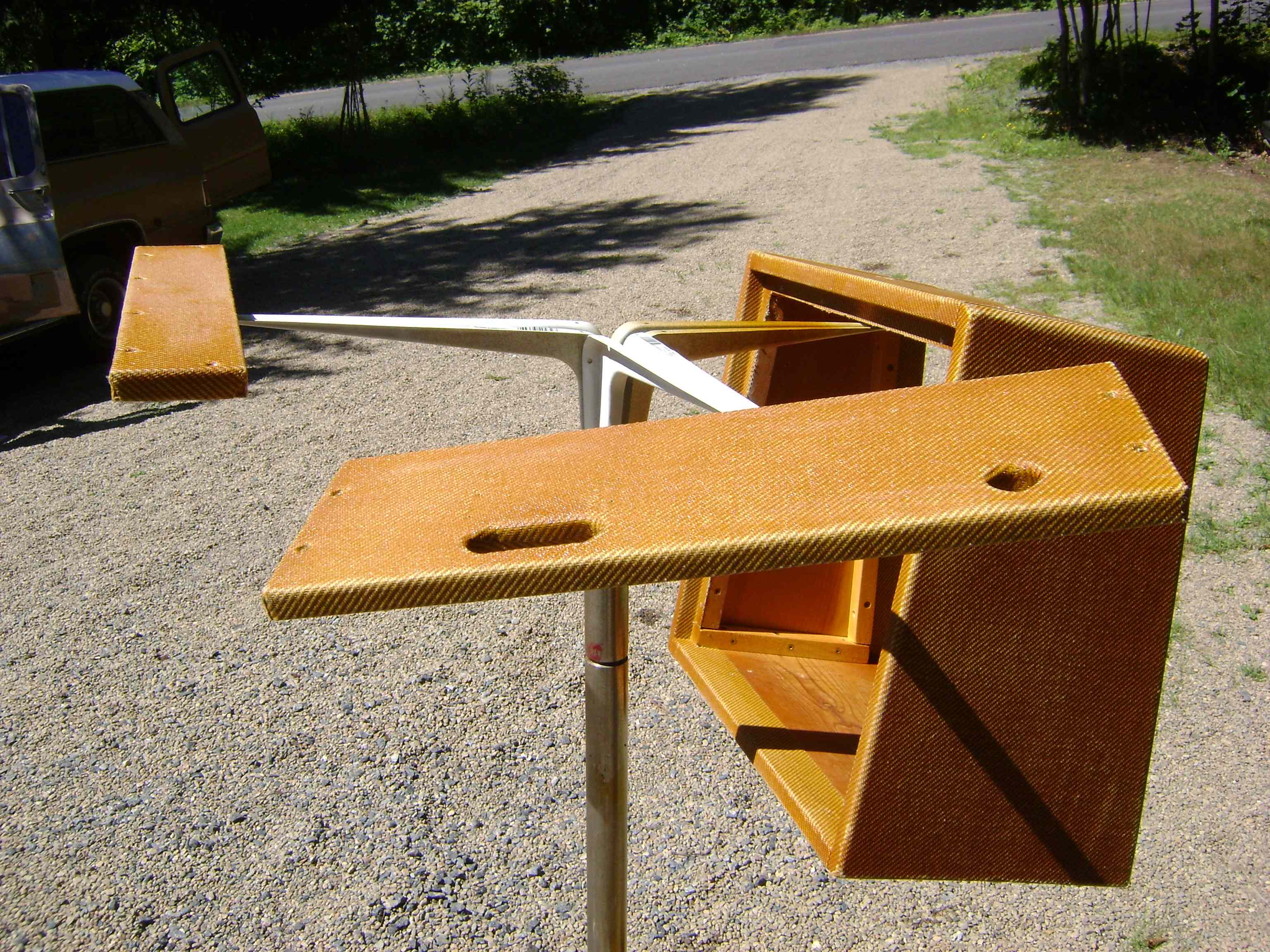

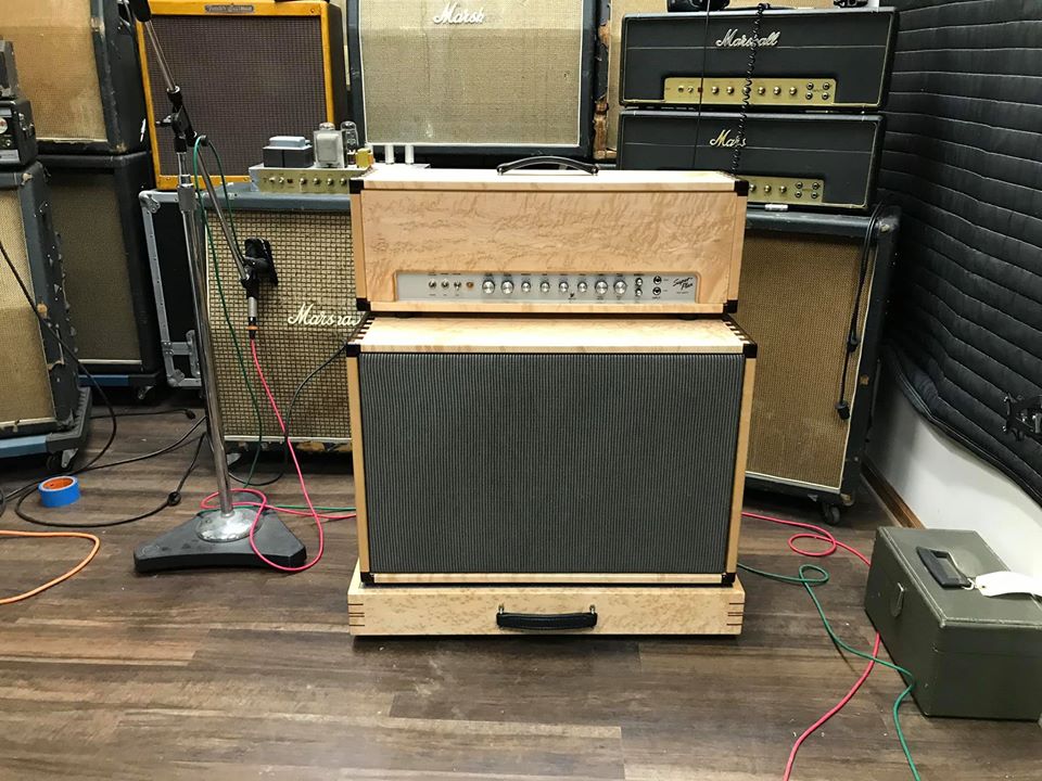

loudtubeamps Posted December 15, 2020 Posted December 15, 2020 On 11/25/2020 at 4:53 PM, rockabilly69 said: As Steiner say's here, keep it simple, go with pine, it's lighter and sounds like a musical instrument. I like using western red cedar...also very light, more stable than pine,very little cupping or warping or bleeding knots and the bonus....it smells great!
rockabilly69 Posted December 15, 2020 Posted December 15, 2020 1 hour ago, loudtubeamps said: I like using western red cedar...also very light, more stable than pine,very little cupping or warping or bleeding knots and the bonus....it smells great! Cedar works for me too.
JeffB Posted December 16, 2020 Author Posted December 16, 2020 5 hours ago, loudtubeamps said: I like using western red cedar...also very light, more stable than pine,very little cupping or warping or bleeding knots and the bonus....it smells great! What kind of joints are you using on these cabs?
rockabilly69 Posted December 16, 2020 Posted December 16, 2020 1 hour ago, JeffB said: What kind of joints are you using on these cabs? looks like a butt and miter joint on top, but I couldn't see that well even blowing them up.
JeffB Posted December 16, 2020 Author Posted December 16, 2020 2 hours ago, rockabilly69 said: looks like a butt and miter joint on top, but I couldn't see that well even blowing them up. Okay! I can see them now. Thanks.
Steiner Posted December 16, 2020 Posted December 16, 2020 If you butt-joint your cab, get a 3/4" or 1" square rectangles, glue and screw them in the corners. Lesson you pick up the cab and watch it fall apart on you!

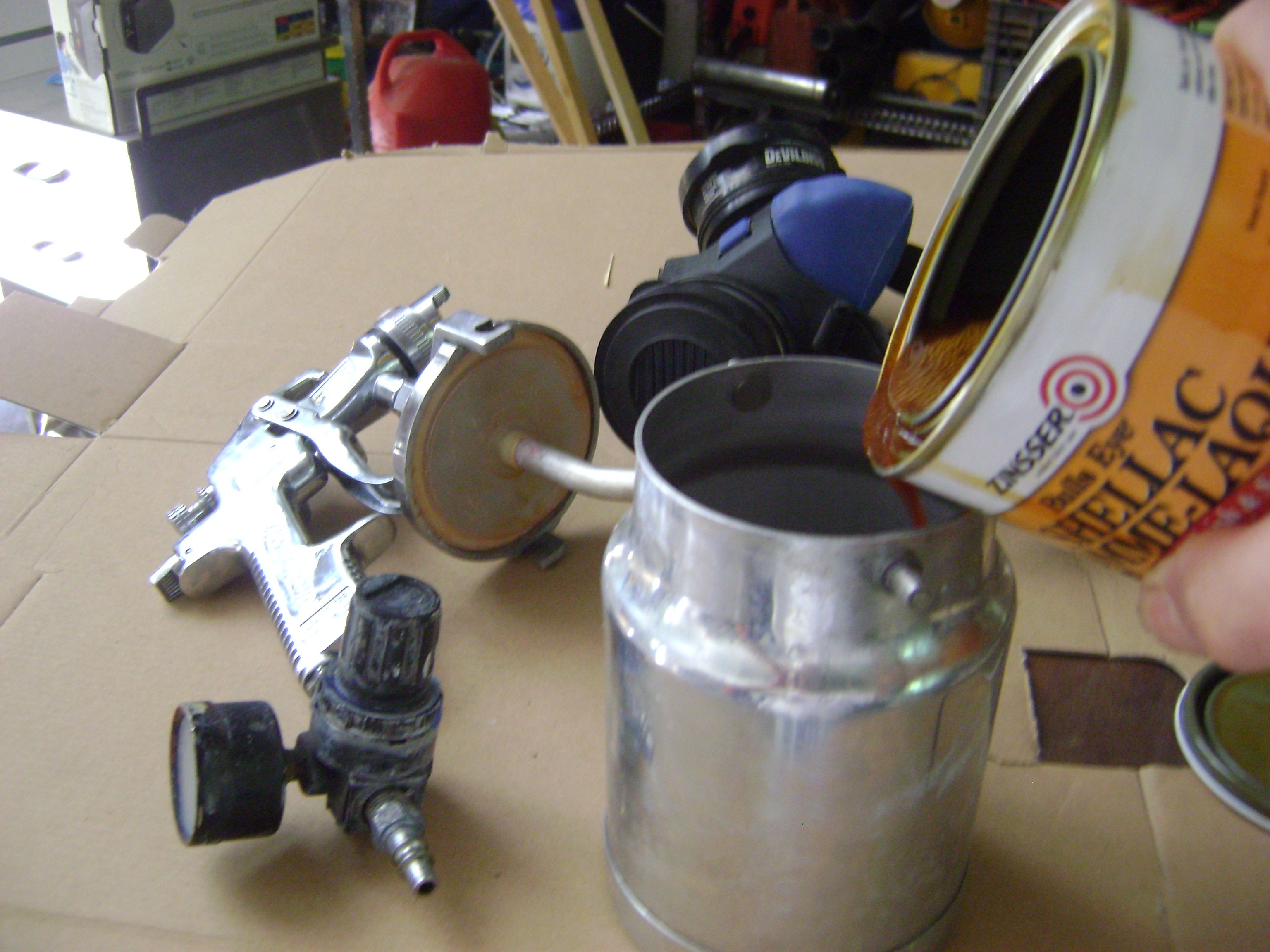

loudtubeamps Posted December 16, 2020 Posted December 16, 2020 11 hours ago, JeffB said: What kind of joints are you using on these cabs? Yup, pretty basic...butt joint , glued and brad nailed. The cleats are then glued and screwed into the top/ sides /bottom from inside and act as bracing as well as fastening surfaces for the baffle and rear cover plates. Once the tolex adhesive has cured, I like to spray about a dozen thin coats of orange shellac to seal the fabric.
loudtubeamps Posted December 16, 2020 Posted December 16, 2020 4 hours ago, JeffB said: Looks great! Nice work. thanks JeffB...sorry to derail your post!
JeffB Posted December 17, 2020 Author Posted December 17, 2020 3 hours ago, loudtubeamps said: thanks JeffB...sorry to derail your post! Im open to derailment. I dont feel like you went off topic at all, I think your posts added to the conversation.

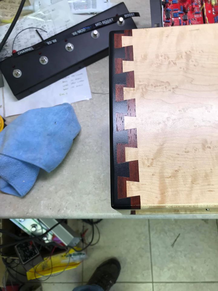

JeffB Posted December 30, 2020 Author Posted December 30, 2020 Ive been playing around with cab design and ideas. Also playing around in the workshop with joints, dovetails, box, tongue and groove, etc. Decided Im going to go the mesa way and go with half blind dovetails. For no other reason than I think they look great, when done right. I think I can do it right, dunno, guess I will find out. Probably buy a jig. I did a few mock-ups of different joints and really only liked the look of the tongue and groove butt joint or the half blind dove tail. The half blind dove tail just seems to be the one that addresses a lot of other considerations and also appeals visually. Right now Im stuck between head and cab or combo. A head and cab is always more useful but a combo is half the work. Going to do a first run in pine but I have some Tasmanian Oak and Blackwood stored away from a few renovations I over ordered on about 20yrs ago. Should be dry by now. Cant start proper until mid/late January. It will give me time to settle on cab design etc. Really, at the core its only one or two boxes.
Steiner Posted December 30, 2020 Posted December 30, 2020 Dovetails are gorgeous! There's one reason for their unique look; they are an absolute terror to create. Precision is key, you'll want a commercial jig. Even then watch out! The first jig I used took days to tune in the bit height. 0.001" height difference is enough to change a tight fit to a sloppy fit. Too loose with the router collet and the bit will move, too tight and the collet will fail; you need to be right in the sweet spot (i.e., experience). I also learned - the hard way - that the pressure you place on the router will change the joint's fit. IIRC, you worked in home remodeling so I won't go into keeping track of datums and making crisp, orthogonal cuts. Finger joints are much easier but have their own setbacks. They can be made on a home-made jig and with less expensive tooling plus can be formed with a "safety" factor to insure a good outcome. If you use pine, make sure it's OLD! Pine (a four letter word in my vernacular) has a tendency to load up on tooling which changes dimensions and burns! When you work it, it smells like PineSol, uck... The end result is well worth the journey. The effort will stay with you the rest of your life.
JeffB Posted December 30, 2020 Author Posted December 30, 2020 Thats great work! Beautiful. I'll probably be bothering you for advice and ideas etc Im not anywhere near that level yet, not in conceptualisation or execution. Im going to do the prototype in pine because its cheap and I feel like I can practice without being too precious about wastage. I have old bench, table and drop saws from a previous life as well as router table and drill press etc but I havent really used any of it since around 2000. Even then it wasnt used to its full capacity since 1994. Ive been testing out, buying new blades and bits and fixing stops and clamps etc for the last month. Its all older stuff, a cordless Dewalt compound mitre drop saw I bought recently has more power than an old Elu mains powered drop saw it replaced. Comparing powered vs newer battery planer, saws and drills I have Im surprised by how gutless some of my old power tools are. I have to buy one new router to replace one Ive had for about 30yrs. It works but parts to set and lock it are broken and they dont make that model any more. Im not looking at this as a one off thing, more of an ongoing interest/hobby. Im not sure whether to buy a dovetail jig for the router table or a free standing dove tail jig. Other projects in mind dont require dovetails so Im not even sure of price point cut off yet. I was watching some vids and reading some reviews of some quite cheap free standing dovetail jigs and the finished products I saw were not terrible. Anyway, its all stuff to ponder and fill my head with, so thats good. I wouldnt mind starting tomorrow but I have stuff to do before I can get into it. I have a one track mind and once I start doing a new thing everything else goes out the window, Im trying to break that and learn patience, or something.
