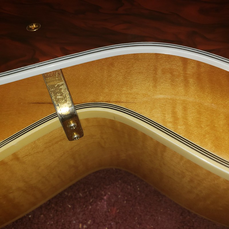

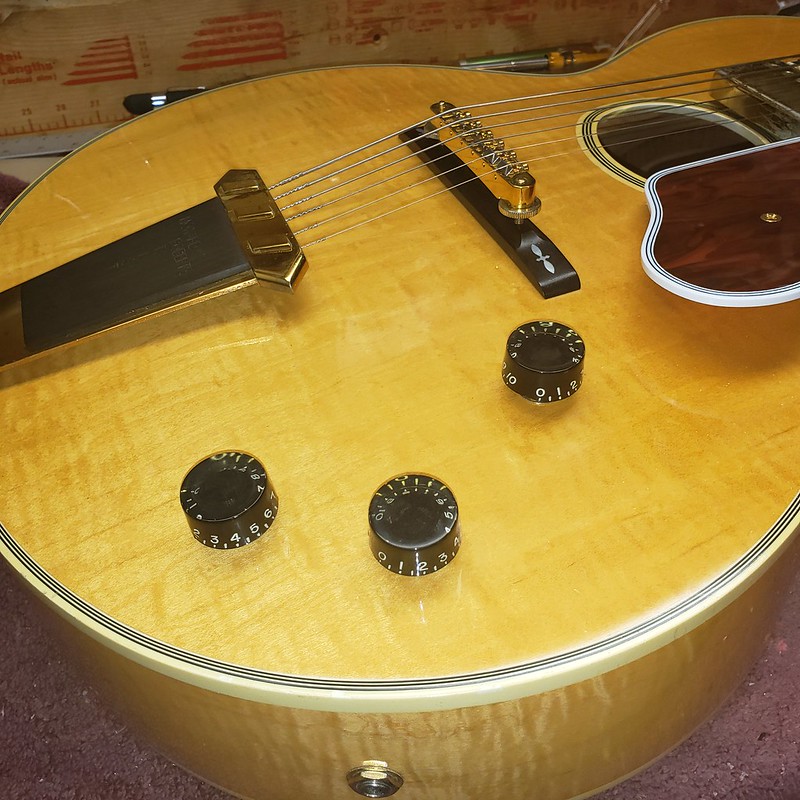

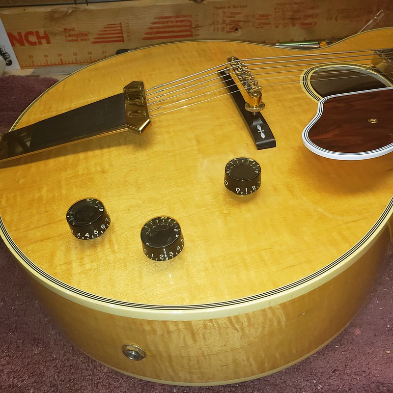

Here are pics of a mid 1970s laminate Gibbons archtop that was gigged a lot in Pennsylvania. Temperature and humidity swings were unavoidable. The guitar survived well and is a gem. Some exposure effects are visible though. It's been refretted and has a new pickguard but plays like new.
These pics show lacquer checking on the top with dirt and oxidation in the checks. It looks like the wood might be cracked, but it isn't. The bracing is unscathed. The neck is perfectly straight.
Here are the effects of necessary exposure in a working guitar over a more than 40 year period in a highly variable climate. The instrument held up very well. It should last another 40 or more.

What kind of Gibbons arch top is that with the round whole?
Howard Roberts or old L4 would be my guess
Howard Roberts Artist.  These were built with a L-4 body except the top.  It's a laminate.  The top has unique bracing for Howard Roberts' tone.  The pickup is mounted to the neck like a Johnny Smith and was designed by the famous Bill Lawrence, who worked for Gibbons at the time.  The circuit includes a pot to dial in a midrange cut.  The neck is 25.5" and has 22 frets and is multipiece maple.  The fretboard in ebony.
