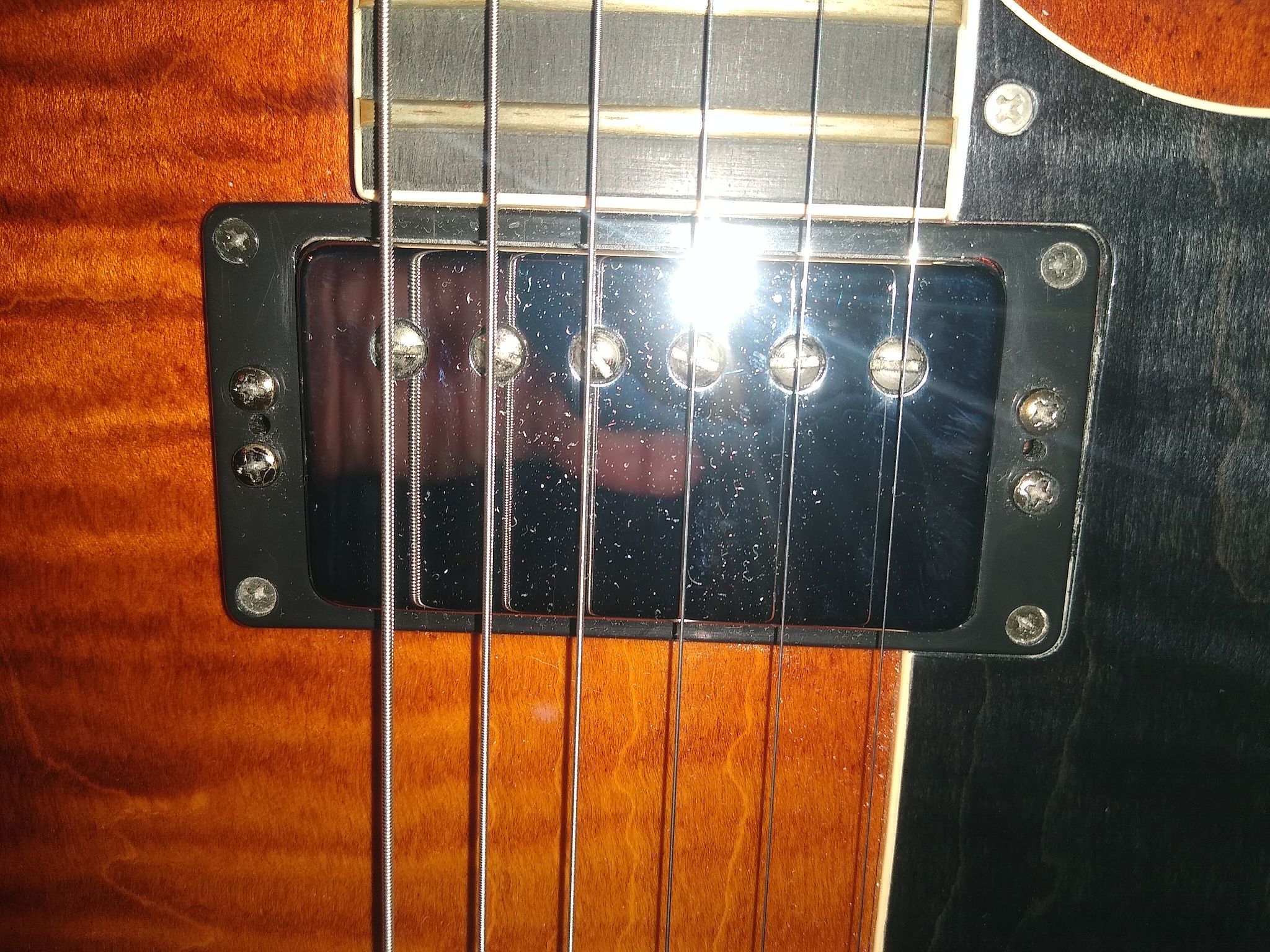

Mike535 Posted December 14, 2020 Posted December 14, 2020 Checking PU heights on a 2001 Heritage 535. Assuming the PUs are PAF style Schaller Golden 50's. There are 2 screws on each side of the PUs. I can't find an explanation or diagram anywhere on how they function. Any insight is appreciated, Thanks.
loudtubeamps Posted December 14, 2020 Posted December 14, 2020 The 2 per side was designed to allow for a bit of tilt to align the pups parallel to the strings. I found one per side in opposite holes works better.
Mike535 Posted December 15, 2020 Author Posted December 15, 2020 Thanks loudtubeapms. Image added. Guessing one is for tilt the other for height.
DetroitBlues Posted December 16, 2020 Posted December 16, 2020 Pickup height is to taste. While there are recommendations from manufactures, its all about adjusting them to where the pickups sound right to you. As far as the double adjustment screws, its meant to counter this design flaw to have a more balanced pickup to string alignment.
loudtubeamps Posted December 16, 2020 Posted December 16, 2020 17 hours ago, Mike535 said: Thanks loudtubeapms. Image added. Guessing one is for tilt the other for height. Both actually....Once you start adjusting you will notice the correlation between height and pickup angle and as DetroitBlues suggested...height is to taste. A good starting point that works for me is to depress the string(s) at the last/ highest fret, adjust pickup height as high as possible without the strings physically touching the pickups and then lower to suit you tonal taste. Some like the bridge pickup higher/hotter , I prefer a good output balance between the neck and bridge but again it's all about what sounds best to you. Cheers...
