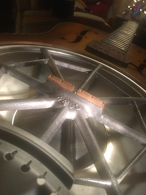

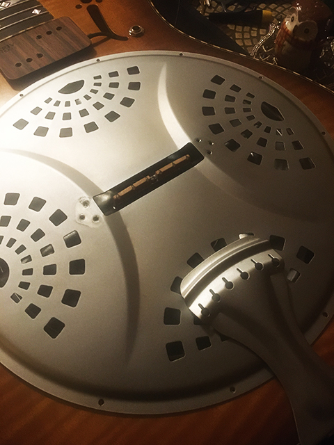

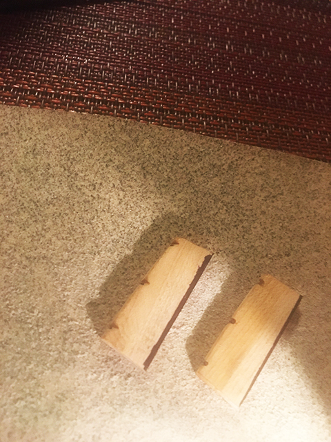

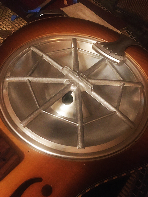

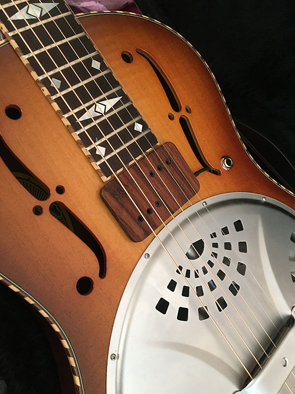

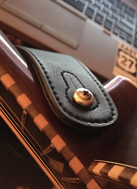

rockabilly69 Posted January 19, 2021 Posted January 19, 2021 I've decided that I want to play my National Western D Resophonic guitar at gigs. This was a very expensive guitar that my girlfriend gave me as a gift many years ago, so I babied it, but lately. I've been loving the sound so much, and hell I'm not getting any younger, so this week I gave it some love and prepped it for some serious gigging. I lowered the action by removing the 2 piece maple saddles and sanding the lower from the bottom, and after installing I radiused the saddles better. I adjusted the truss rod, to balanced out the playing height. I added a strap button, and installed a Krivo Magnetic pickup (it already had a Highlander Active Cone pickup system in it). It was always a great slide guitar, but now it plays great for fingerstyle too! An having a dual source pickup system is great. I can distort the hell out of the magnetic pickup, while still having a clean cone tone! Removed the saddles Marked them for sanding Reinstalled saddles Renistalled cover-plate and adjusted saddle tension Added Strap Button

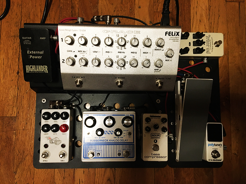

rockabilly69 Posted January 19, 2021 Author Posted January 19, 2021 None invasive magnetic pickup mount, The Krivo is held on with adhesive putty, and I used the F hole for it's output jack... The pedalboard allows me to use the distortion for just the magnetic pickup, power the internal cone preamp, and use compression and timebased FX on both channels!
rwinking Posted January 19, 2021 Posted January 19, 2021 Cool! How are you liking the Grace Felix? I got one last year and was really getting into it and then Covid hit. It is probably the coolest acoustic pre ever and I'll bet it sounds stunning with the National.

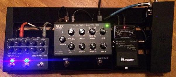

rockabilly69 Posted January 19, 2021 Author Posted January 19, 2021 On 1/19/2021 at 4:26 PM, rwinking said: Cool! How are you liking the Grace Felix? I got one last year and was really getting into it and then Covid hit. It is probably the coolest acoustic pre ever and I'll bet it sounds stunning with the National. Expand I've been a big fan of Grace preamps, as I've been using my Grace Alix non-stop for the past two years, and frankly for single channel stuff I think it's the best acoustic preamp made. That's why I bought the Felix so I could have two channels of the preamp for my reso shows. I've got three National resonators with two pickups in them each. This is all I need for my day to day work, volume, tuner, Grace, reverb/delay...

rwinking Posted January 21, 2021 Posted January 21, 2021 Same here...I think I spoke with you about this once. I use a Dimarzio Black angel split into the Felix orI also have a K&K piezo with a black angel or sunrise split. It is so nice on the grace to be able to eq each side from one preamp! Larry Dimarzio used the Grace at NAMM a few years ago to demo his acoustic pickups and people loved the sound.
rockabilly69 Posted January 21, 2021 Author Posted January 21, 2021 On 1/21/2021 at 12:57 AM, rwinking said: Same here...I think I spoke with you about this once. I use a Dimarzio Black angel split into the Felix orI also have a K&K piezo with a black angel or sunrise split. It is so nice on the grace to be able to eq each side from one preamp! Larry Dimarzio used the Grace at NAMM a few years ago to demo his acoustic pickups and people loved the sound. Expand Yeah the Grace pres work with any pickup I plug into it! Including this one... https://www.dimarzio.com/artists/daniel-weldon
bolero Posted January 23, 2021 Posted January 23, 2021 thx for the pics! have never seen underneath the reso before, interesting!
rockabilly69 Posted January 23, 2021 Author Posted January 23, 2021 On 1/23/2021 at 2:56 AM, bolero said: thx for the pics! have never seen underneath the reso before, interesting! Expand Tricones look even more weird
Gianluca Posted January 23, 2021 Posted January 23, 2021 very nice and interesting I wonder how that Rubberneck works with it (one of my favs analog pedals)
rockabilly69 Posted January 24, 2021 Author Posted January 24, 2021 On 1/23/2021 at 7:11 PM, Gianluca said: very nice and interesting I wonder how that Rubberneck works with it (one of my favs analog pedals) Expand It works great. I auditioned many pedals before I put that grouping together, and only the good ones made the cut. I wasn't looking for pristine clean style repeats. I mostly use the delay for dirty style repeats with the Fab Suisse Overdrive. I control how hard I hit the delay with the compressor in front of it. And I smooth the tails with the JHS Spring Tank.
Gianluca Posted January 31, 2021 Posted January 31, 2021 On 1/24/2021 at 7:25 AM, rockabilly69 said: It works great. I auditioned many pedals before I put that grouping together, and only the good ones made the cut. I wasn't looking for pristine clean style repeats. I mostly use the delay for dirty style repeats with the Fab Suisse Overdrive. I control how hard I hit the delay with the compressor in front of it. And I smooth the tails with the JHS Spring Tank. Expand sounds interesting, thanks for the explanation and enjoy it :-)
rockabilly69 Posted January 31, 2021 Author Posted January 31, 2021 On 1/31/2021 at 7:29 PM, Gianluca said: sounds interesting, thanks for the explanation and enjoy it :-) Expand I'm actually using this pedal board today for (3) 45 minute sets where I will be using my resonator for 1 of those sets.
