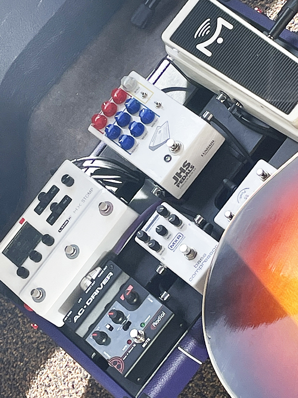

rockabilly69 Posted February 19, 2021 Posted February 19, 2021 Last week I finished up my pedal board for my dual pickup National resonators, and then I started building a new daily gigging board. I wanted a board with presets for my songs, but I wanted something with a good analog front end. I tested the guts of it today (the JHS Colour Box, the MXR comp, and the HX Stomp), and it sounded great. I'm just waiting for a special cable for the AC DRIVER DI (for XLR balanced out, and to isolate the 48 Volt Phantom power), and a new Xotic Volume pedal (Xotic XVP-25K).

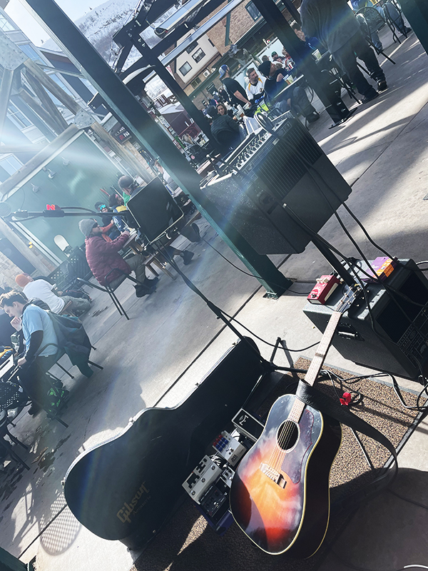

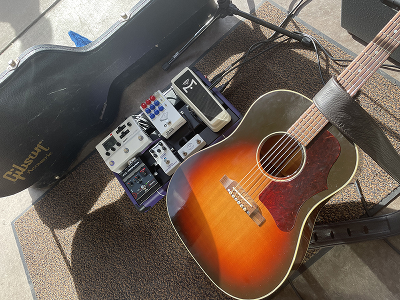

rockabilly69 Posted March 7, 2021 Author Posted March 7, 2021 Finally got a few gigs under my belt with this new pedal board. First day SUCKED, all the presets I made didn't translate at stage volume, I wound up putting the HX stomp on bypass until I could take a break and pull back the mix levels on the trem/delays/reverbs. I also had the input level on the compressor too hot, and it was killing my dynamics. And the volume pedal was cutting out at the top of its travel. I found out that I had to hit an internal switch while using my active pickup equipped acoustic. Got that figured out, and by the end of the gig, I had a few reasonably good sounding presets in the HX Stomp. The next day I did two two gigs, and they were a total 180. Every preset sounded great, and compressor really shined. My ears were telling me the metering wasn't quite as fast as the actual compression, so I adjusted accordingly, and now the compressor is really getting the job done, slightly fatting up my tone, and keeping check on my heavy-handed-ness. And today I did two more gigs and by the end of these two gigs I was programming on the fly! Nothing like babtism by fire. Here's some shots from today's outdoor gig...
