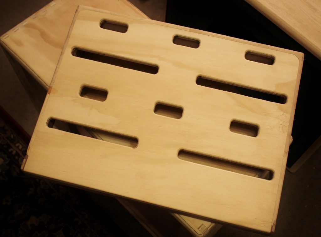

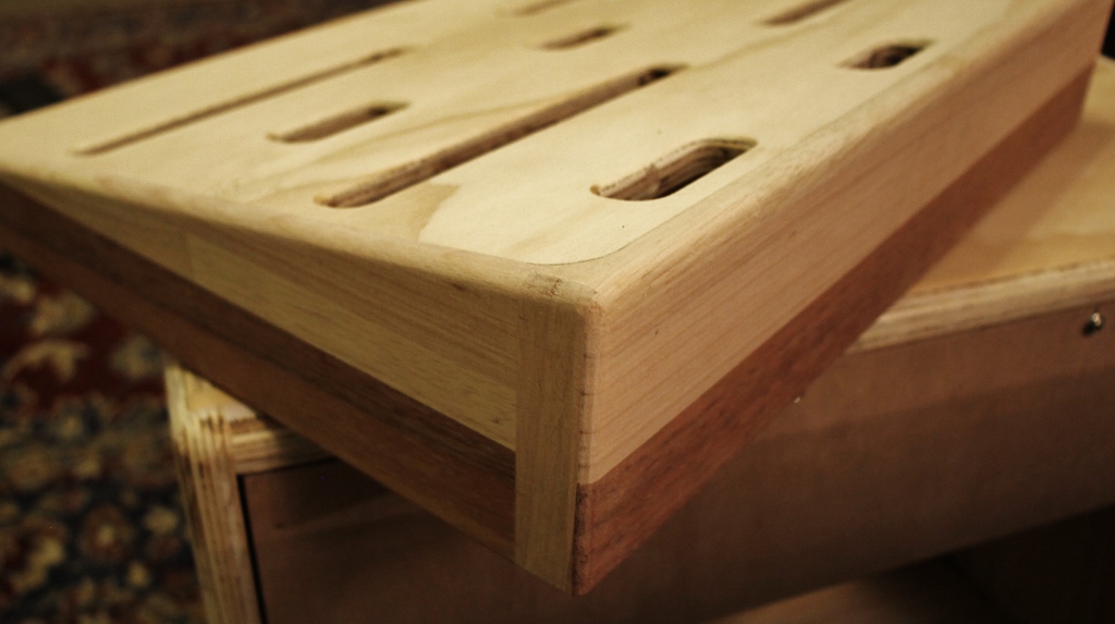

JeffB Posted March 2, 2021 Posted March 2, 2021 New project. Just a prototype. I think the next one is going to be even faster. I have to finish this one and apply clear coat or some sort of finish. I made so many mistakes trying to get this thing together. I kept trying to fix them by making them into features, and then I would make a mistake of the feature. I did learn a lot.
rockabilly69 Posted March 2, 2021 Posted March 2, 2021 That looks great Jeff, the design is very similar in to the pedal board that I just bought, which I really like, although the one I bought (besides being tolexed with metal corners), has the top panel as a separate piece that's screwed to the bottom frame. The holes in you top deck look like they are in the perfect place for wiring.

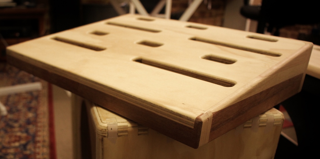

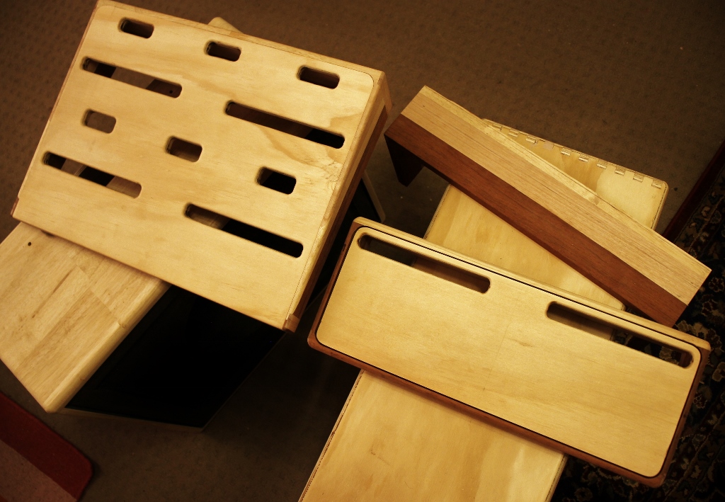

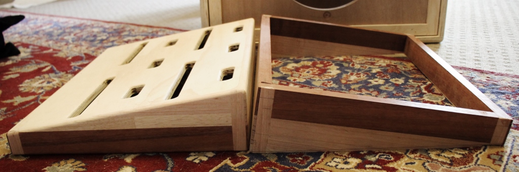

JeffB Posted March 3, 2021 Author Posted March 3, 2021 7 hours ago, rockabilly69 said: That looks great Jeff, the design is very similar in to the pedal board that I just bought, which I really like, although the one I bought (besides being tolexed with metal corners), has the top panel as a separate piece that's screwed to the bottom frame. The holes in you top deck look like they are in the perfect place for wiring. Thanks. When I started on this you posted your thread on your acoustic pedal board and I asked about it there. I made this out of off cuts from other projects. Bits of jarrah, Tasmanian oak(trade name for various species) and hevea. Basically glued bits of off cuts together into panels and then cut the panels to size and made a box, then run the saw through the box and ended up with two wedge/pedal board shaped items. You have a choice of two profiles, 90degree to the floor front and back or 10'ish degree to the floor....I will post a pic, it will be easier The second option is probably the easier option for installing the deck and is the one Im doing now. Im going to tolex it and add corner brackets to match a fender amp. That Samp pedal board you posted is what inspired me to pick up the pedal board shaped item on my work bench and turn it over. I used pedals I have and averaged out the input and outputs and power inputs. I think rather than having the three smaller holes second row and top row I will go two larger slots and center hole, I have a lot of pedals that I actually use on my board with top mounted jacks.

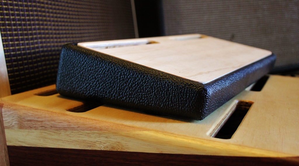

JeffB Posted March 7, 2021 Author Posted March 7, 2021 Turns out you can make one larger wedge into multiple smaller wedges! Im going to tolex the smaller wedge. Wasnt until I finished rebating the wedge and rounding the corners of the deck that I realised I had made a rod for a newb tolexers back. I think it might have created a problem for myself.
rockabilly69 Posted March 7, 2021 Posted March 7, 2021 5 hours ago, JeffB said: Turns out you can make one larger wedge into multiple smaller wedges! Im going to tolex the smaller wedge. Wasnt until I finished rebating the wedge and rounding the corners of the deck that I realised I had made a rod for a newb tolexers back. I think it might have created a problem for myself. That small board looks cool! Can't wait to see how your tolexing comes out! Good luck!!!

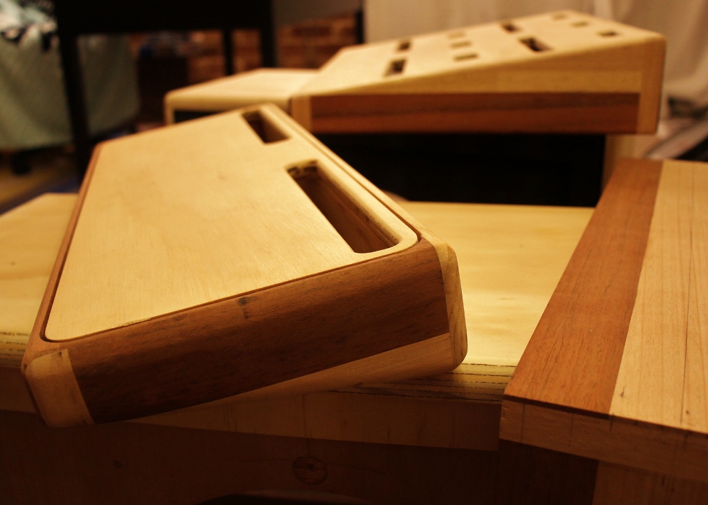

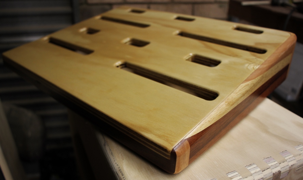

JeffB Posted March 11, 2021 Author Posted March 11, 2021 Playing around with finish. Ive done 2 coats. Ive made mistakes both times. The mistakes were smaller the second time. Maybe I will nail it on the 3rd try. Before. kinda after, 2/3 after. .
Steiner Posted March 11, 2021 Posted March 11, 2021 Very beautiful. There's nothing like hardwoods after finish.
JeffB Posted March 11, 2021 Author Posted March 11, 2021 32 minutes ago, Steiner said: Very beautiful. There's nothing like hardwoods after finish. Thank you. The three different timbers have all come up better than I expected. Im familiar with seeing jarrah finished, flooring, architraves, furniture etc so no surprises there. This started out as a vehicle to practice a few things I had never really done and I didnt put enough thought into it at any stage, probably because I didnt know what I was doing. I kinda regret not mapping things out and taking more care at each stage. I wanted to try laminating, some simple inlays, something to practice finishing on and practice doing dovetails, a little pedal board seemed like a cheap easy way to go. I just jumped in with out a plan. I stuffed up at every stage simply because I didnt have a plan. The thing that really annoys me is that because of a stupid damn quirk in my make up I know I will keep making pedal boards until I make one where it all comes together. Ive got other stuff to get on with and I will be stuck in a stupid loop making pedal boards I dont need. I just plug straight into a clean amp, guitar>lead>amp. What I did learn is I need to upgrade my table saw, make or invest in a good router table, invest in a thicknesser and probably an edger/planer. Oh yeah, and dust extraction. I think I realised that when I was making the speaker cabs but laminating and simple inlays bought it right into focus. I better sell a couple of guitars.

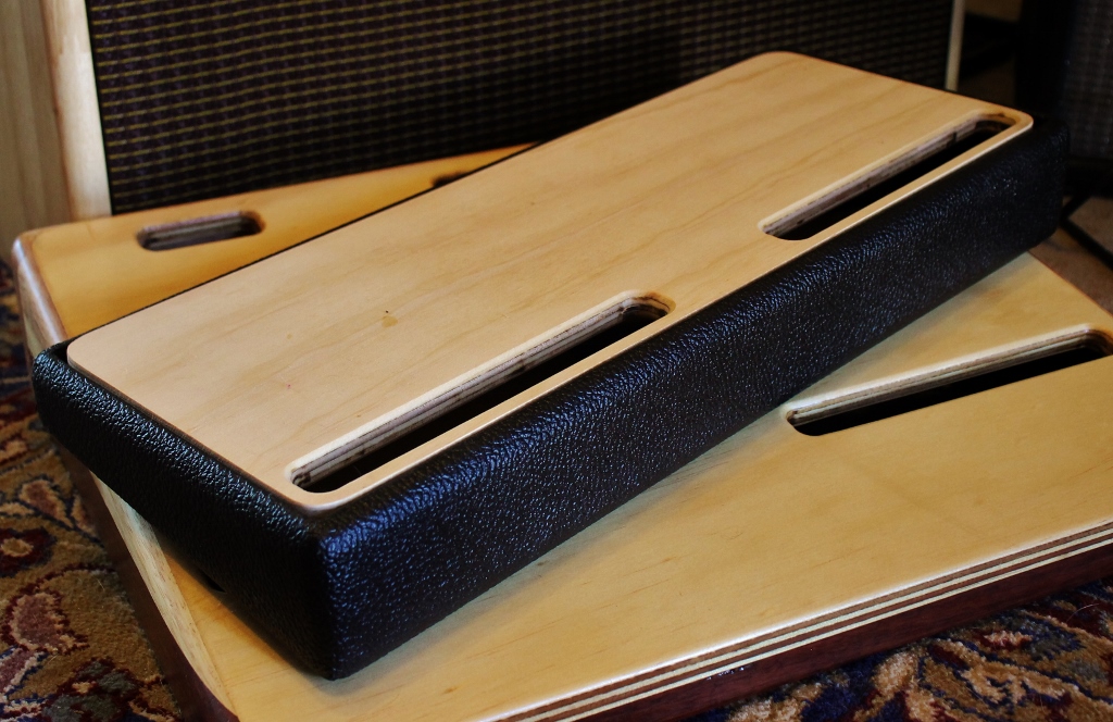

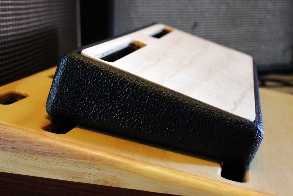

JeffB Posted March 26, 2021 Author Posted March 26, 2021 Had my first crack at applying tolex. The first times quite intense! don't really know what you are doing and the only experience you have is from watching videos.? I made some pretty dumb mistakes and didn't realise until I got to the next stage. not the best corners but the bottom ones get covered and never seen. The top ones I will just live with and follow the correct procedure next time. Front corner in pic shows the most obvious mistake, I forgot to clear the layer of tolex under the miter and its sort of raised up. I went through and squared the corners so I have to make a new square cornered deck. I wasn't happy with the size and position of the slots in the one in the pic so its all good. Im only using a wall wart power supply with this so didnt bother with any in/out jacks or power in connectors.
LK155 Posted March 26, 2021 Posted March 26, 2021 Well, Jeff, you're describing 'most obvious' mistakes that I, for one, cannot see.
TalismanRich Posted March 28, 2021 Posted March 28, 2021 For not knowing what you were doing, you sure did a good job!
JeffB Posted March 30, 2021 Author Posted March 30, 2021 On 3/26/2021 at 8:29 PM, LK155 said: Well, Jeff, you're describing 'most obvious' mistakes that I, for one, cannot see. Yeah, camera angle On 3/27/2021 at 1:03 AM, rockabilly69 said: once again, looks great! Thanks. On 3/29/2021 at 3:29 AM, TalismanRich said: For not knowing what you were doing, you sure did a good job! Im at my best when I dont know what Im doing. Some of my finest moments were where I didnt know what I was doing, and Ive skated through life on the back of them.
