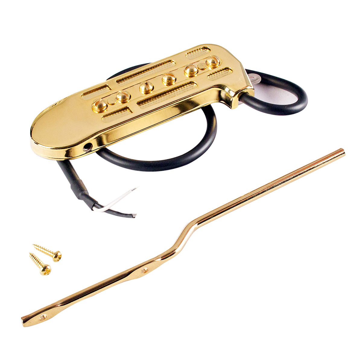

Gitfiddler Posted March 21, 2021 Posted March 21, 2021 Here's a photo of a Heritage floater pickup from my '93 Golden Eagle. It would connect to your Sweet 16 in the same manner. I'm not certain if its a #3, but from what I've heard, they all looked similar inside and outside. If you are considering a replacement, I'd suggest a handwound Kent Armstrong 12 pole paf floater. They are available at www.archtop.com. https://www.archtop.com/ac_access.html Exterior:

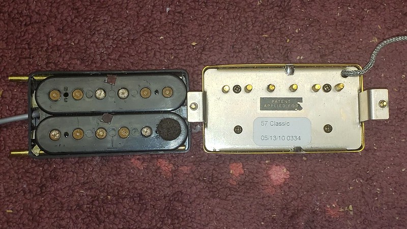

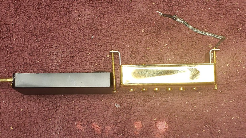

MartyGrass Posted March 21, 2021 Posted March 21, 2021 Here are two videos made by a friend of mine using the Floating #3. One is with an 18" Heritage Johnny Smith and the other with a 17". This pickup creates a more than passable sound. I can't find a single thing wrong with the tones. I've included shots of the #3 next to a Gibbons 57 to compare dimensions. You can appreciate the technical challenges of putting a good pickup together with limited space. The #3 is not potted, at least mine aren't. https://www.youtube.com/watch?v=rIejKgq-i0M https://www.youtube.com/watch?v=y3t4avtjFWc I used to think that #3 were second class pickups. I've tried many in the last decade and have changed my mind. I had a BJB, some Kent Armstrongs, a Benedetto, a Gibbons Bill Lawrence, and some from the guy who now builds Heritage floaters. They all are a bit different, that's all.
