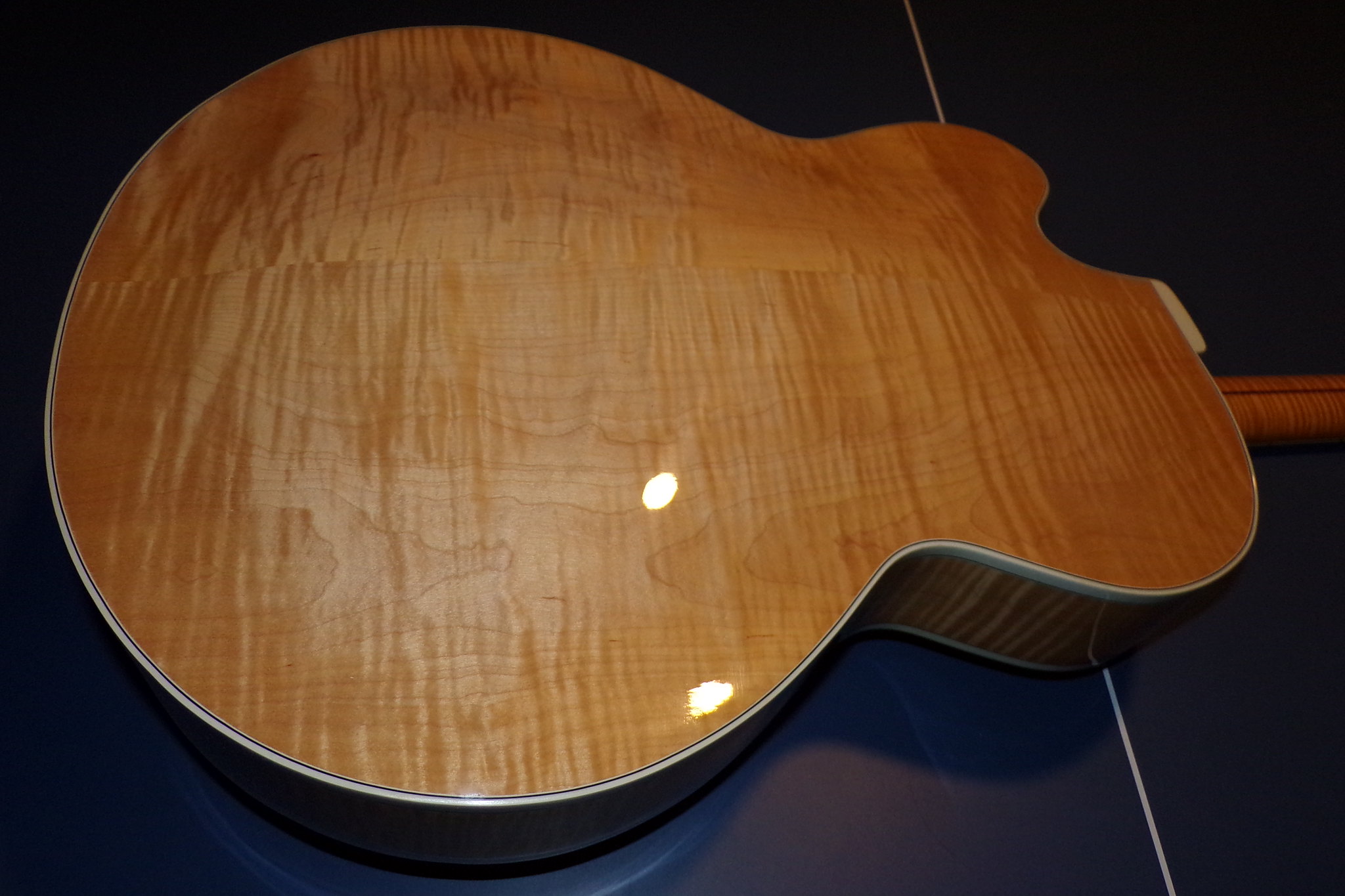

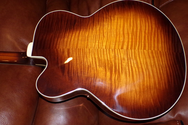

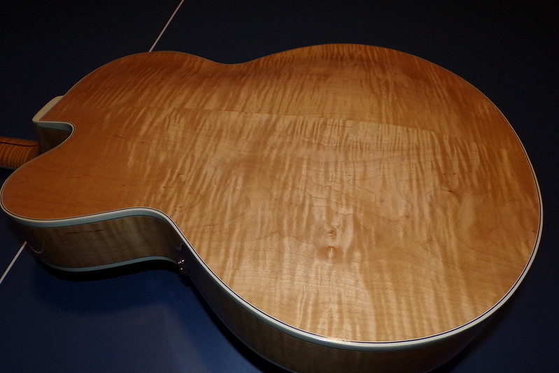

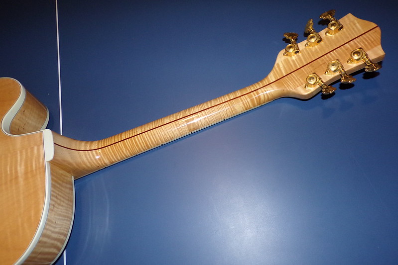

I can post a few preliminary pics.  You can spot the Heritage in them.

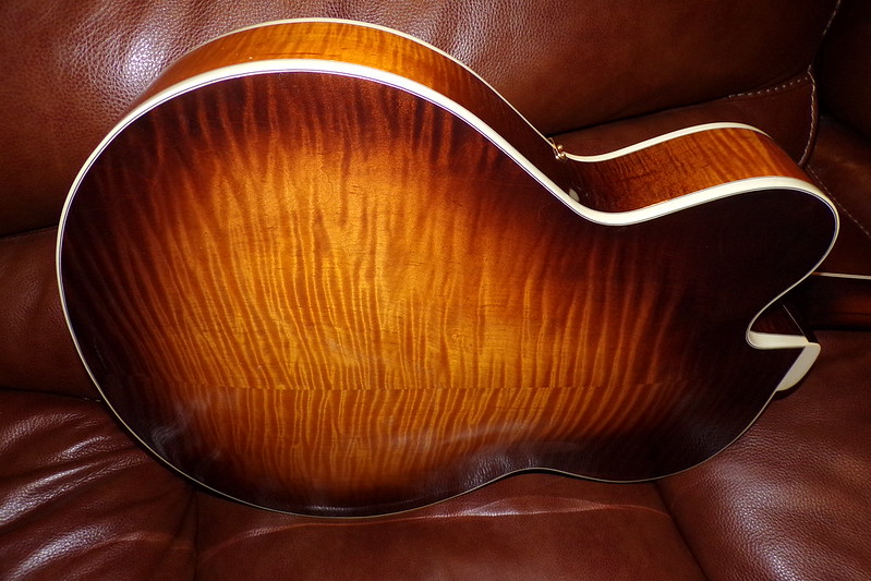

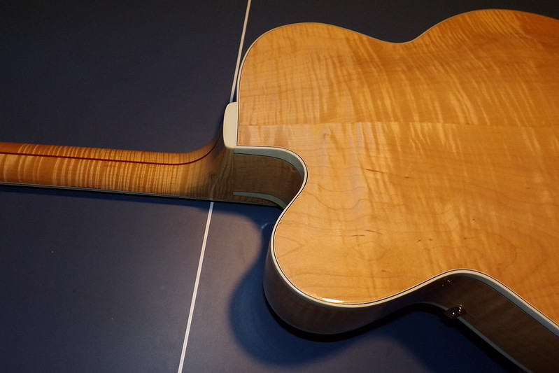

I’m loving their backsides! (    )

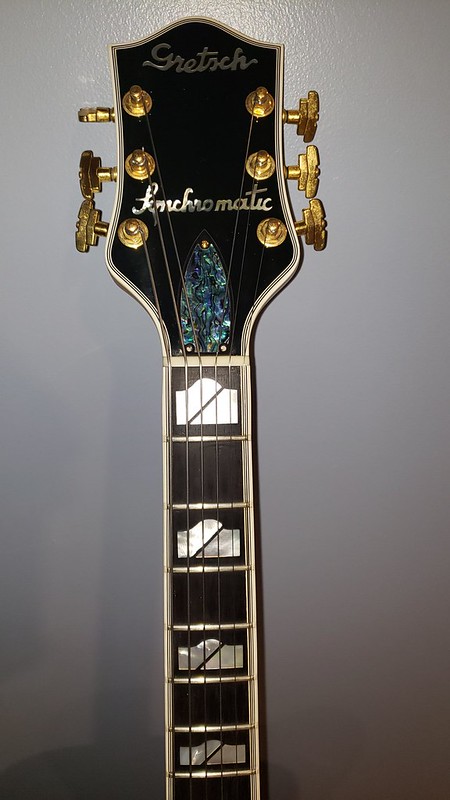

All I can see is Heritage.  Why don't you share the front of the guitar and headstock with us?

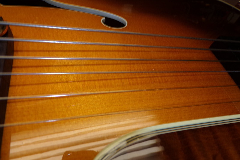

I only got the backs done and parts of the tops.  I'll post some dirty pics then.  You can see the build up on the finish for 25 or more years of storage.  Some strings were broken on two from corrosion.  I didn't want to restring them until they were cleaned.  There will be more pics when I can finish.

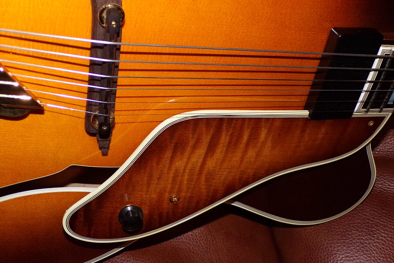

Pulled off all of the hardware.  That was the only way to clean by the tailpiece and around the tuners.
The truss rod nut looks new.  I took it off and put grease on the threads.  The bracing looks secure.  The frets are polished now.
The finish cleaned up nicely.
I'll Pete Moreno buff it out and I'll put the hardware back on.
You can start to see some depth in the maple.

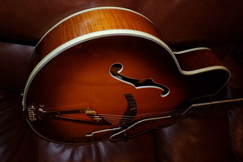

A blonde and a burst went to Pete Moreno today to buff.  One may need another layer of clear coat on the top but he thinks buffing with suffice.

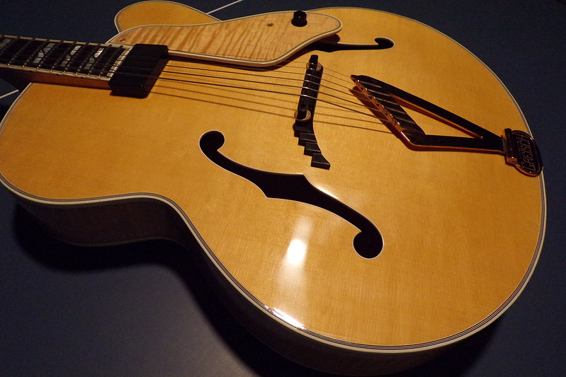

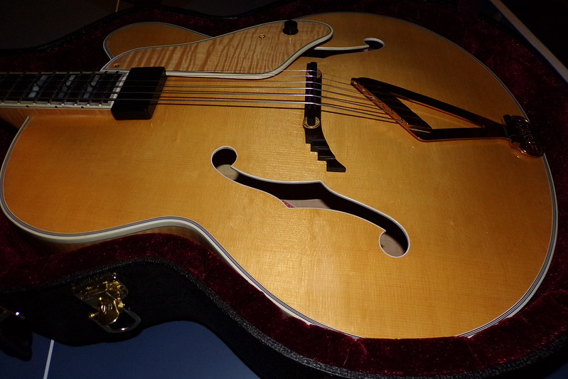

I cleaned the other blonde up tonight.  I have plenty of pics.  The bracing looks good.  The wood has good figuring.  There is some bear claw and a lot of silking in the spruce.
The 20th fret on the high E area needs either a little filing or a gentle tap.
This one was ready to have the hardware put back on.  I don't think it needs buffing.
I chose some heavier strings to drive the top better since it is an acoustic.  I used D'Addario Half Rounds 13-56s.  I run the wrapped strings through fine steel wool a few times to smooth them out a little.
The guitar is loud unplugged and has a good bottom end.  It won't compete with a J200 but it doesn't want to anyway.  The pickup is the Heritage Floating #3.  That sounds just right.  All's well.

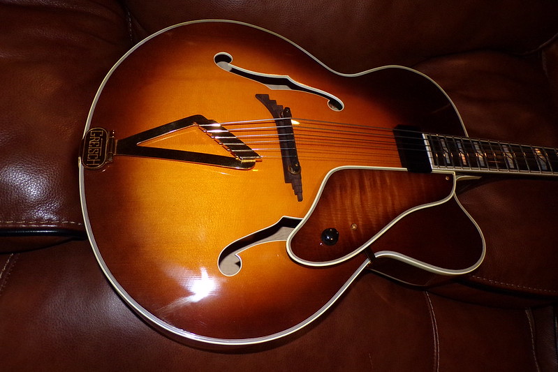

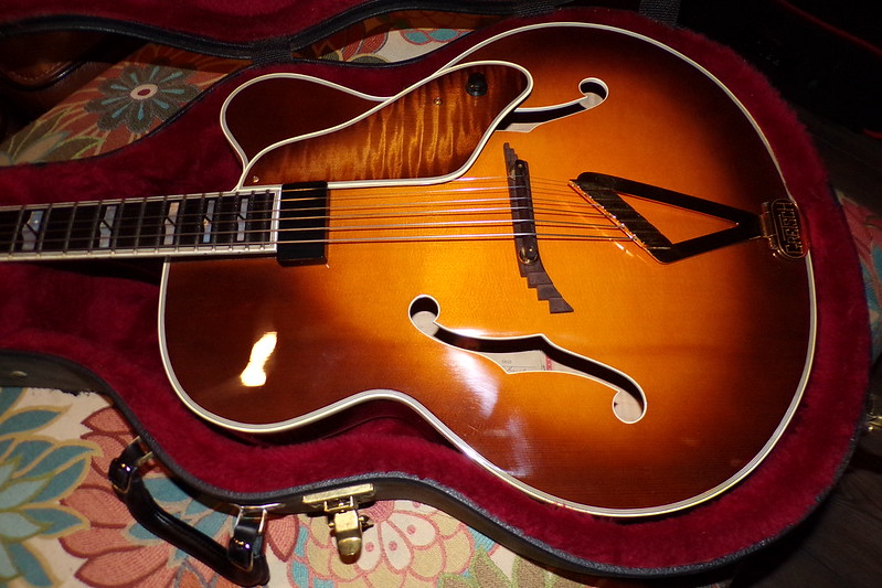

Today I have two of the three Heritage built Gretsch Eldorado guitars done.  They cleaned up well.  The play nicely and sound good, too.  But I'll show you how these two look after Pete Moreno buffed them out.  The wood figuring is excellent, as we'd expect from the boys.
Here's the 1992:
There's one more to go.  That one needs part of the 19th fret filed.
