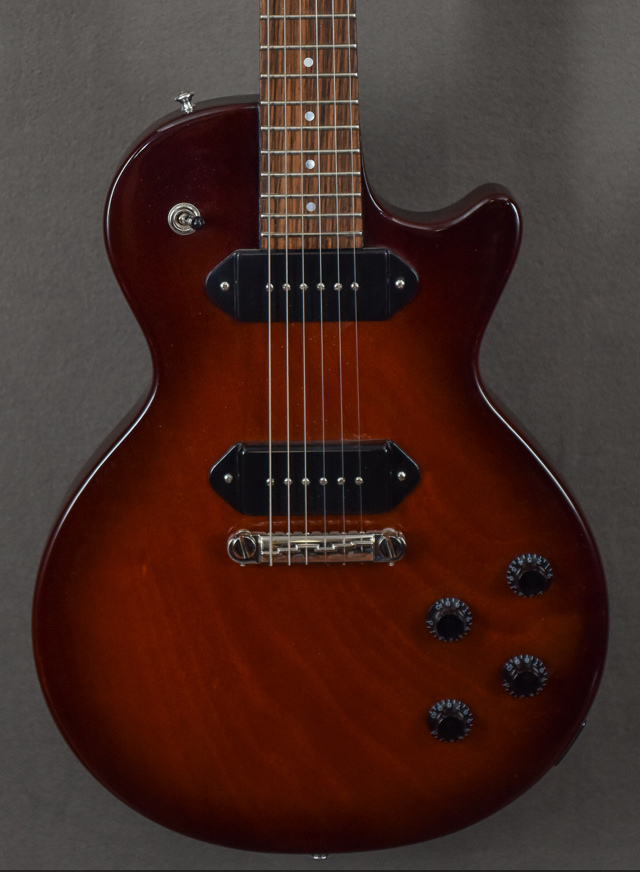

So I just bought a used H-137 in old school burst from Daves guitars.  Should be here next week.  Looking forward to joining the club with my ‘17.

Guitar arrives safe and sound.   It’s really beautiful and has a great sound and feel.  I’m having some difficulties adjusting the intonation with the compensated bridge.   I may have to get an into stable wraparound, I play some jazzier chords and they sound a little off at different places on the neck.  The guitar sounds great and plays so smooth, once I get the intonation issue solved it is likely going to be my #1.
Great looking guitar!  Get yourself a badass style bridge to solve your intonation problem. Stewmac sells many different brands of fully adjustable wrap around bridges. Congrats on your purchase!

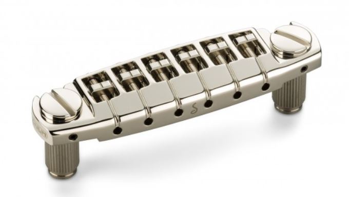

If you are considering a bridge upgrade, check out the API Locking Wrap-Around model.  That was used on the HOC Ltd. Ed. H-137 and it works great.
Another excellent bridge is Faber 'Wrap Lock' bridge.
That looks like the lightning bolt bridge that came on mine.
can you get good intonation with that?   I need to spend a little time working with mine.  I used to have CS LP special with a regular non compensated wraparound that surprisingly didn’t have any intonation issues.  I’m hoping an hour with the adjustment screws gets me where I need to be before I go the adjustable route.   Great looking guitar by the way!

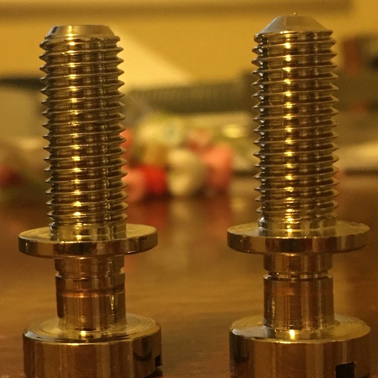

So I do love the guitar and base tone but it looks like she’s gonna need some TLC.  I decided to see if I could adjust the intonation with the lightning bolt bridge a little better.  Upon trying it was clear that the adjustment hole on the treble side grub screw is worn out as the Allen head that easily turned the bass screw just rolled around the treble side…no wonder the guitar was not properly intonated. Once I discovered this I realized I am probably going to have to get a new bridge anyway,so I removed the strings so i could take some measurements.  Well the high e string was stuck in a very tight nut slot, odd for a guitar that was advertised as having a full set up before shipping, on top of the already poor intonation.  Next I removed the bridge posts to determine the center to center spacing of the current bushings and discovered that I have two different studs on this guitar, one rounded top and one with a flatter top. The flat top one goes in and out of both existing bushings very fluidly, while the rounded top one is very rough going and almost feels that it is incorrectly threaded or has excess plating.      So it’s looking like new studs as well.  Luckily I was able to play and bond with this lovely guitar and don’t mind getting a new bridge and dropping it off with my local tech for a full set up and to get it dialed in just right.    A bit frustrating that the money saved on a great deal will likely come close to the cost of a new guitar when all the work and parts are factored in.  If I couldn’t see the potential in this guitar I would probably be pretty upset, good thing it is going to become a monster!

Static111, if you hold the bolts facing each other & mesh the threads, are there any gaps? Should tell you if they're different or not
1 hour ago, bolero said:
Those look like Pigtail bridges
They seem to line up together fine. I think the rounded top one has excess plating and didn’t get cleaned up with a die.   I’m trying to figure out if they are SAE or metric so I can order the proper locking studs for the replacement bridge.  After further examination it appears that all previous adjustments had been made while under tension as one of the studs has an additional groove worn in.   I was able to move the worn out grub screw from the treble side and it also appears to have been cross threaded.   I also found that based on the tooling marks on the back of the bridge it is actually a mojoaxe 60s style, so probably not even oem. Now to decide on sticking with mojo axe or going with adjustable for more precise intonation.  Leaning towards adjustable.
