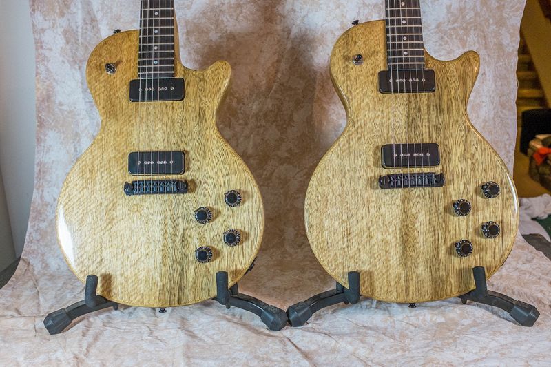

bolero Posted July 26, 2021 Posted July 26, 2021 LOL Will!! that pair of Korina 137's are outstanding! the crossfiguring/flame is unreal
