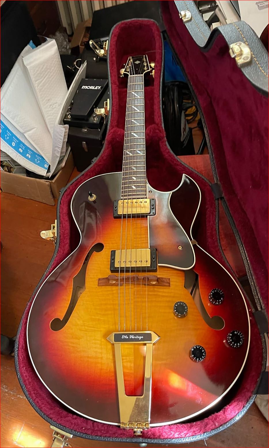

Plentine Posted July 14, 2021 Posted July 14, 2021 I have a 1995 H-575 and will be replacing the old pickups with HRW's. I'm thinking of changing to new push/pull pots to split the coils while I am at it. Will this require a whole new electrical harness to go with the new pots? Anyone done this? Good idea? Bad idea? Any advice would be greatly appreciated. Thanks in advance. Pete
PunkKitty Posted July 14, 2021 Posted July 14, 2021 You will need to pull the existing harness and install push/pull caps. I would replace the full harness. You will need a Les Paul short shaft harness with 500k pots. Here are some options: https://www.stewmac.com/kits-and-projects/electronic-kits/wiring-kits/golden-age-pre-wired-harness-for-Gibbons-les-paul-with-push-pull-pots.html?utm_source=google&utm_medium=shopping&utm_campaign=2021-07-gp&gclid=CjwKCAjwlrqHBhByEiwAnLmYUAor4Vet7ec5pk9zfthl-8G4aB7XyqfFF6PBbP9SrKD9DMIMx8kIhhoCWi0QAvD_BwE https://emersoncustom.com/products/copy-of-les-paul-prewired-kit?variant=13952525664323 https://www.jonesyblues.com/store/pv_1143165_827339/lp-pro-dual-coil-split-harness https://www.jonesyblues.com/store/p_1490043/msp-les-paul-wiring-harness-and-switch- It's not difficult if you know how to solder. But putting the harness in place through the F holes can be difficult. This is a tool that I made to help install new harnesses in hollow and semi hollow guitars. It's just a cheap guitar cable with a molded plug that I trimmed to fit through the jack hole at the end of the guitar. Install it in the old jack before you pull the harness, unscrew the nuts holding the jack in place, and use it to fish the harness out through one of the humbucker routs. I prefer using a 3 or 6 foot molded cable and trimming both ends of it. The little wire sticking out of the F hole is the bridge ground. Attach it to the back of one of the pots. FWIW, this is the F-535 that the HRW's I sold you were pulled from. Hope this helps.
