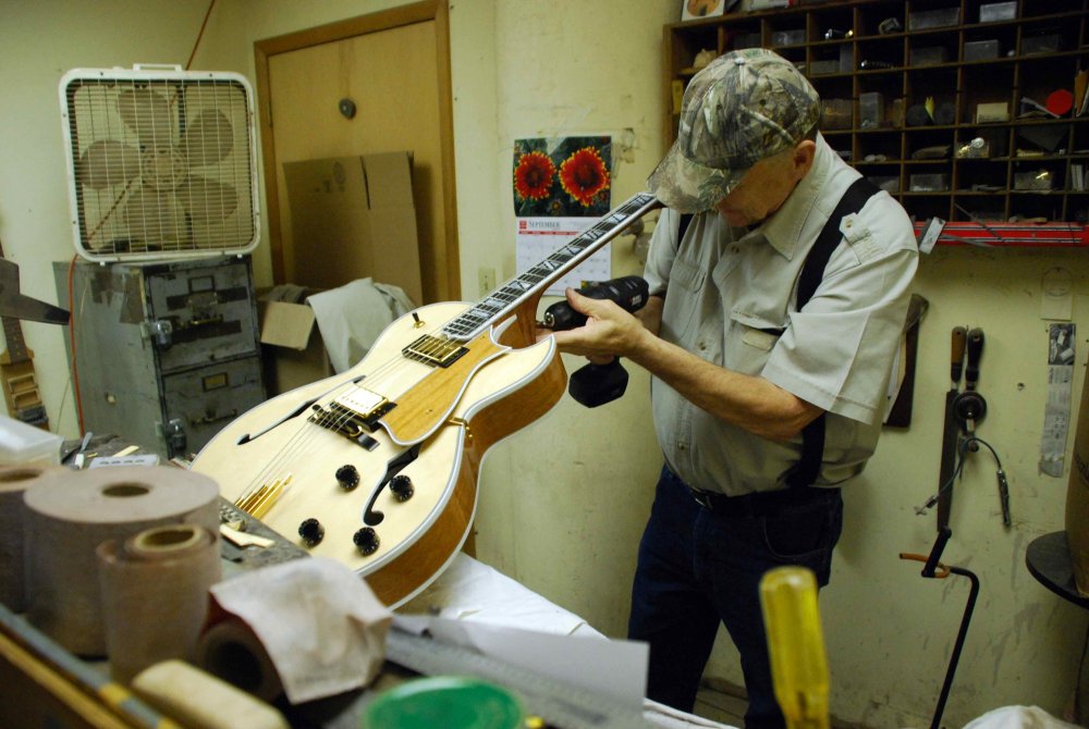

Steiner Posted July 16, 2021 Posted July 16, 2021 Welcome Sim. Not only are 575s proper, they're made of solid wood; not plywood. Don't fret too much about drilling. When I picked up my 575, Ren asked if I wanted one installed. Sure! He dropped the guitar on his bench (right there by the Plek/coatrack), threw the headstock on his shoulder and drilled the pilot hole... It works well!
